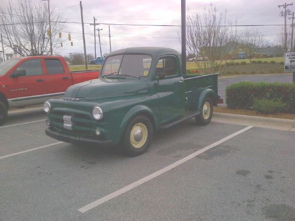

  28. Took a ride over to Rock's house and check vac readings...seems to be ok. We think it could just need some carb tuning, so that will be next.
    Stopped off for lunch and gas on the way home, so i think I'm going to classify it as roadworthy for now.
  29. Just noticed the other suggestions. We used carb cleaner and sprayed it on the gaskets near 7 and no change. I thought about having some gaskets made out of soft copper to get a more reliable seal.
