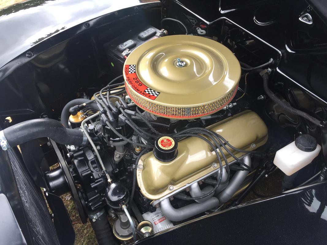

  22. RmK57
    Joined: Dec 31, 2008
    Posts: 2,689
    RmK57
    Man that looks slick! Like it was made for it.
  23. MeanGene427
    Joined: Dec 15, 2010
    Posts: 2,307
    MeanGene427
    from Napa
    Yep, with the early 60's trim and colors, looks like it came that way- sweet and not boring lol

  24. What I really like about that install is not only is it neat as a pin but they did not cut the firewall and it uses a mechanical fan. Doesn't get much better than that in my book.
