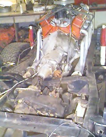

  28. 307's are a good motor with a little wake-up.
    I ran a stock bottom end 307 that I pulled from a 1969 Chevy Van with who knows how many miles. Installed some 64cc 1:94 heads, 286 cam, single plane intake, Holley 650dp carb, headers and stuck it in a 1980 Chevy Luv 4X4 pickup for playing in the mud.
    It was hooked to a T-350, Dana 20 transfer case, Dana 44 rear axle, 30 front axle. 4:10 gears and 32" tires. Sold it after breaking the transfer case in a 2nd gear WOT upshift. Lost interest and started building a beefier truck.
    That little truck hauled ass.
