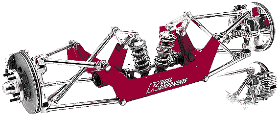

    Yes, Carroll Smiths- Tune to Win and Engineer to Win- will give you the calcs for inboard ifs geometry. Always available on E-Bay for about 20 bucks and the big book stores often have them or can order them.
    Kugel Komponents has just what you need for a mere 4.5 large

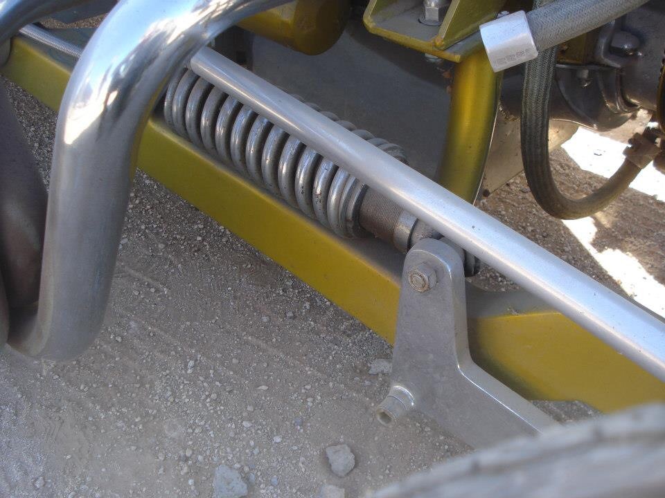

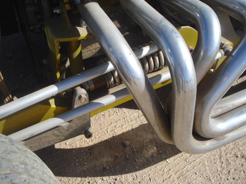

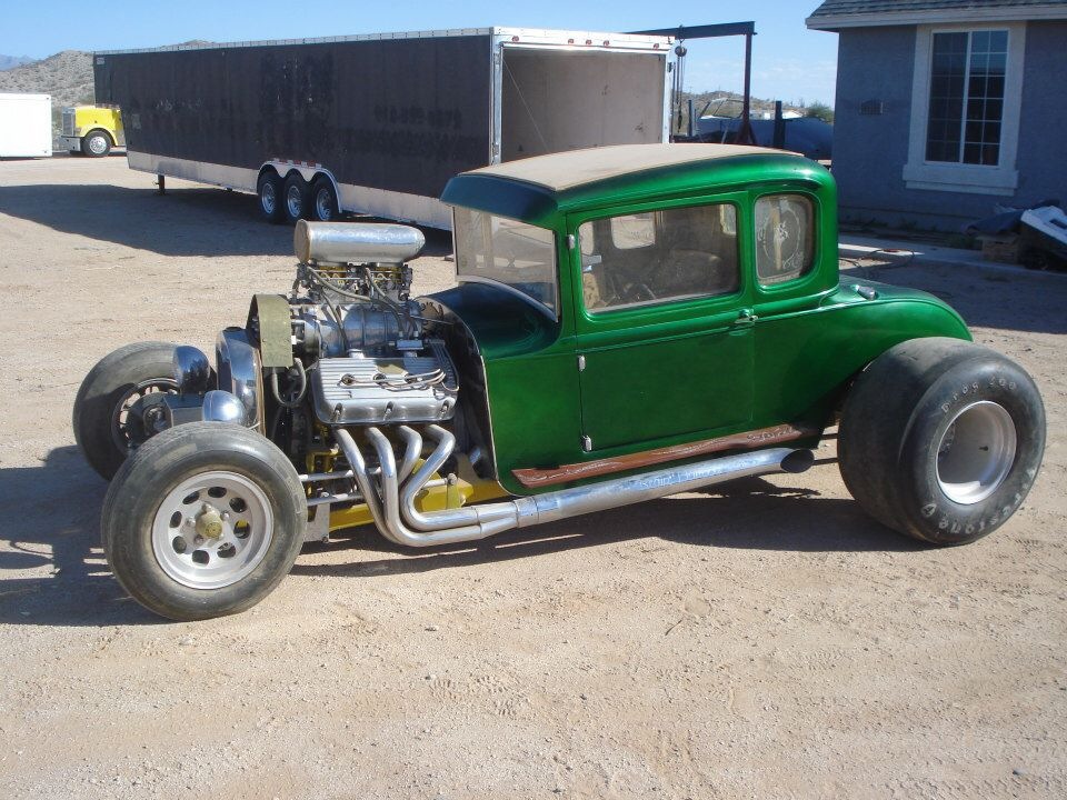

    image.jpg "Brain Damage" built by Joe Sulpy III or better known as Sr. Cantilever horizontal coil over front suspension. Designed and built in the mid 70's
