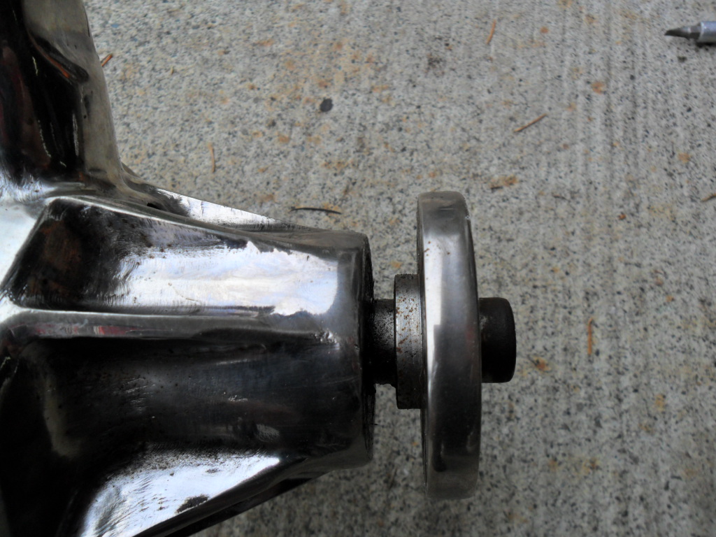

    Hey guys so I have a SBC 350 and my water pump pulley and crank pulley are not aligning. I have a short water pump and I just got some new short water pump pulleys from speed way. I don’t know what is going on but my Crank pulley is sitting in 3/8th of an inch too far. I know I can get shims to help align but 3/8ths of an inch seems like a lot to me? I have looked at a bunch of threads that has talked about the pulleys not aligning and people were saying you can shim them, and to make sure you have the right pulleys. Well I am pretty sure I do have the right pulleys so I do not understand why I have a 3/8ths gap? Should I just shim them?
    Thanks in advance.

    Been down that road before and it's kinda frustrating. I ended up having my water pump pulley flange pressed down onto the body a bit by a guy up at the local NAPA instead of shims other pulley. I had to file the pump body a tad for clearance, but all is well now.

  6. the flange on the water pump shaft is not on far enough , when it's correct the pulley will almost touch it. when you press it , take off the rear cover and press against the shaft

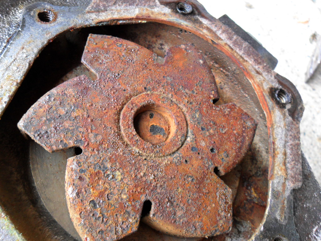

    Looks like the shaft could slide through some more. Looks like the impeller is about half way on?

    Now, if you try to press the hub on more, you do not want to move the impeller! You get a small socket to fit into the impeller bore to touch the SHAFT, so you are pressing the fan hub onto the shaft. Measure how much room you have before the hub hits the waterpump, it does not look like it can go 3/8 to me.

    I would mount the alternator or generator, whichever you are going to run, check alignment, see if its the waterpump pulley or the lower pulley. My 34 had a rebuilt short pump on it when I hit the deer. Bought another, same problem, I didn't change the lower pulley so I knew it was the waterpump. Took it apart, put it in my press, moved the flange, works fine. I was a line mechanic @ a Chevy dealership in the late '60s, had to do this to a new GM waterpump.
    I had a Speedway chrome waterpump pulley on the 34, had to replace it, used a stock factory pulley. Measured both, depth on the chrome one was same as the stock one so I doubt it's your waterpump pulley but who knows.

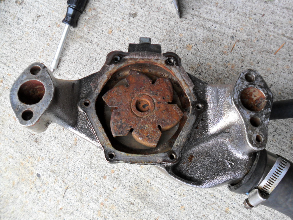

    Not sure what that pump is off of, does'nt look like mine,must be a later model Corvette.

    Corvette pump and pulleys are closer to the block than the standard car p/u short pump..
    Happens all the time when you use parts from different sources ( Isin't that what we ALL do on here ? )
    Do not try and move the hub on the pump. They loose their press fit every time you move it on the shaft...Been there and done that,,,bought the new radiator to prove it ! LOL !
    Best thing to do is make a spacer for the lower pulley..

  21. after looking at the latest pictures you posted , that does not look like any SBC short water pump i've seen.....what is it?

    I got it from a guy off craigslist, and I was told it was a sbc short water pump. I put it on and from what I could tell it was a short water pump and it bolted right up.

    So just found this web site http://www.marchperf.com/pg8.html that shows a measurement of the mounting surface for the pulley and the back of the water pump to be 5.625", I went and measured mine and it was 5.925". So this would make sense why my pulleys do not line up.
    Looks like I may have to either get the flange pushed on further or look for a new water pump on craigslist.
