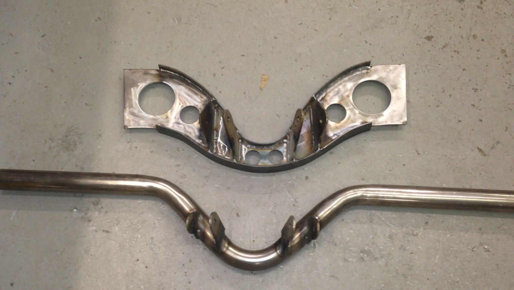

    Thanks. It's no different than if the frame itself had an inward jog at that location. Other than a bunch of extra stress points where the angled mount would attach.

    Now as long as people keep asking about my particular set up, or what im working on and what I want to know for or why I'm asking, then we keep going there. Since this a traditional forum we should stick to traditional chassis design.
    The one I've been staring at recently is a 33/34 slightly modified. Pinched at front cross member for an A front member. widened at B pillars and the rear is stepped in with the rear tails raked up 2" at the rear crossmember. The 40 rear crossmember I got from you was narrowed and flattened slightly so the 40 front spring gives the ride height with the spring hangers I made.
    So what I'm really working on is my own edification
    Attempting to be a student and find a teacher by drawing from the great knowledge base located within the Hamb. Then when I know a more than I did before ill apply what i learned to my vehicles.
