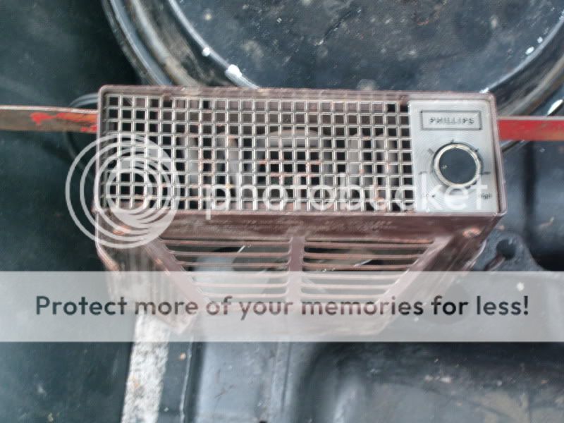

    Also, I found the 'heater'! :D Might polish up the front panel, and paint the rest of it to match the car. I think that would look pretty slick!
