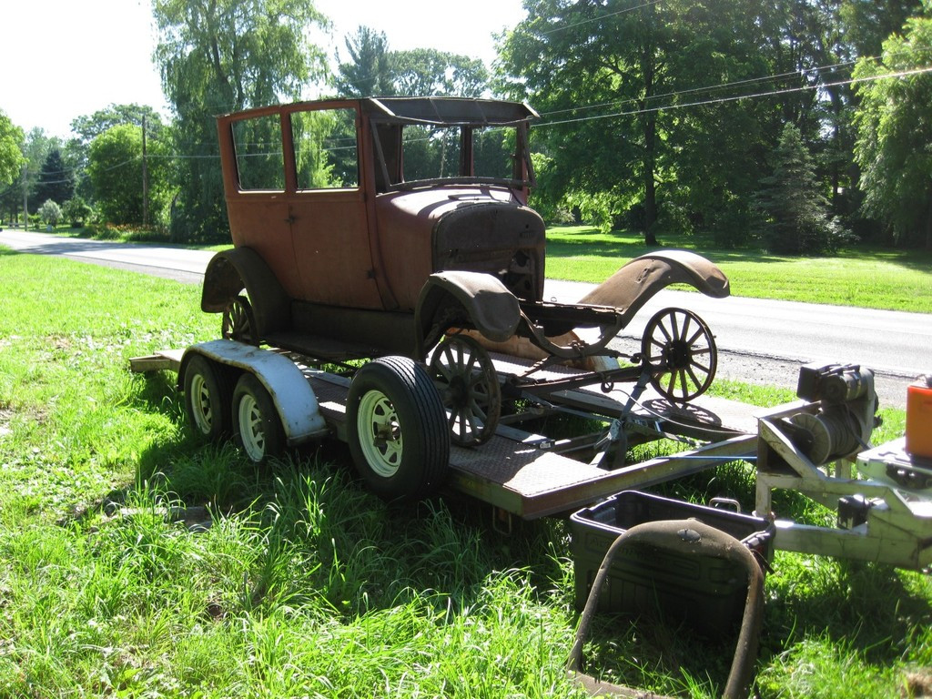

    Then I needed to decide on a car… I knew I wanted a 2 door Sedan since I could only take one person with me in the big trucks and with this project I wanted to be able to take my wife, 8 year old son and 4 year old daughter. So a back seat was a necessity!!! So I decided on a 26/27 Model T 2 door sedan and began looking for a project car. It didn’t take too long and I found a ’26 sedan in Oneita NY on ebay. This was back in 2009, so I won the bid and headed north to pick it up. The owner literally had thousands of T and A parts laying around and decided to thin out a bit. Years ago be bought the sedan, paid a guy to primer it and then pushed it in a barn. I think it spent 20 years or so???
    They had it pushed outside and this is how we found it…
    And it no time we loaded it up and headed home…

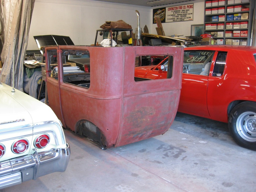

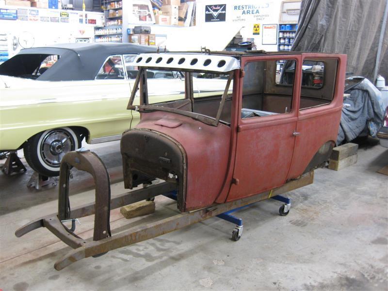

    We rolled the car into the garage and then decided to remove the body from the frame… My Dad picked up a used forklift from CF years back and with the help of some 2x6 box steel we made two 8’ extensions for the forks and lifted the body off of the frame…
    I have a good friend that collects and restores antiques who also has a 26 sedan that he plans to restore someday, so I offered him the frame since I knew it would go to a good home. Before he took the frame I was able to find the serial number stamped on it and determined it was in fact a 1926 model. So I set the body on a dolly and wheeled the body out of the way for the time being…
    Then a friend at work mentioned his cousin in CT has an aftermarket model A frame he wanted to get rid of so I wound up buying that as well. I’m not sure who made it but I did find a post on here where someone had one very similar and said it was a Spirit Industries frame??? Regard less it’s a good start so to help save some room in the garage I set it on the dolly and then set the body on the frame and C clamped a model A grill and headlights to it…
    I needed to make some more room in the garage so I built a shelf out of some 2x6’s and set the entire car on it. I actually sent of pic of the garage to Car Craft and wound up making “This Guy’s Garage” in their January 2011 issue… Here is a link to their article…

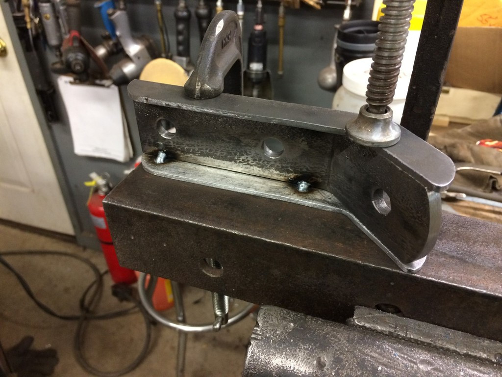

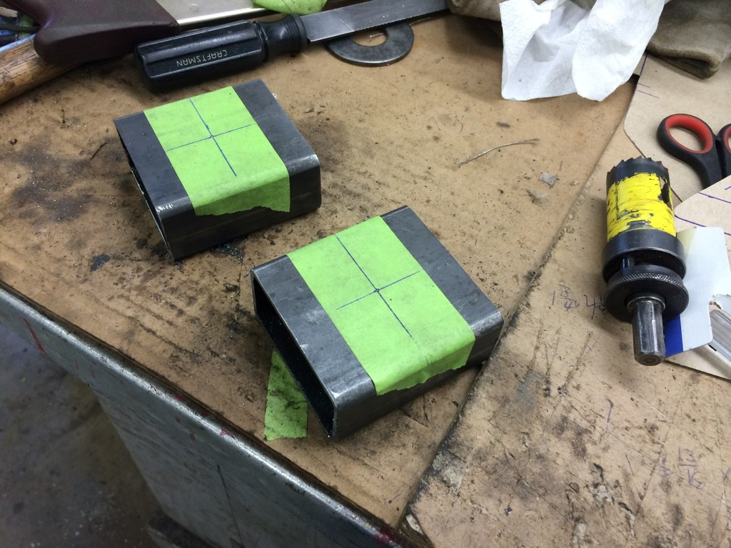

    Now that the motor was set I figured I would work on the motor mounts and decided to use the Boling Brothers 28 A pickup for reference. I started with some pieces of 2” x 1/4" flat stock and used my buddies press brake to bend them to the correct angle…
    After they were bent I drilled the mounting holes…
    And then made a cardboard pattern for the side gussets… (more on those later…)
    For the frame motor mounts, I used Vern T.’s book for reference and used some 3” x 1 1/2" box tubing I had…
    And then shaped the mounts…
    When they were done I set everything in place along with a set of mounts from Chassis Engineering Inc…
    More to follow later…

    Over the weekend I finished up the motor mounts. I wanted to make side gusset plates for both sides of the 1/4" 2” flat stock so I tacked two pieces of 1/8” x 2” flat stock together, traced my patterns out, and started cutting…
    After some time I wound up with these…
    And then I tacked them into place…
    Once I was happy that everything would work I welded both mounts…
    And then bolted them back on the motor…
    More to follow…

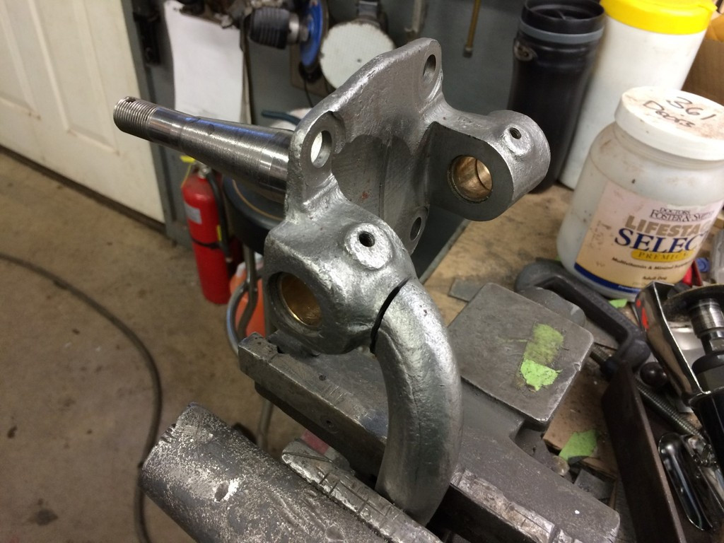

    Now that the motor mounts were done I wanted to move back to the front end. To finish the spindles, I had to cut the factory steering arm off of them…
    And here is the pair of them done and ready to go…

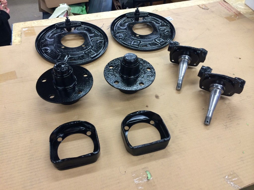

    Then I decided to sandblast the backing plates and hubs. So I pressed out all of the old studs (which the threads were really tired…) and put everything into my homemade booth…
    And after a few coats of paint they were ready to go…
