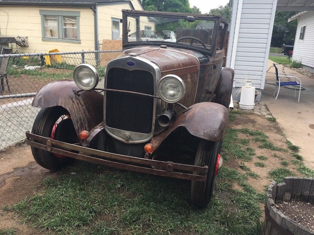

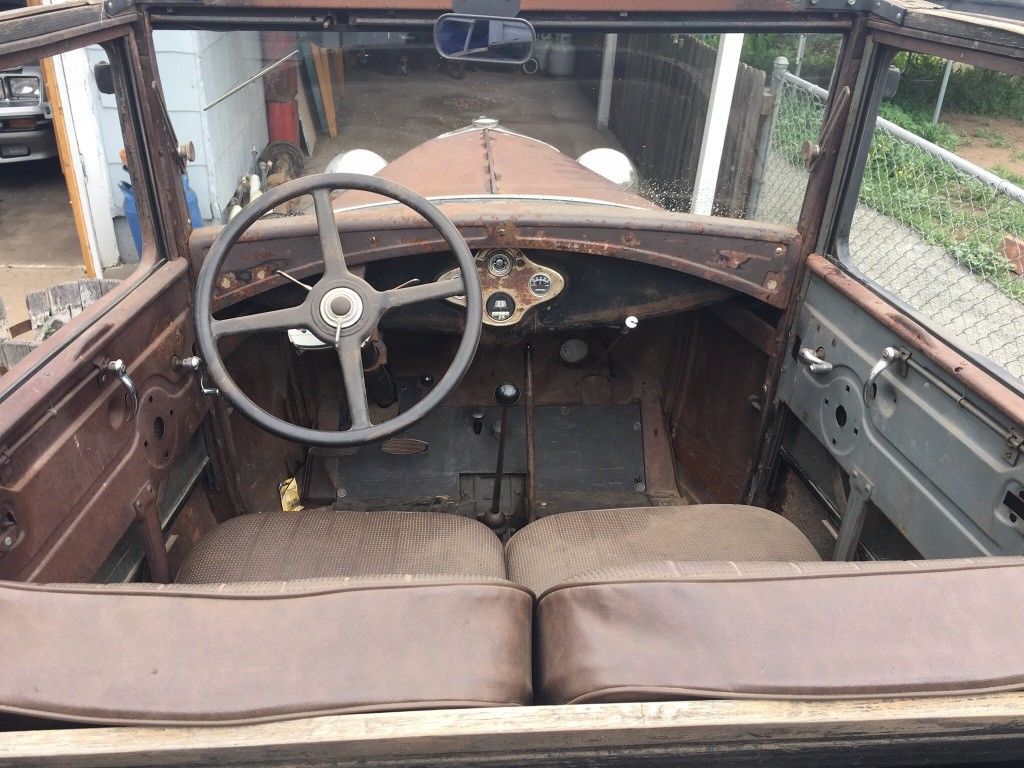

    I purchased this 1930 sport coupe about two months ago with the intentions of building a fenderless "pre-war" TROG worthy hot rod.
    The backstory:
    I bought this car from the 2nd owner who purchased it from the original owner's estate. The second owner only owned it for about a year before he was forced to sell it due to medical reasons.
    The original owner began restoring this car prior to passing away. He welded in patch panels all along the bottom side, replaced the floor pans, rebuilt the original banger motor (which currently has less than 50 miles), installed juice brakes, replaced the seats, and replaced the radiator.
    The second owner kept the car sitting on the side of his house for the majority of the time that he owned it. Other than having the wheels powder coated and installing new tires, he left the car untouched.
    Build plans:
    My plan is to tear the car apart to paint the frame, motor and drive line. I also want to chop the top 3" and lower the front and rear axles to improve the handling and stance of the car. I am going to leave the exterior alone because I love the patina'ed paint job, but I do plan on sprucing up the interior. Ideally I would like to make a convertible top, but I am still playing around with ideas.
    My goal is to have it ready by this years hill climb.
    Attached are pictures from the eBay auction: Interior.jpg P-Side Rear.jpg D-Side.jpg D-Side.jpg Engine.jpg Front.jpg

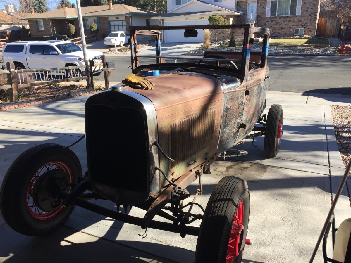

    Chopping the top 3"

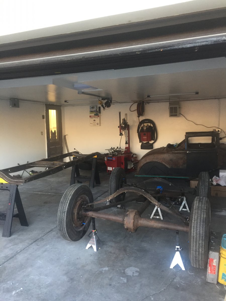

    I spent two long days working on my car this weekend and made quite a bit of progress.
    I was able to strip the car down to just the frame and was shocked that I didn't come across any "surprises". The more I tore the car apart, the more I became impressed with the original owners work. He clearly took his time when installing the patch panels, floor pans, juice brakes and wiring. It doesn't appear that he cut any corners.
    While contractors were working on my house I was working on my car.... First step, remove the body.
    Now to remove the engine...
    Engine has been removed and it was time to call it a night.

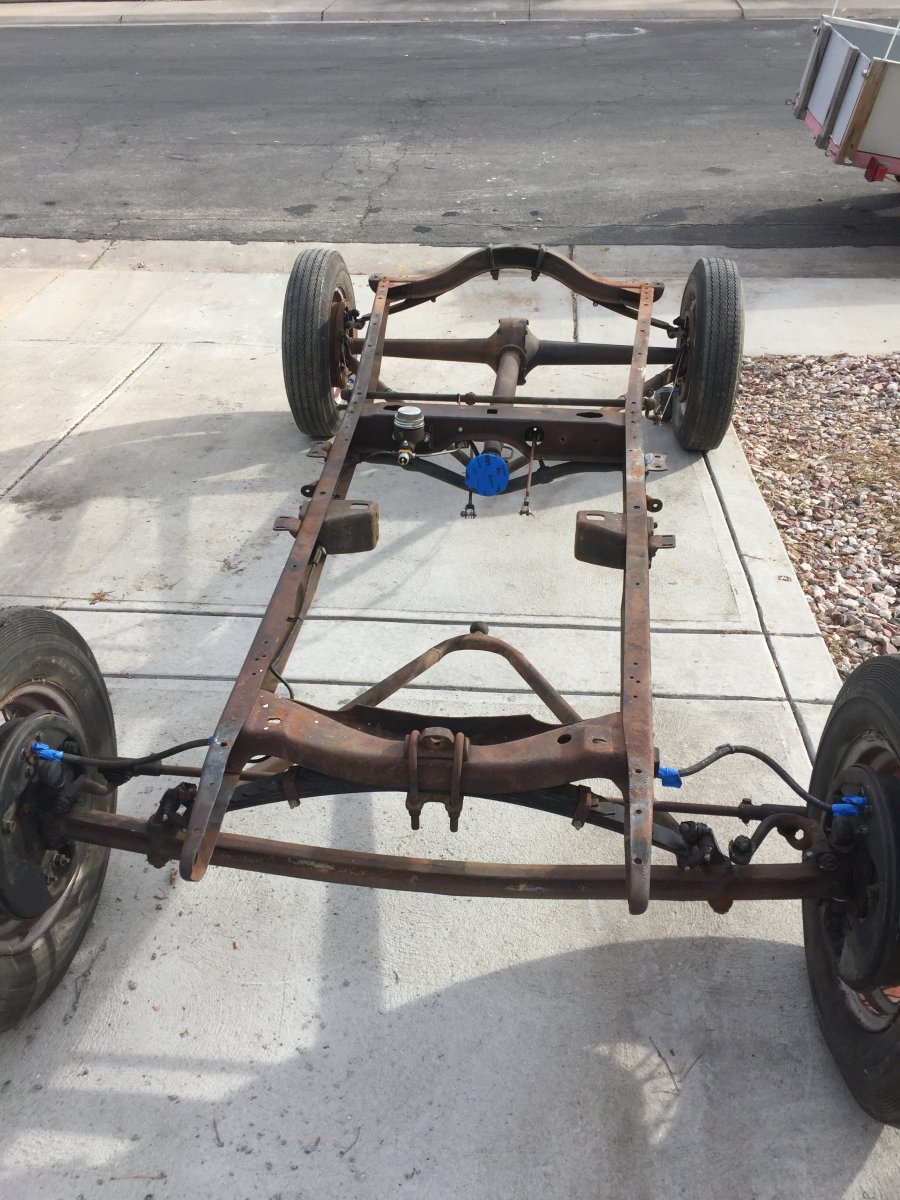

    Structurally the frame is in great shape. The right front frame horn has had some very very minor repairs, but that was the only damage that I could find. The surface rust was minimal and there were no signs of deep pitting.
    I spent the majority of my time sand blasting/wiring brushing the dirt and surface rust off of the frame.
    Finally, the frame has been removed. I think that I will take it to a professional sand blaster to have them get in the areas my portable blaster wouldn't reach. I want to make sure that the frame is squeaky clean before I paint it with POR15.
    Packed in and ready to call it quits for the weekend.

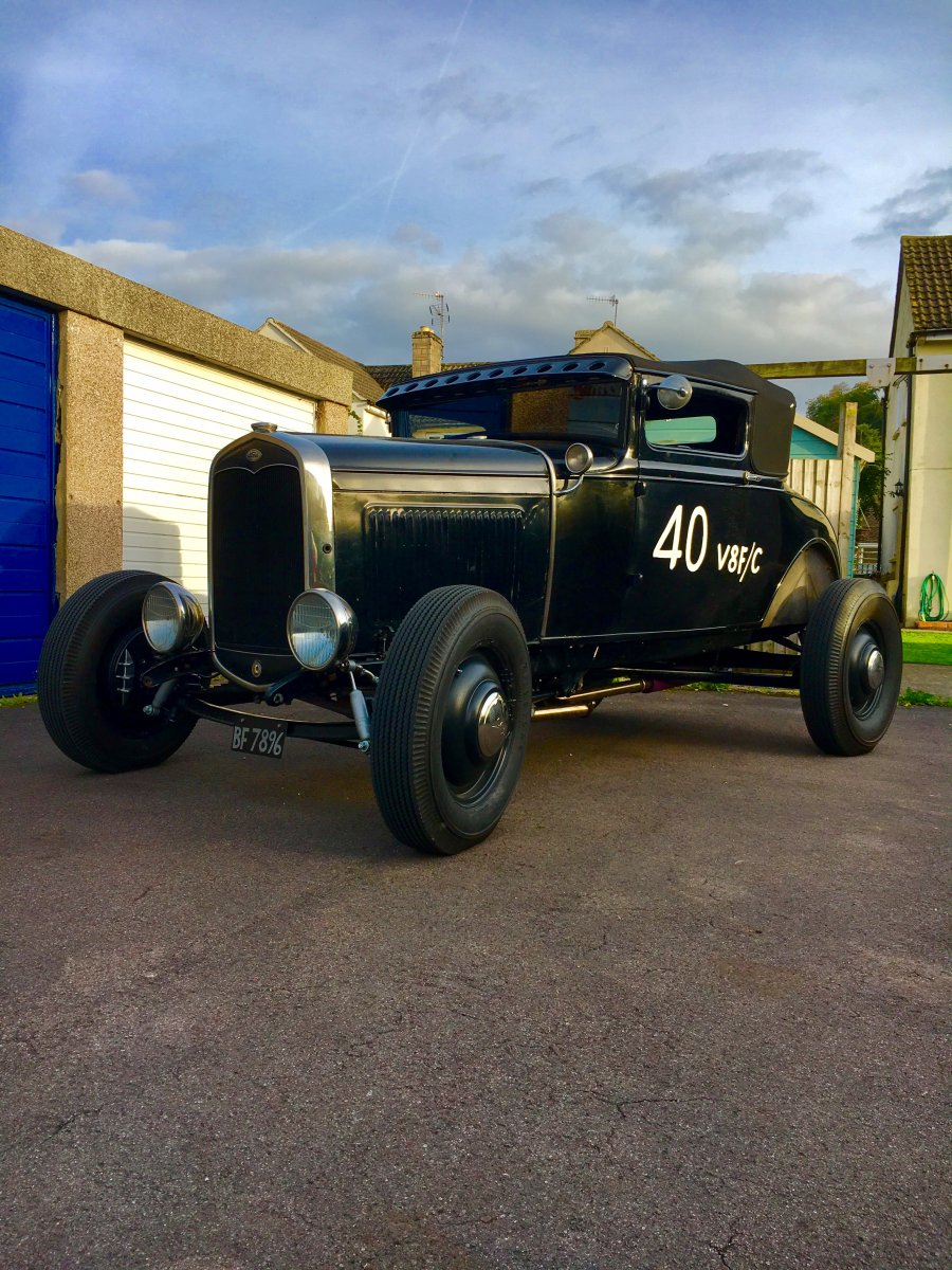

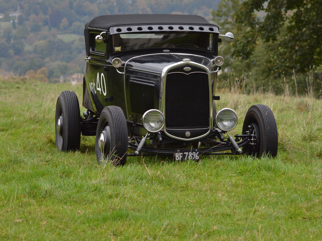

    Gotta love a sport coupe. I built this one this time last year. I too was thinking of a fold down roof but ran out of time to think about it, but now I’m really pleased I went with the original style fixed roof.
    6F7F92BD-4BBD-431D-85CD-27A9328F35F4.jpeg 031E72C2-17F0-42E0-9FDF-1FD91170C267.png A7C76E3C-5B23-4395-819B-5B2D8045E48B.jpeg D3EBAEE1-B431-4FD2-A1D7-FA4385C160FA.jpeg
    brEad, 51box, Nailhead A-V8 and 14 others like this.

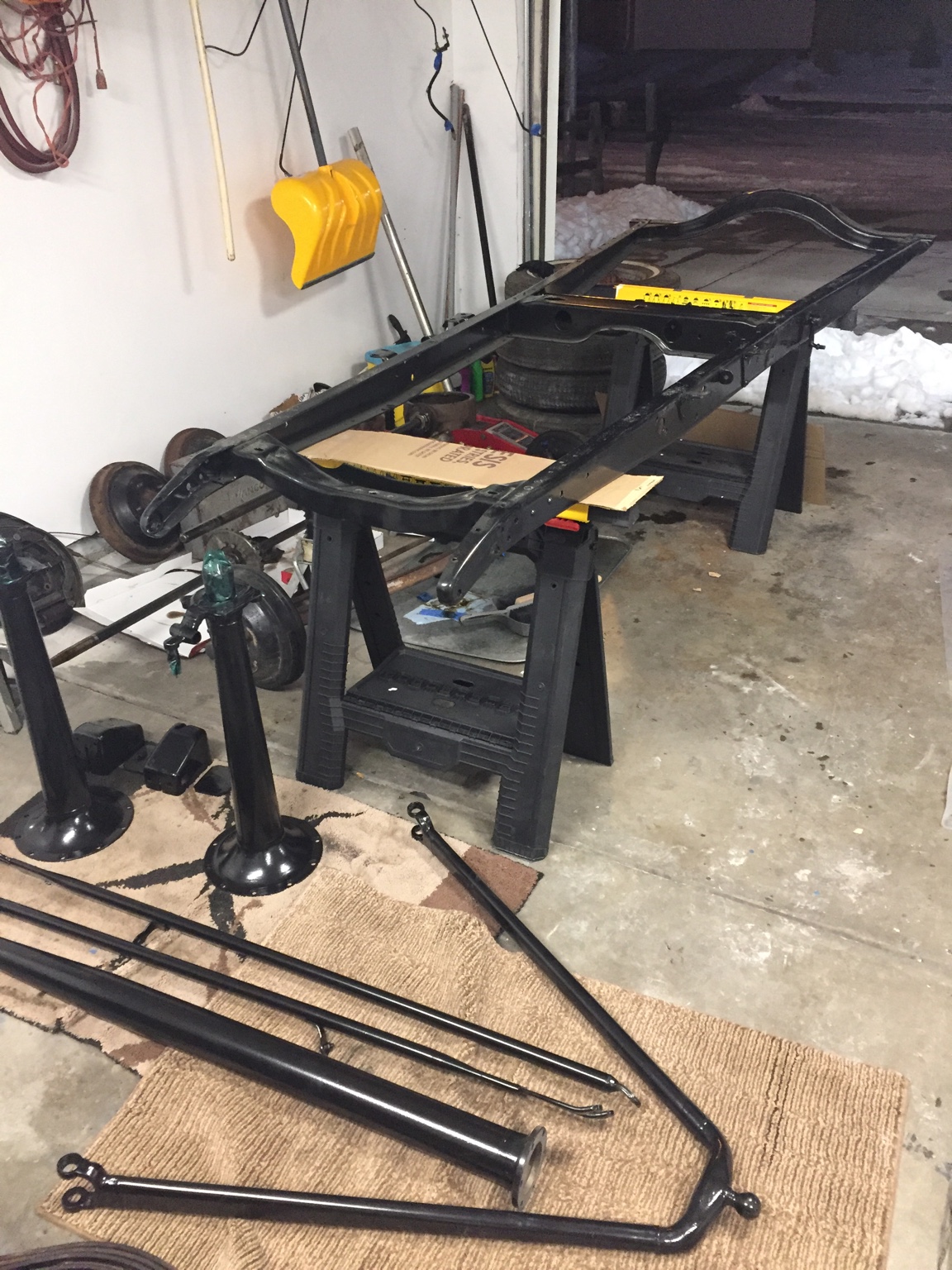

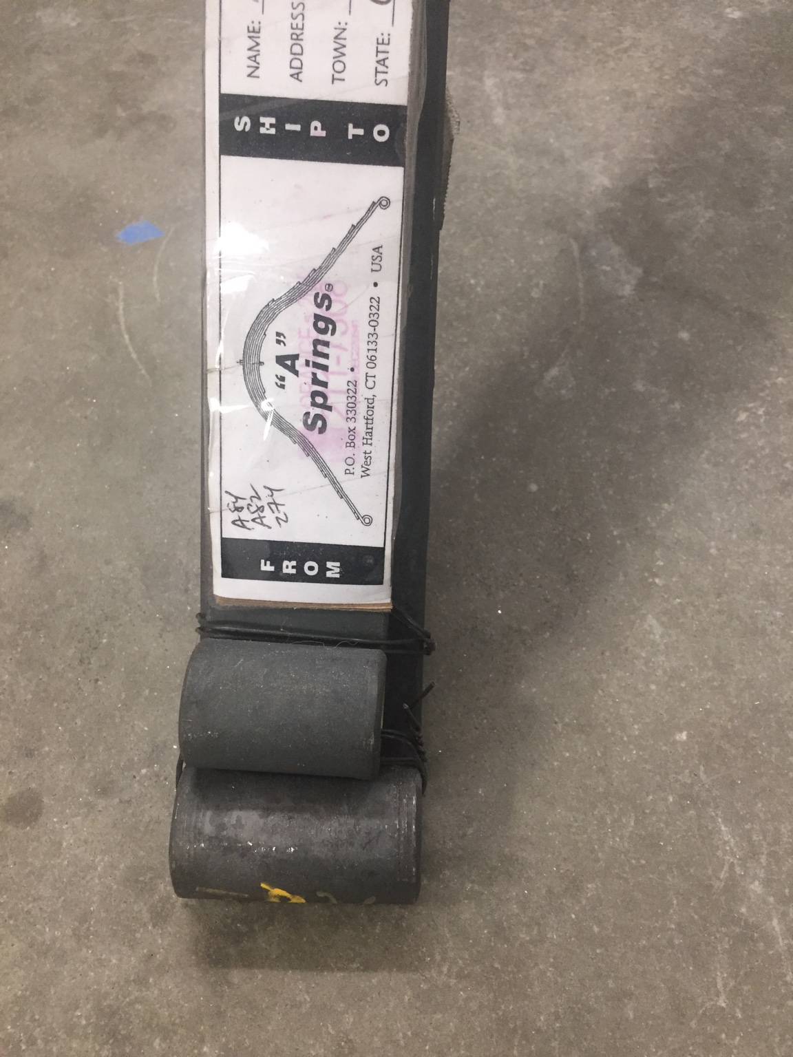

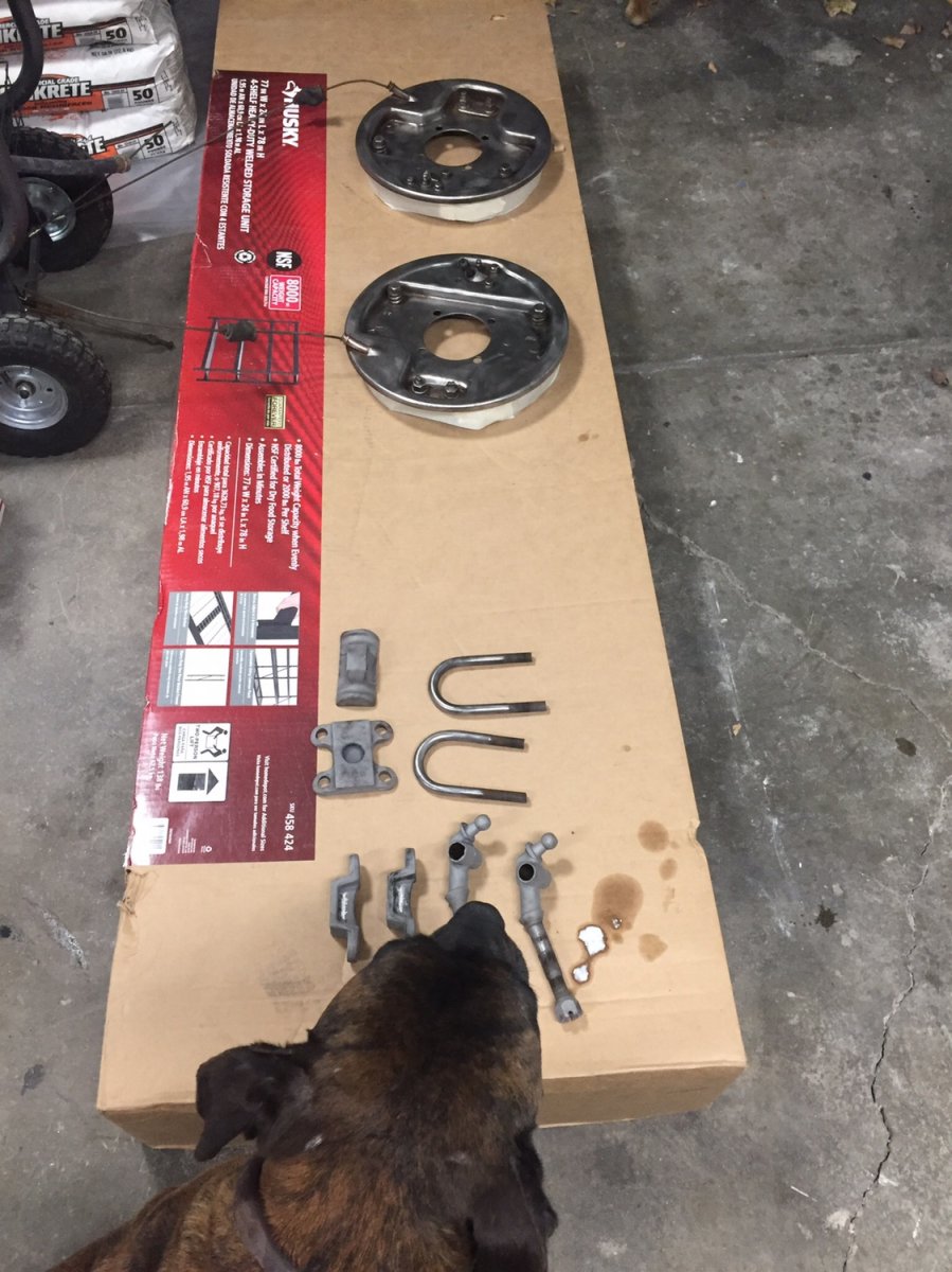

    Slowly making progress on the build. I just got the frame, torque tube, front/rear wishbone, and rear axle bells back from powder coating. It was not cheap, but they turned out really well. (Please excuse the mess in my garage. I'm also in the middle of a home renovation project.)
    I also received my reverse eye leaf springs.
    I will be out of town this weekend, but I hope to continue working on it next week. I have a bunch of cleaning and painting left to do before I can reassemble.

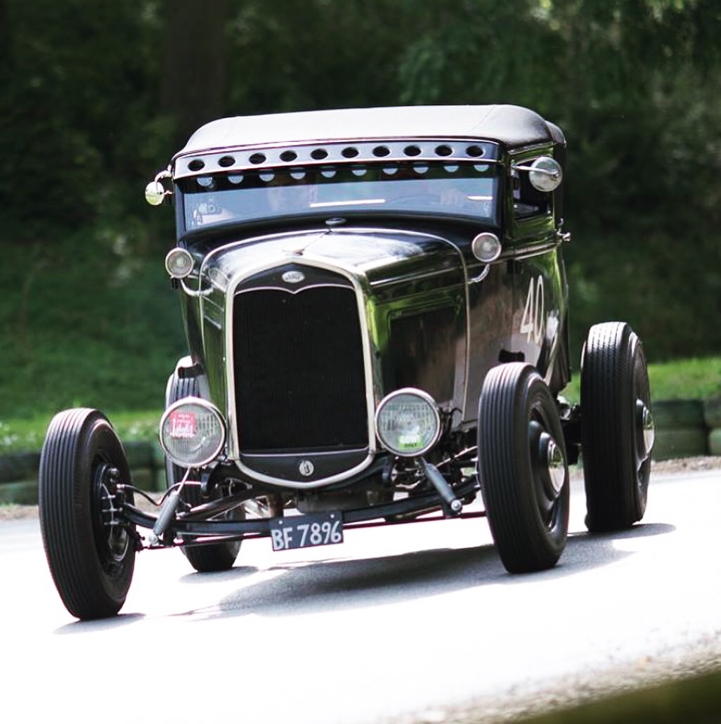

    Carrying a little speed into that corner werent you haha
  28. sloppy jalopies
    Joined: Jun 29, 2015
    Posts: 5,256
    sloppy jalopies
    healthy chop model A 3 window... just happens to have a canvas roof...

    Here’s a shot of cleaning up the rear center section and prepping it for paint. (In the background - My dad is being commissioned to do a frame up restoration on a 31 model A closed cab pickup. It’s been nice being able to compare notes)
    Cleaning and prepping parts for paint.
    Getting ready for assembly.
