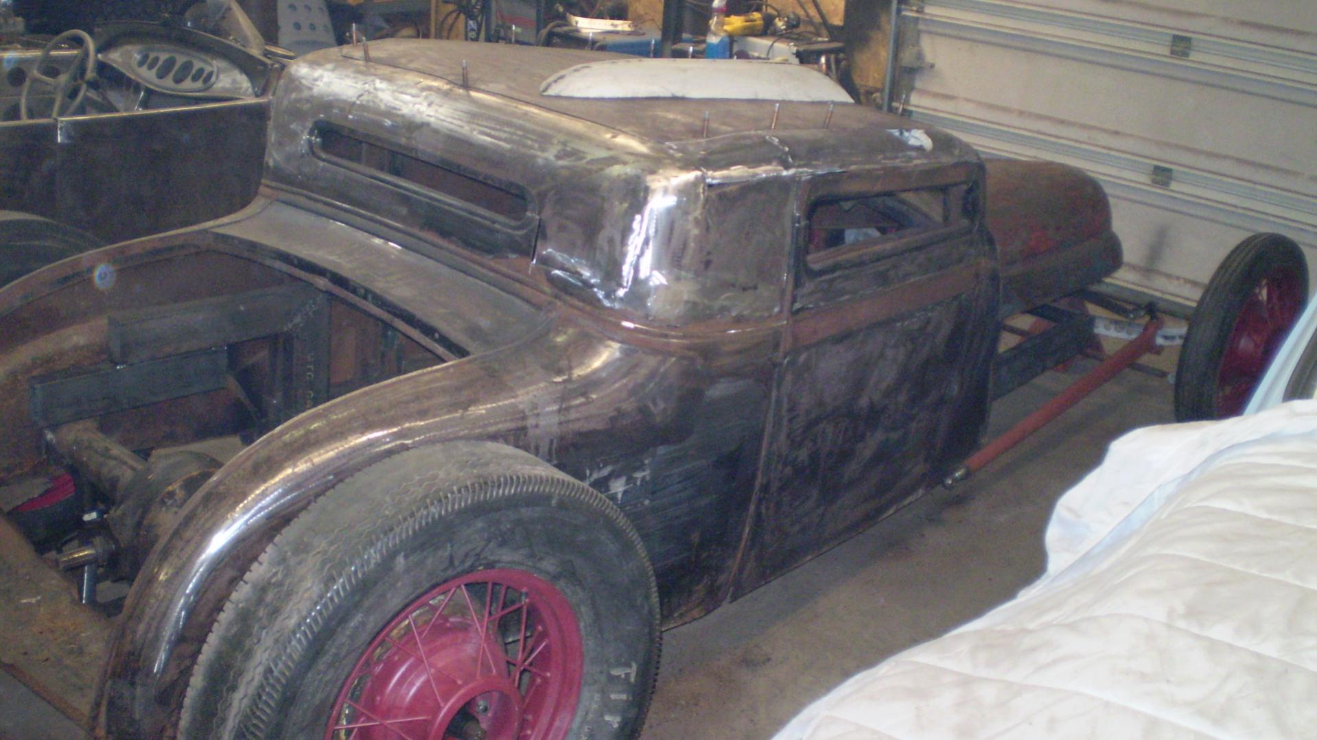

    i have two areas i have to beat around on eather side of the roof. i am hitting it hard today to get it ready to get it to are indoor car show the calilcade of customs. it is in two weeks.

    here are some updates. the chop is basicly done. i just finished making the frame. weel the outer frame. i will be making the sub rails and cutting the essex sub rail out . then i will set the body down on the chassis. i need to mount the front and rear axles. i hope to get this all done by tomorrow. i still have a shot at making the in door car show. i also started stripping the car down to metal. here are the pics

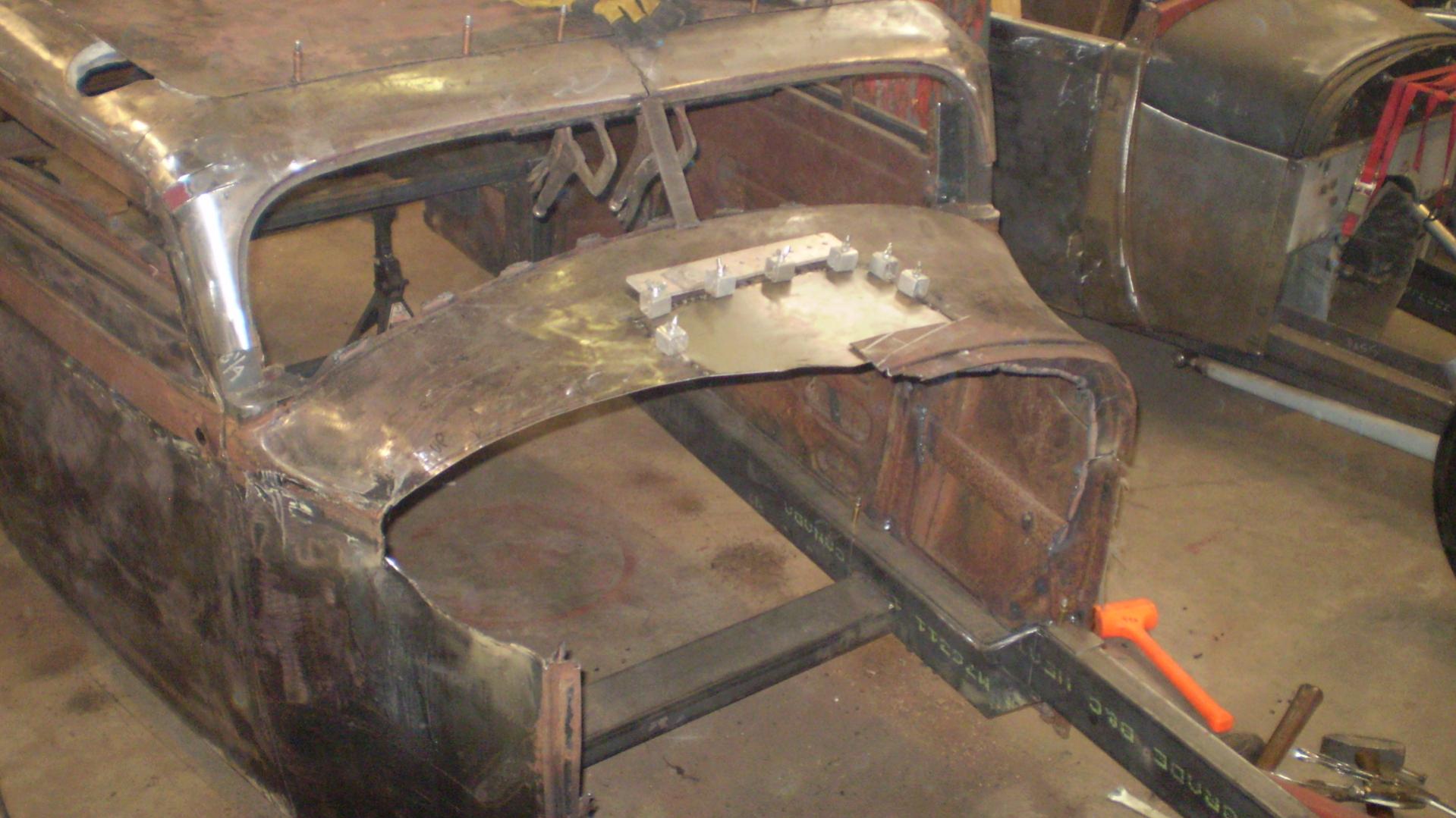

    day 5 and i got the front spring suicide mount made. the wishbones mounted and the front end in. i finished the subrails for the body. i hope to get the body mounted on the chassis monday or tuesday.

    day 6 . i got the body on the chassis and squared up , welded on the subrails. i started to place the international truck hood on and checking fit.

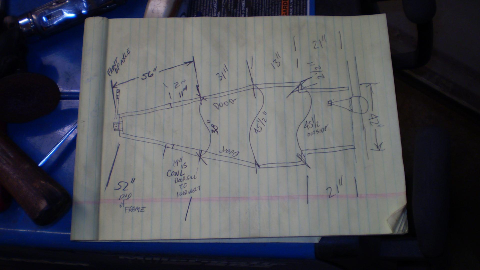

    Drew, the 1/8" x 2" flat stock you used, does it run from the door jamb to the cowl?

    yes

    day 7. got it on its own weight rolling. welded the internaional hood on the cowl. also got the other hood welded on the bottom. the car will be at the car show . i got most everything i wanted done. anything else i get done will be a bonus.

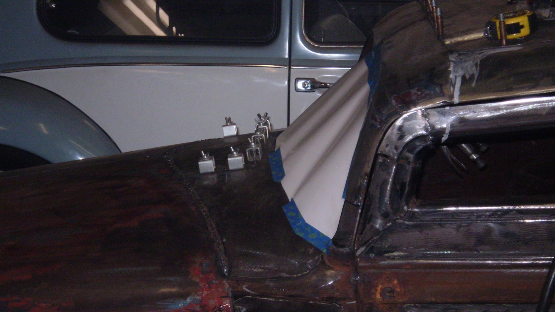

    i also mocked up the size and shape of the windshield . i will be cutting some of the cowl out to make a bigger windshield
