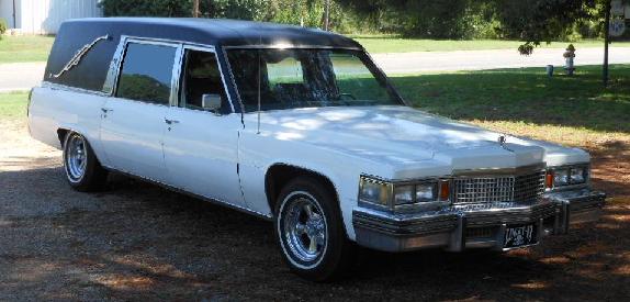

I understand this is just a concept car but just FYI a Ford wouldn't have been a car used back then as the dead was given a better send off in a more expensive last ride. Hearses from that time period were 4 doors and the rear doors were twin barn doors not a single. Most were town cars with driver exposed and had side lamps. The more expensive ones during that time also had wood carved sides. Just a couple things you might want to incorporate to be a hearse.
I may incorporate some of these hearse ideas, but it is a hot rod first and a hearse second; a hearse-themed rod. It has a somewhat generic appearance - it could be a '32 Lincoln, Dusenberg or Pierce Arrow from it's grill (although they didn't sell 2 door sedans, just broughams). It's not going to be specifically identified as a Ford - I have seen pictures of a Dodge Bros hearse from the early thirties...a pauper's hearse (was Dodge more prestigious than Ford then?) I had suggested to my AD that one variant have that George Barris/Tom Daniels vibe to it, but that was shot down.

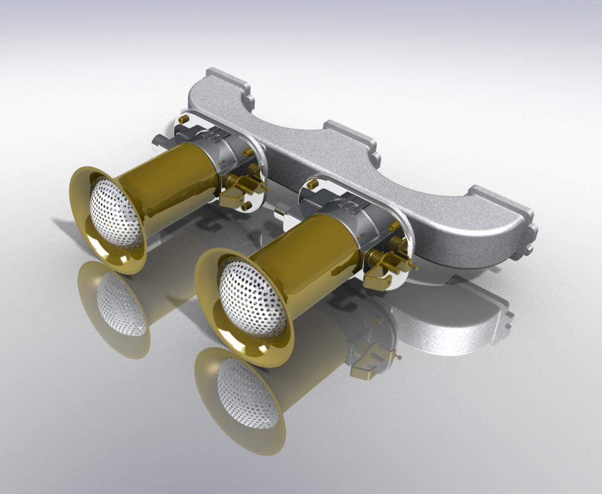

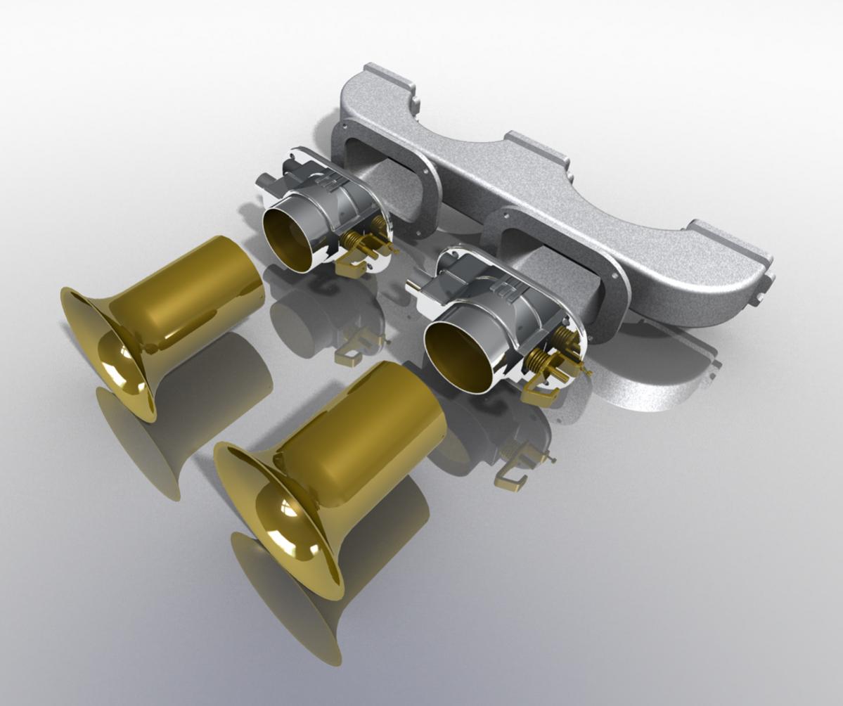

CWR63, I like what I see so far. Interesting idea. Don't want to steal your thread or thunder, but what type of software are you using to your 3D Modeling? Just curious as I am an Industrial Designer and have been using a 3D software called SolidWorks. Here's a little design I did a while back. It's pretty realistic but does take some time. If you need any help, please ask.
Just an old version of 3DS Max, which I pressed into service trying to do a SolidWorks job for 3D printing: Here's the version I'm getting from Shapeways in black shiny ceramic: http://www.shapeways.com/model/673060/1940-ford-solid-coupe.html (This is from the pre-war coupe art challenge 14 here at HAMB) making a 'watertight' model with a mesh modeller rather than a CAD/CAM took so long that I missed the sale on ceramics - had to dial back on the size severely. In the end, what I could afford was so dinky that I'm ashamed to post pics of the finished product...it's that sad. I initially wanted to do this in ceramics because the glazing process would soften the stairstepping that you get with 3D printing, but instead the glaze just obscured all the detail.
