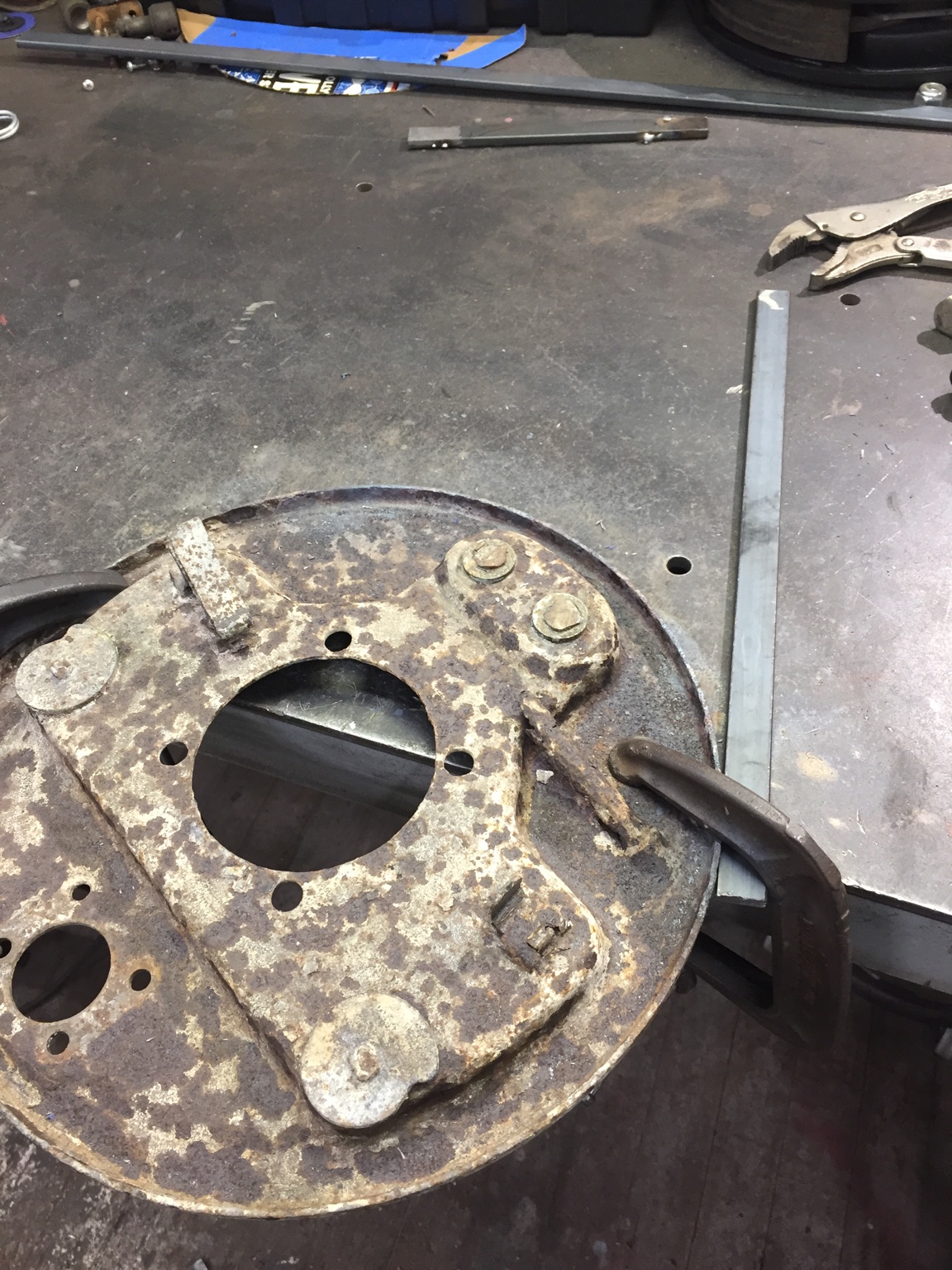

    Started laying out the floor but decided a bit easier project would be better for this last day of 2017.
    So I decided to button up my front fender brackets by adding some additional metal connecting the two mounts.
    [​IMG][​IMG][​IMG][​IMG]
    Got both sides done so that’s off the to do list.

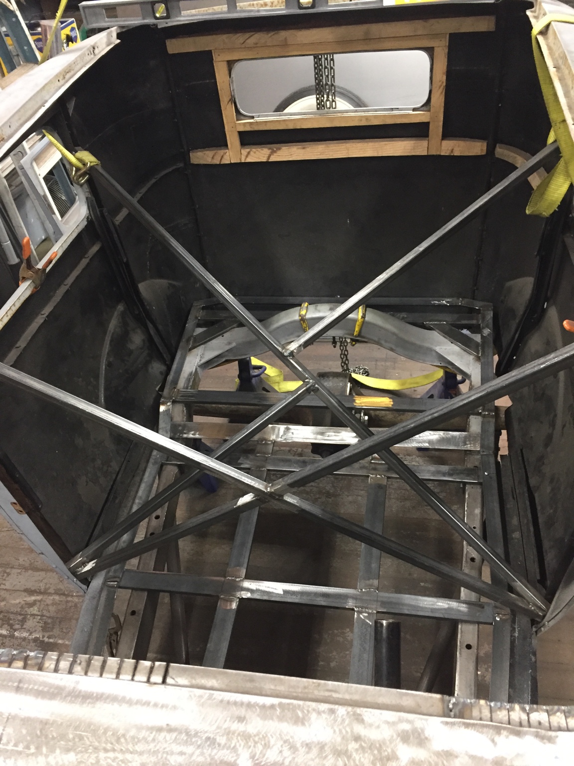

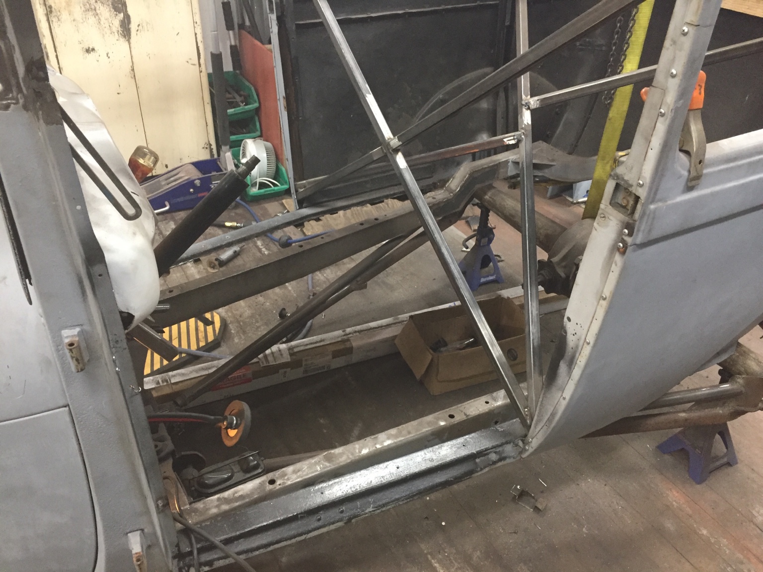

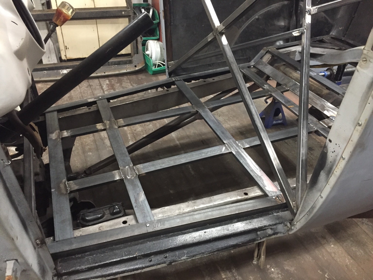

    Made some progress on the floor frame today thanks to the snow day.
    The frame perimeter is 1-1/2” angle 1/8 wall and the floor structure is 2” X 1/2” channel 1/8 wall.
    I decided on the channel to gain an extra 1/2” of headroom over using 1” box tube.
    I made it so I can lift the body off the chassis and remove the floor structure separate and finish weld it both sides.
    Then once it’s all set I’ll lift the body up and place it back down and weld the two together.
    I ran out of stock before I could do the cowl and trans areas.
    [​IMG][​IMG][​IMG][​IMG][​IMG][​IMG]

    Started laying out my filler panels between the new floor/subrail and rear portion of the body.
    I fabricated a mount the entire width of the rear / subrail to attach the new floor to the original rear subrail crossmember on the back of the car.
    Hard to get pics of it but you can see the gussets I made using some top hat stock from the vertical window/interior panel mounting stock. (I think that’s what it is.
    I had to remove the lower 4” because of stepping the rear.
    Hopefully get those done in 16 ga later today
    It may not be perfection, but it sure is progress.

    Thank you for the info on the backing plates. I will certainly keep watch. I added the extra bracing and mounting surface to the mounts to hopefully avoid it. Also to give them the appearance as something that would have been specifically made for ford brakes “back in the day “
