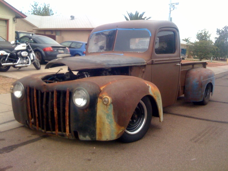

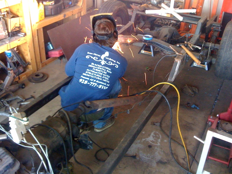

    I've recently been more productive on my ford so heres a little show and tell on the progress.
    I started with a cab and bed on the original frame modified with a 1971 camaro front clip, a late model firebird rear and a 1995 full sized chevy van TBI engine and wiring harness. I immediately ditched the wiring harness for a Painless 8 circuit modular and the TBI setup in favor of a more simple Edelbrock performer 2 intake manifold and Holley 750 dp(my only spare useable carb at the moment).
    After wiring the entire truck i decided a lower center of gravity was in order so I took it all apart and lost motivation. It sat in my garage untouched for a little over 2 years.

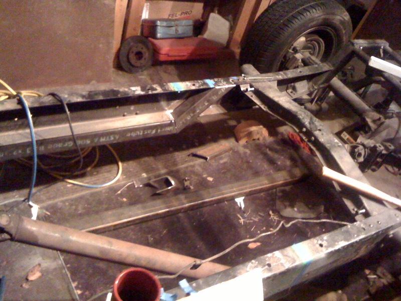

    About 4 months back the urge to get going on it again overwhelmed me and I went back to work. I reworked the frame by welding in 2x3 rails with 1 5/8 and .25" plate x-bracing, hoop and reinforcement under the footprint of the cab. This allowed me to lower the cab 6 inches and returned the original swept down look of the subframe. My neighbor Zach did the main rails (as I am not a pro welder yet) and I wanted it to be warp free and strong as hell. Future plans for the frame is a 12 pt roll cage and some changes to the back half and suspension.
    I lifted up the suspension from the previous stance to get better suspension geometry and purchased some new rolling stock, future plans call for a 5 link with either air bags or coilovers.

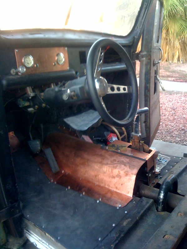

    The interior is accented with 16ga copper plate and 16ga @ .25" brass plate, .5" rubber floor and the rear bench seat from a 1975 datsun b210. I am rather tall(6'5") and have big feet(14) so I moved the column pitch up to accommodate the 6" lower cab and new pedal position. I just popped in a nos windshield with a custom made copper center post with brass accents... still lots to do in here!

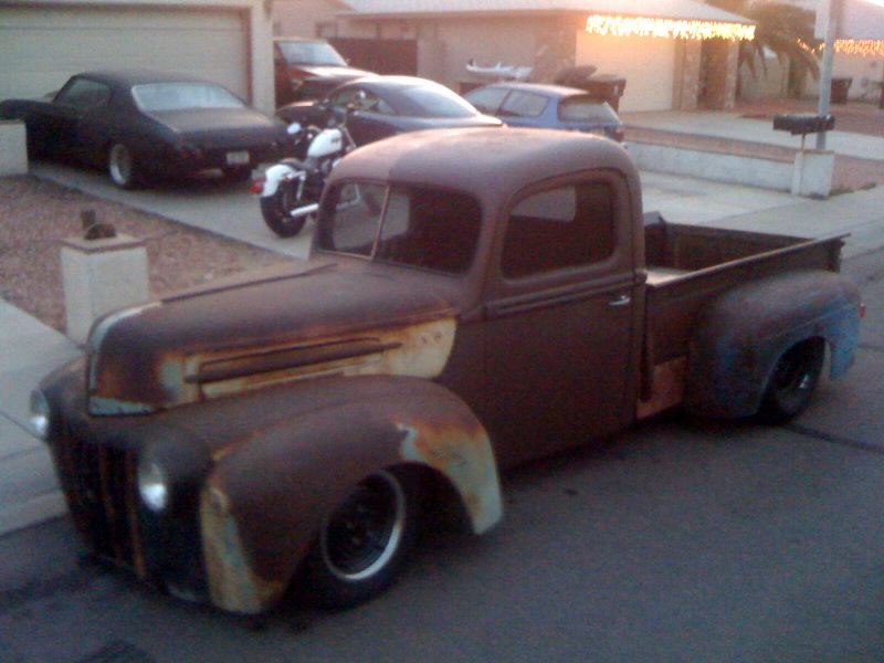

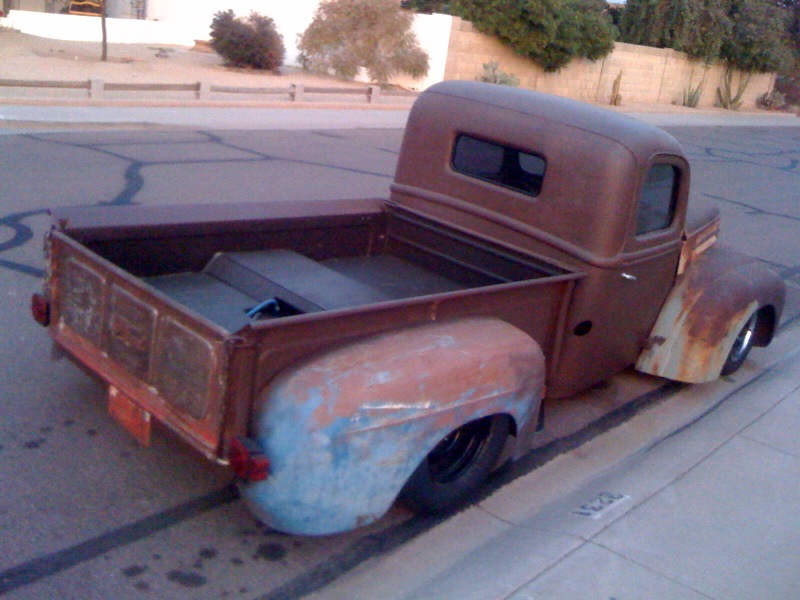

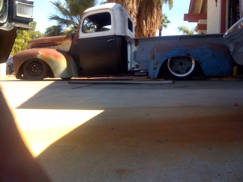

    Here is the interior shots and the more finished exterior shots of the truck
    I drove it to work, a 40 mile success!

  4. can you actually steer that thing with the Camaro clip?

    I ended up getting 2nd gen f body spares to make it work, I was skeptical about the handling of 165r15 tires on 15x4 wheels but it function quite well. I originally planned on widening the fenders 2 inches to work with my salt flat specials(theres an unfinished pic in my profile with them mounted), just haven't gotten to that point.

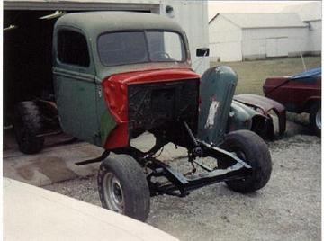

    oh yeah, here what I started with...

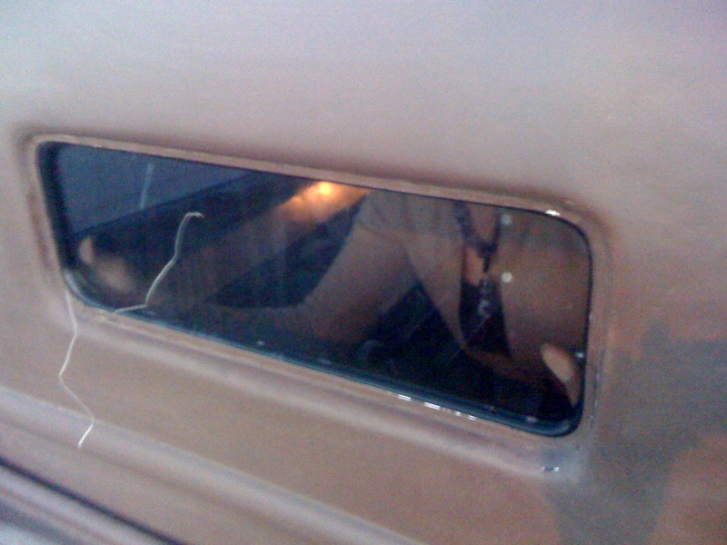

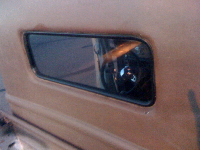

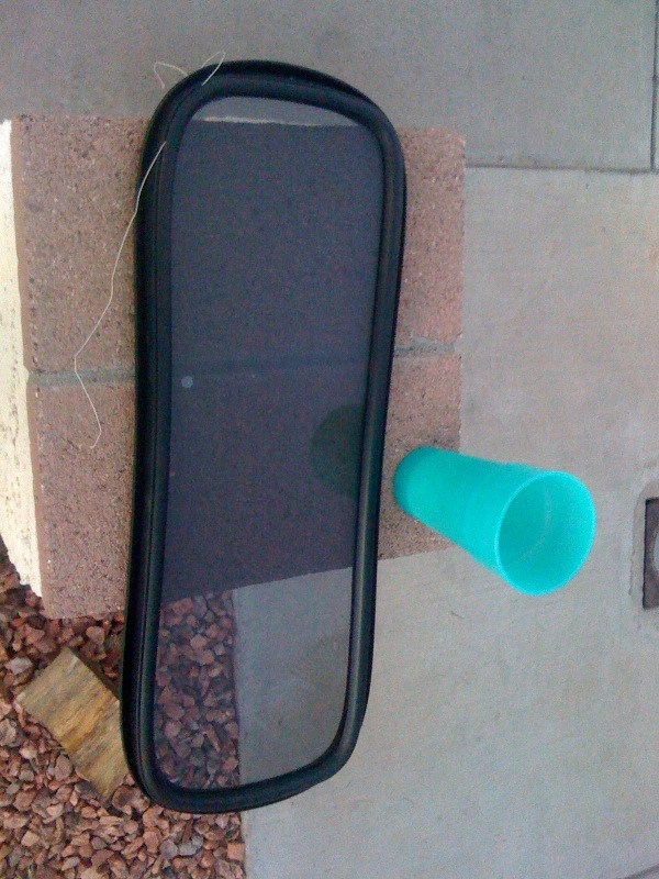

    Last night I installed new rear glass with a seal from socal and it went in smooth. First I prepped the area removing all sharp edges. I then wrapped a thick kite string around the channel that held the seal cab. I used a mixture of liquid soap and water to lube the strings release from the rubber(pour it in until it spills out both ends). I had my wife hold the glass in from the inside with the fatter edge facing inside(it's larger due to it covering the edge of interior panels). Then slowly pull both ends of the string and knead the rubber around to engage a proper fit!

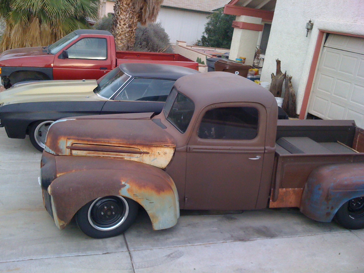

    Here's some fresh pics
    We Got a little cold this winter, here it is frosted over
    Heres a couple driveway shots with some of the rest of my brood
