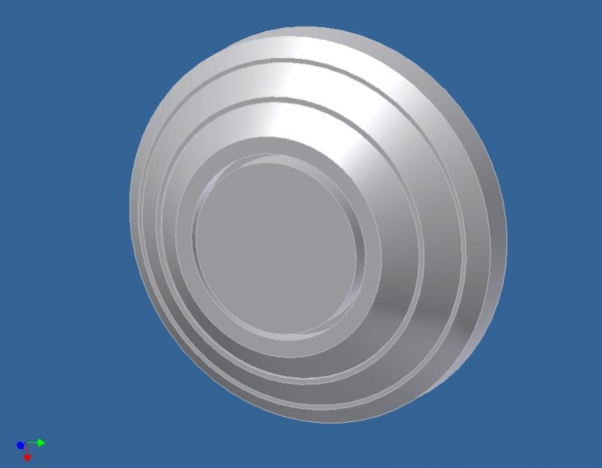

    Here is my initial design for the button assembly:
    Material will be polished stainless steel for both the button and the housing.
    OD as drawn is 1 1/2", and the overall depth is 1 5/16"
    No final price yet, as I still have to run the numbers, but I'm shooting for a price range of $155 - $200 per pair (two assemblies).
    Whatcha think?

    Alrighty then, since I've not gotten strung up over the looks, I'll run the numbers and have a real retail price estimate in a few days or maybe a week.
    Anyone have any comments on the size or the overall appearance?
    Would one of you guys who has a set that's not installed measure the OD of the bezel and post it? I just want to see how close I came to the correct dimensions.
    That model was done entirely from the pictures you guys posted in this thread, so I was (and still am) a bit apprehensive about the whether the exterior dimensions are close or not.

  13. I have a thought...
    Instead of a bezel surround that is welded into the door, how about making the OD of the button assembly housing (the part that doesn't move) slightly smaller than a common size hole saw. As for attachment, I'm thinking something a little different than the stock Lincoln setup. Look at 60s dash switches where the body is threaded and the bezel screws on, or the bezel is integrated to the body and a nut screws on to the threaded body from the back. A softish washer like bronze that is fairly thick (1/2" or so) to go between the nut and inside of the body could be easily filed to fit the contour of the sheet metal and prove good enough clamping to prevent loosening without worrying about distorting the surrounding sheetmetal.
    Then, after the usual filling of door handle holes is done, you could just locate where you want the button, drill a hole with a hole saw, file the washer to fit the countour, and screw it in. Guys could turn it sideways for cars where the latch mechanicsm rod needs to move up and down instead of front to back, too. A longish lever arm with multiple holes to change the ratio, and ultimately the throw of the linkage rod, would make it much more universal. The mid 60s Ford method of attaching the rod to the pushbutton and latch mechanicsm looks pretty universal-ish, or guys could use components for universal throttle linkage rods for multi-carb setups to hook the latch to the button...
    As for pushing the door out enough to grab hold of, old-school mechanical (spring loaded) stand alone door poppers should work just fine. Hood latch springs work nicely, if you have a wide enough jam area.
    Integrating a pusher mechanism into the button assembly will require many variations or limit the market to a certain range of lateral distance between the button and the door jam.
    You could also leave mounting points on the body of the button assembly for an optional bracket and microswitch, so that a slight push activates the micro-switch to run electric latch and popper action for the gold chainers that don't have the finger strength for a mechanical setup (and the latch and popper setup could be robbed off of a dozen late model high end cars that work that way). Broad marketability to the guys with bucks to make it commercially viable, and still functional as a mechanical button for those of us who don't want electric doors :)
    In my experience, the more widely varying the possible applications are without re-engineering, the more commercially viable it will be. I want a pair, but you won't make them if they are not viable :)
    Just my $.02

    This first go-'round is going to be just a button and housing assembly. No linkages of any kind, no trim rings, no weld-in bezels or door patches.
    The bezel is integrated into the housing, such that you just cut a hole into the door that is 1 1/4" in dia, drop in the button, and secure it from the back side with hardware that will be provided, including a compliant washer for the back side (good call there BTW, great minds my friend, great minds), though I won't be using bronze.
    You only have to drill the one hole, and that's it. If you have to cross a funky body line or something, the underside of the "bezel" portion of the housing can be modified to suit the application (IE cut it to conform to the body line), or the whole button can be frenched through the body line. You will be able to do everything with my version that you can with the stock Lincoln version, and probably more besides.

    The pic I posted was from Solidworks.

    I measured the repro stainless steel Lincoln pushbuttons with a caliper and here’s what mine are:
    - Bezel O.D. = 1.986”
    - Bezel height (above door surface) = .253”
    - Total height (above door surface, including pushbutton) = .315”
    - Main body O.D. = 1.550”
    - Main body depth (from back side of bezel to the end of the body) = 1.910”
    - Actuating plunger O.D. = .810”
    - Actuating plunger movement .180”
    Hope this helps, but if any of my terms are confusing or if you want any additional info, PM me and I’ll do what I can to help you out.
    -Bob

    Now, that said, would it greatly offend you guys if these buttons weren't exactly the same size? I say this because hardware is a lot easier (and cheaper) to source in even standard sizes.
    It appears to me that the bezel ring on the originals is ~1/4" wider than the ring on my version. Would this be a problem? I figured that the smaller the OD, the easier it would be to mount on crowned panels.

    Thanks a lot for that ZMan, those pics are gold.
    What do you think about the size being slightly smaller?
    Is this a big deal to you, or will they be OK as is?
    It's not a big thing to remodel them, but it will make them more expensive to produce, and I may have to manufacture the mounting hardware instead of just buying off the shelf stuff.
    You guys have any opinion on this front?

    A bit smaller wouldn't bother me. What size are you thinking about?
