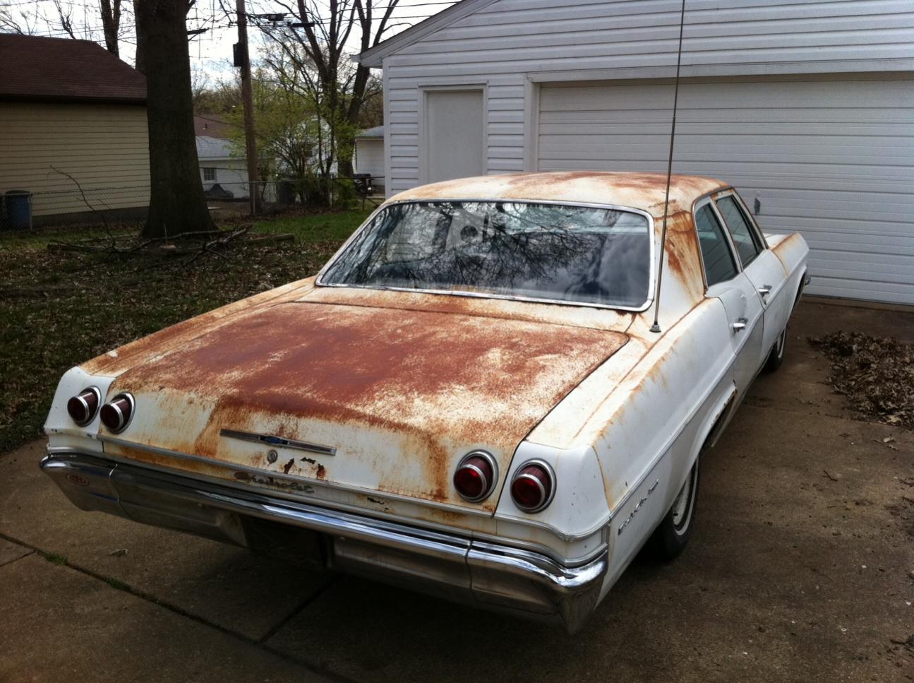

    Im starting to get the sanding and body work done on my car so i can paint it. My question do i sand the whole car down to bare metal? id rather not. If i dont do i just use sealer on the parts that are bare metal and then prime the whole car? Just seal and prime the bare metal? prime and seal the whole car?
    im nowhere near done sanding just wanted to give an idea of what im talking about.

    1. Kustom Painters
    You HAVE to go to bare metal. Your car has a lot of surface rust showing, and I guarantee, that what's under the paint that's left, probably has rust under it as well.
    So, strip or sand the car to bare. Treat the rust appropriately (do a search). Then either use an etch primer, to be followed later by urethane primer, or use an epoxy primer. I prefer HOK epoxy, as it is good on bare metal, sands easy, and you can put bondo under, or over it. Most epoxies you can't do this with.
  12. overspray
    Joined: Jan 14, 2003
    Posts: 1,417
    overspray
    Mark is the only one that mentioned the rust showing on the surface and that it needs to be treated. If it is rusting like in the picture, that means the original phosphate coating on the bare steel has degraded. A metal prep (phosphoric acid) or an etch primer will treat the rust and re-phosphate the metal and prepare it for a primer. Epoxy primers do nothing for rust, except cover it. Most automotive epoxy primers available today have low to medium solids content and still need to be primed over with a primer filler or hi solids primer as part of the foundation for the paint.
    As Mark said, the HOK epoxy is a good primer with good solids content, but the rust still needs to be treated before the epoxy is applied.
