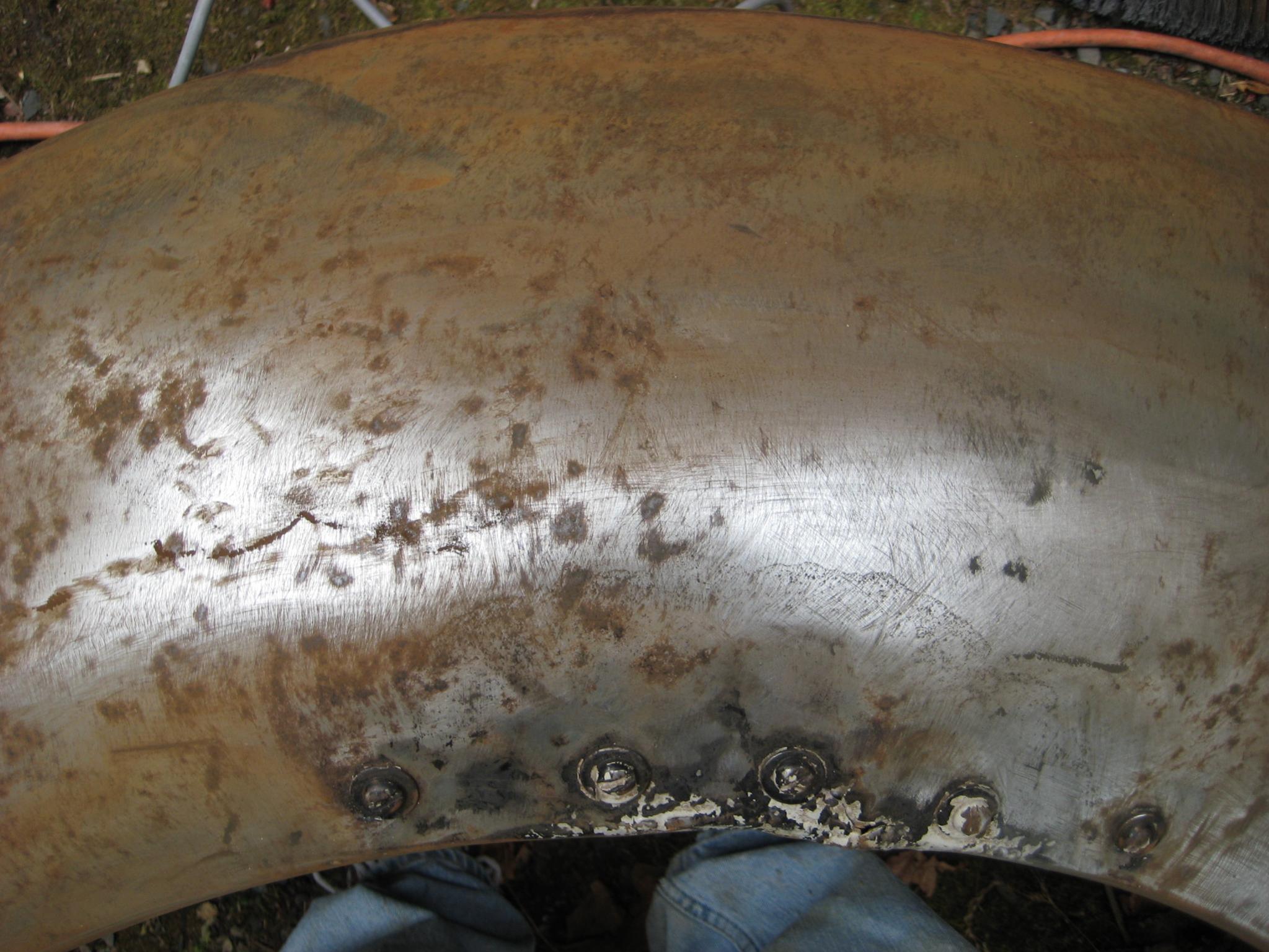

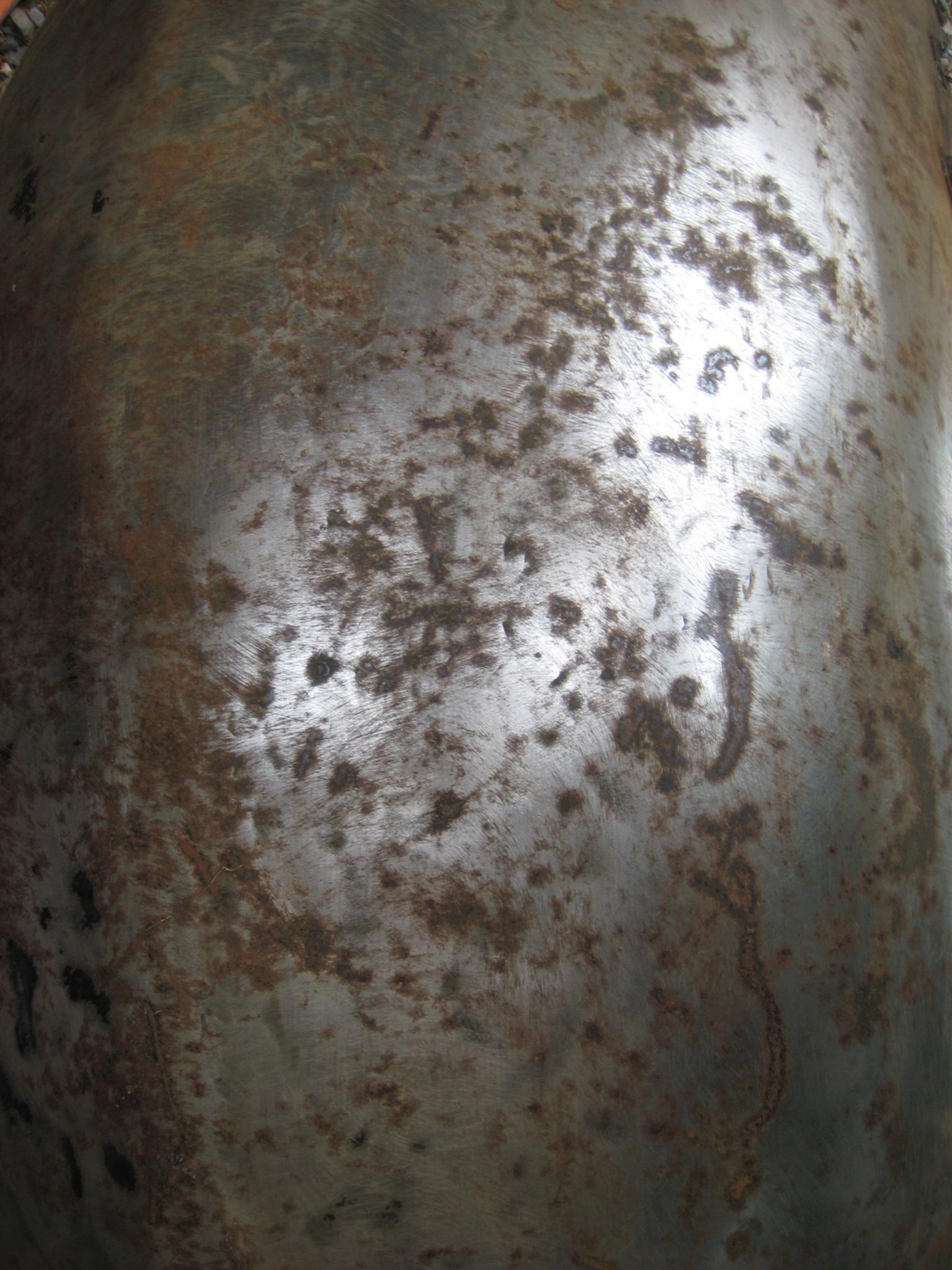

  1. A couple of recent threads on this subject got me to thinking more about the possibility of hidden gremlins under the 45+ year primer (Rustoleum, as I recall) on my coupe. I have a spare fender that I am subjecting to my body and paint "skills", so decided to strip it back to the bare metal. Sure enough, my worst fears were realized.
    How does this happen in a dry storage environment? We have humidity here in the northwest to be sure, but its not as if the car has been directly exposed to it over the years. Looks as though I will be starting from scratch on the body, as well!!

  4. Water is known as the universal solvent. Given enough time it will penetrate MANY surfaces. Due to the chemical nature of primer (not to mention the formulation of decades-old primer) the penetration will happen quickly. Primer is designed to have a top coat, so it will allow penetration.
    Shit happens. Just suck it up and re-finish.

    There's the possibility that the rust was in the grains of the metal prior to your primering it twenty? years ago. Once the binder, that's the oil in the Rustoleum breaks down from the attack from oxygen, rust + moisture+ oxygen = more rust. It doesn't take much moisture to get it started.
    Today, I wouldn't waste my time with epoxy primers given they no longer contain lead, zinc or cadminim. Instead, step up to a full urethane primer with better resin technology. And remember, anything that comes in a rattle can was designed for use by your wife for her craft projects, NOT for use on motor vehiciles.

    Rust NEVER goes away. If there is any corrosion present on the metal, even under a lap or overlap seam, it will eventually creep out and cause a failure of the coating used to cover the metal.
    All primer, even catalyzed epoxy primer, will absorb moisture and eventually a failure attributable to rust/corrosion will occur.
    It's all a matter of degrees.... Depending on the exposure to moisture or the degree of existing corrosion, it may take weeks or years for it to make it's presence know. Rest assured, though, that it will eventually show up.
    Even if the car body was carefully media blasted and then etch primed, which will pretty much eliminate further corrosion, rust can still creep under the etch primer if it was hidden under a seem somewhere.
    The chemicals on the market that are designed to prevent corrosion only work if there is NO corrosion to begin with.
    The chemicals on the market that are designed to neutralize rust only work on the rust it reaches.
    These two "rules" are exacerbated by the lack of a top coat.
    All of this is why I have such a hard time understanding the whole bare metal/primered car thing...... The amount of work required to reverse or repair the damage caused by leaving the metal exposed is monumental and often enough to destroy the value of the car.

    Where I live the humidity is usually pretty bad, so when I sand blast a part I will DP-90 it within a hour of getting done. If I strip some sheetmetal down , after it gets 180 grit sanded , it gets primered and I adjust my schedule too do it. Its the most important thing. I've seen sandblasted metal start rusting again by the end of a workday left unattended. That rust starts microscopically in the pores of the metal, so its the rust you don't see that gets you.
