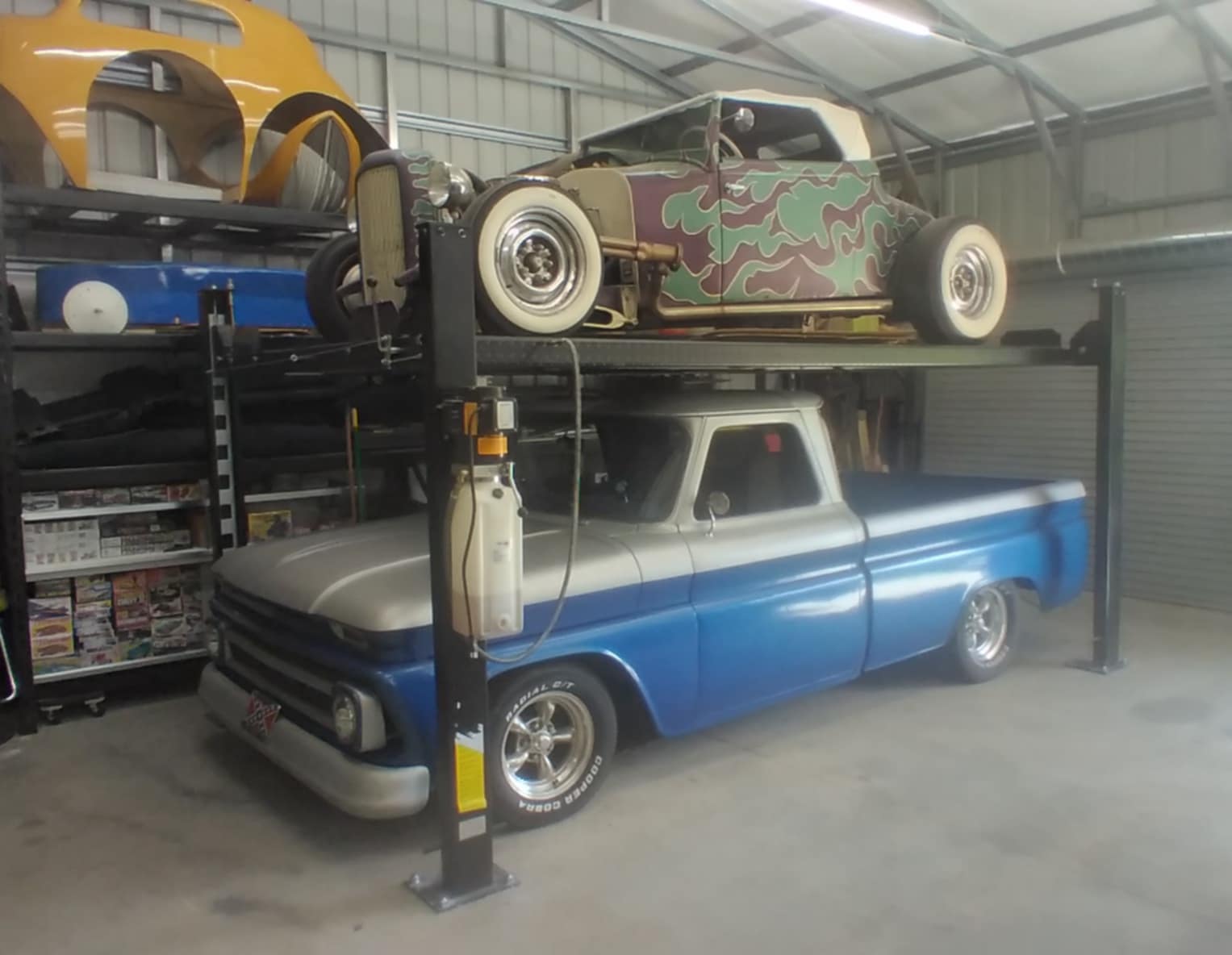

    Look in Greg Smith Equipment. I got my 4 post from them, Good safety features and very adjustable. $2250 delivered. About 2009. Four post lift.jpg

    Nice shop, looks like stuff gets done in there.

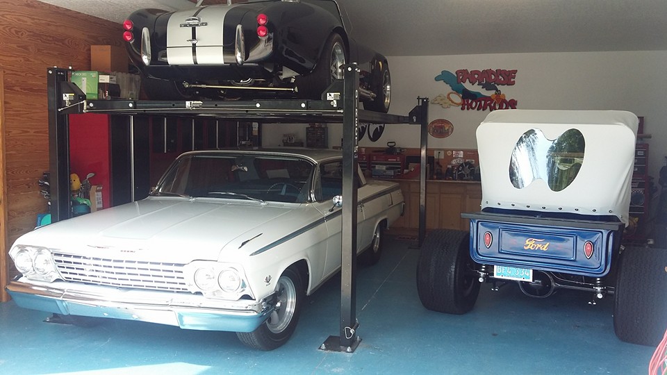

    54d02753-7dca-45ad-8182-dc89a46def9b.jpg 12814015_10154048015599917_7160769456881592940_n (1).jpg I got mine from Race Tool Direct, i think they all come down the same ASSY line as they send the brand name decal separately. I paid $3600 shipped. My Benpac lift is a little better lift but cost more now.
