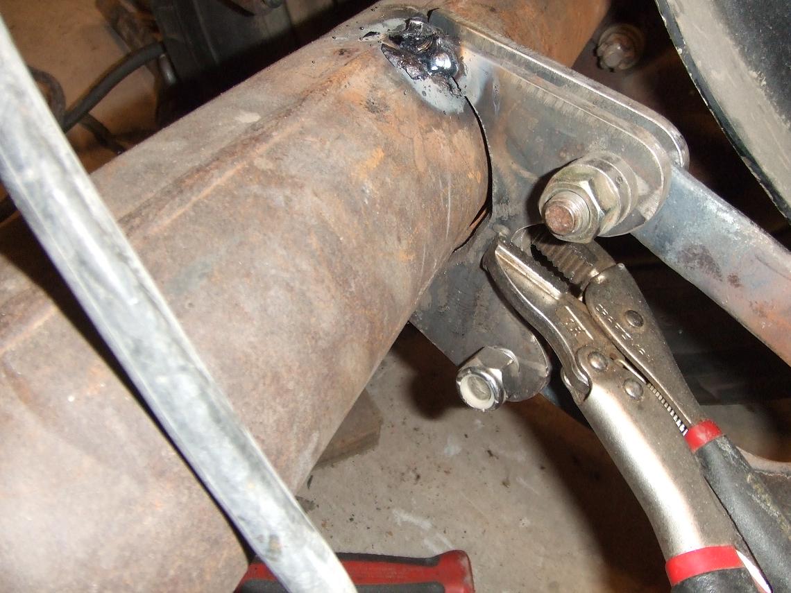

    Trying to get my 32 frame of unknown origon, model a front, banjo rear, extended rpu body to line up. How perfect does perfect need to be?
    I know the 'shops' have jigs....I have strings and tape measures. I think I am more like back then......but the HAMB beats up nothing less then wonderfull.
    I have built in adjustment in my build, it just seems HAMB rock stars are always right on the money.

    As perfect as you want it. Now is the time to make the adjustments, before you paint it and put it together. It comes down to how you want it and how happy you're going to be with the end result. I don't have a jig either.
  3. no jig , i have built a lot of frames on sawhorses. levels/strings/tape measures/angle finders can work just fine if you know what you are doing. but if you don't know what you are doing all the fancy tools won't help

    havent built a car yet but ive built many motorcycle frames, i tryed to use a jig once and didnt like it. we just used a 1/2" thick steel workbench with a permanent centerline and some tapped holes, stringlines, striaght edges and rafter squares, a good spirit level are all ya really need, those lasers are real good too, remember the road that it'll be driven on aint all that accurate ethier.
  6. Seems like you have a bad attitude. Can you adjust away flex in a rebar drag link, or U-bolt steering arm?
    And it's "Perfection" and "dial".

    Thanks Nevala for making sure that I have all my mock up shit ready to go.....Heyo, notice the shitty vice grips? smart guy?
    Anyway....Thanks for real answers.
  9. Are the only real answers the ones that agree with your opinion?
    Show something of your finished work that compares with the people that you want to throw shade at.
    Also: "laughed" and "banger".

  11. Jigs aren't all they are cracked up to be if they aren't perfect themselves. I had a frame that was built by a rod shop in Tennessee. He used a jig. After I got the engine/trans and rearend all mounted up and had the cab placed correctly I put my truck bed on it only to find that the very rear of the frame was welded ¾ too narrow on each side. Other than change everything, I have decided to change the rear fender mounting and make a custom fitted spreader bar.

    Holy crap that really is rebar and a U bolt! I thought you were kidding. Lot of attitude for a FNG. There are lots of good people here to help. If you're nice. I think all anyone is saying is get GOOD parts together BEFORE your search for perfection.
