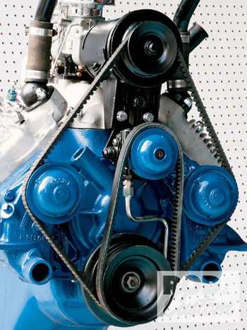

    there a company WA Bunddell Speed and Machine make a pump w/ bracket for the gen.
