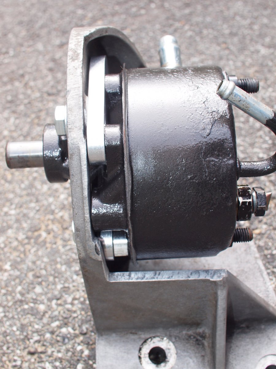

Been digging back into this project and found that I had stowed away a ~2001 Saab 9-3 power steering pump (p/n 5061841). This is type II pump which uses flow/pressure fittings which are compatible with the P-series pumps. The orifice on the flow fitting is ~3/32", a bit smaller than even the Cavalier pump mentioned above. The overall length of the pressure relief valve is 1.382" vs. 1.375" for the P-series pump out of the Chevy Astro. I'm going to give this a try and see how it works out.
It works! And it works well! i.e. Not whiny, and not too much assist, which is something I was concerned about since GM power steering is often too over-assisted, so you loose road feel. It think it was the Saab 9-3 volume regulator that helped the most in that regard. Before I forget everything, here's what the build consists of (listed in one place). XR4Ti power steering pump bracket, clearanced for Saginaw pump and adapter horseshoe ~2000 Chevy Astro power steering pump $15 ~2005 Chevy Trailerblazer 4.3 pulley Edelman Power steering pump rebuild kit (p/n 7918) $10 PSC Saginaw pump adapter bracket (p/n PSC-MB03K) $30 Saab 9-3 Pump Volume and pressure fittings (only) XR4Ti Hi-pressure hose - bottom half Saab 9-3 Hi-pressure hose - upper half 3/8" barbed fitting to create new hose $5 40.7" / 1035mm Microgroove belt (p/n's 6PK1035, 407K6MK , 5060407) Technically NOT a stretch belt, but I was able to maneuver it on Volvo Power steering reservoir (small, square black unit)
