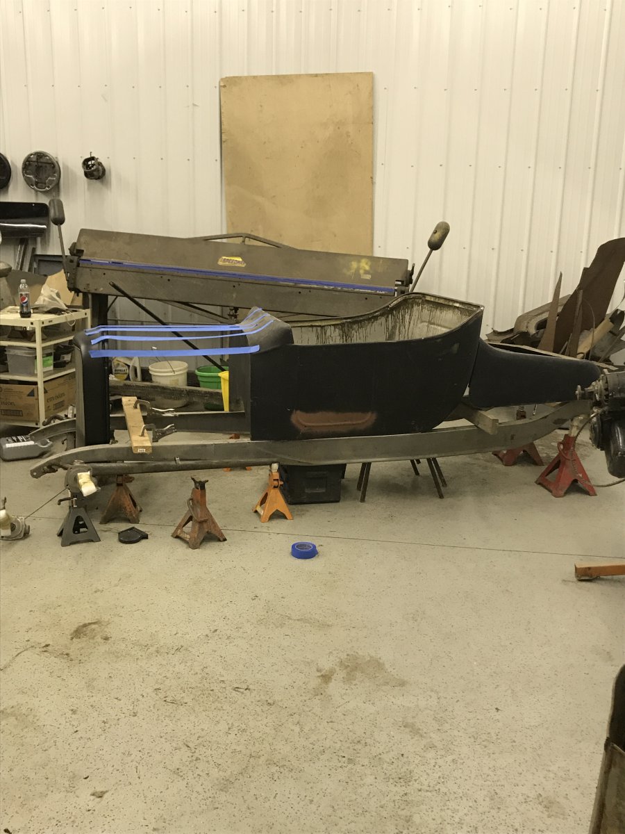

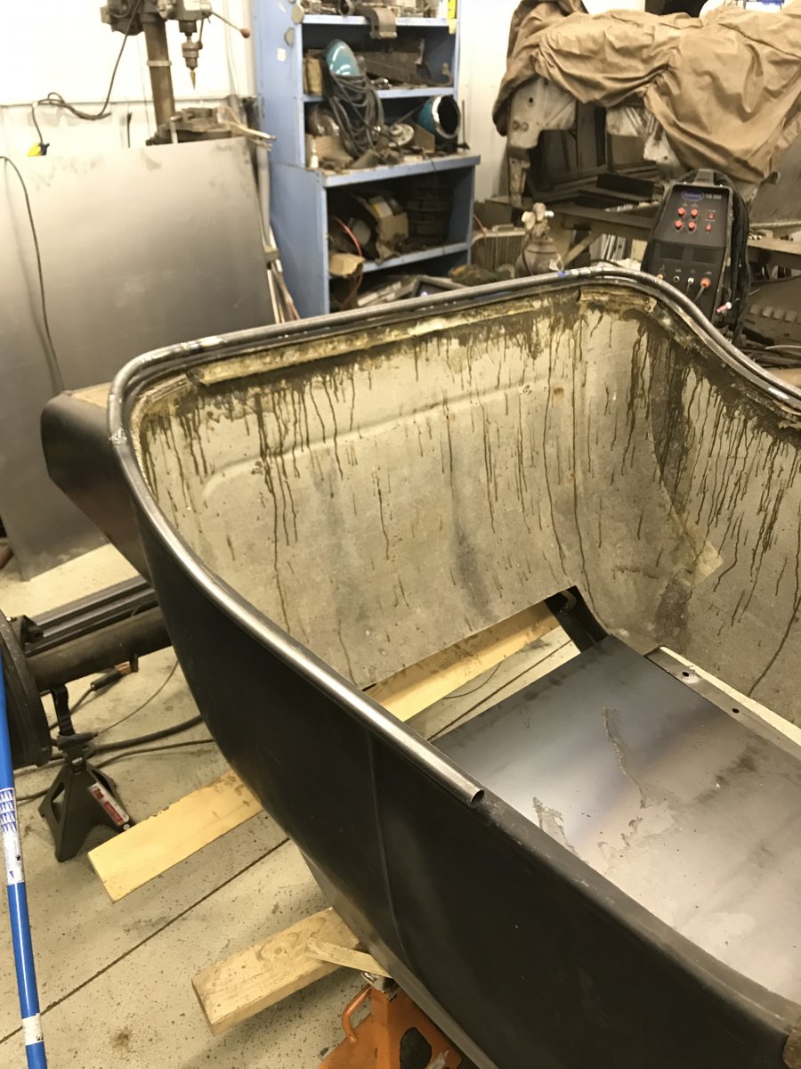

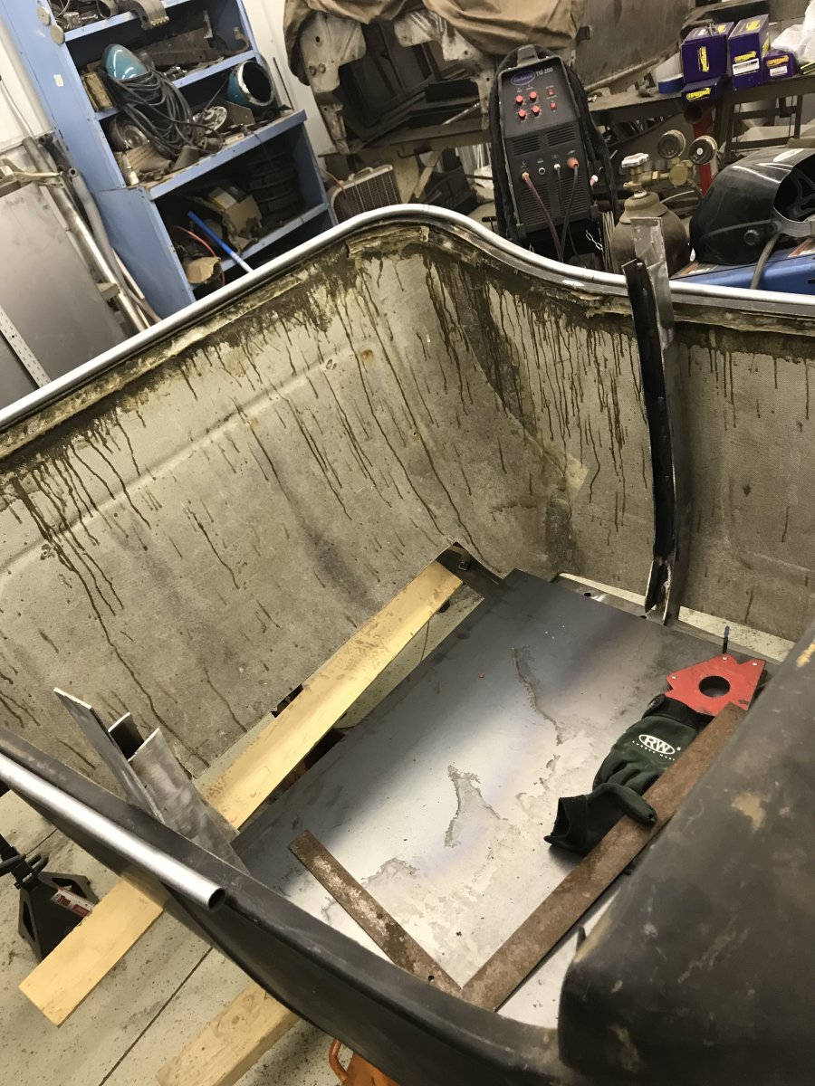

    Well here it is to date. After mocking it up in the corner, creating a plan, and starting to collect parts to build a glass roadster, things took a turn. IMG_1279.JPG IMG_1282.JPG While figuring out how to put a floor , seats, and everything in a fiberglass tub, I thought maybe it would be just as easy to build a steel body instead. Needed to get the frame length sorted out to figure where everything needs to fit in the big picture. IMG_1472.JPG IMG_1474.JPG

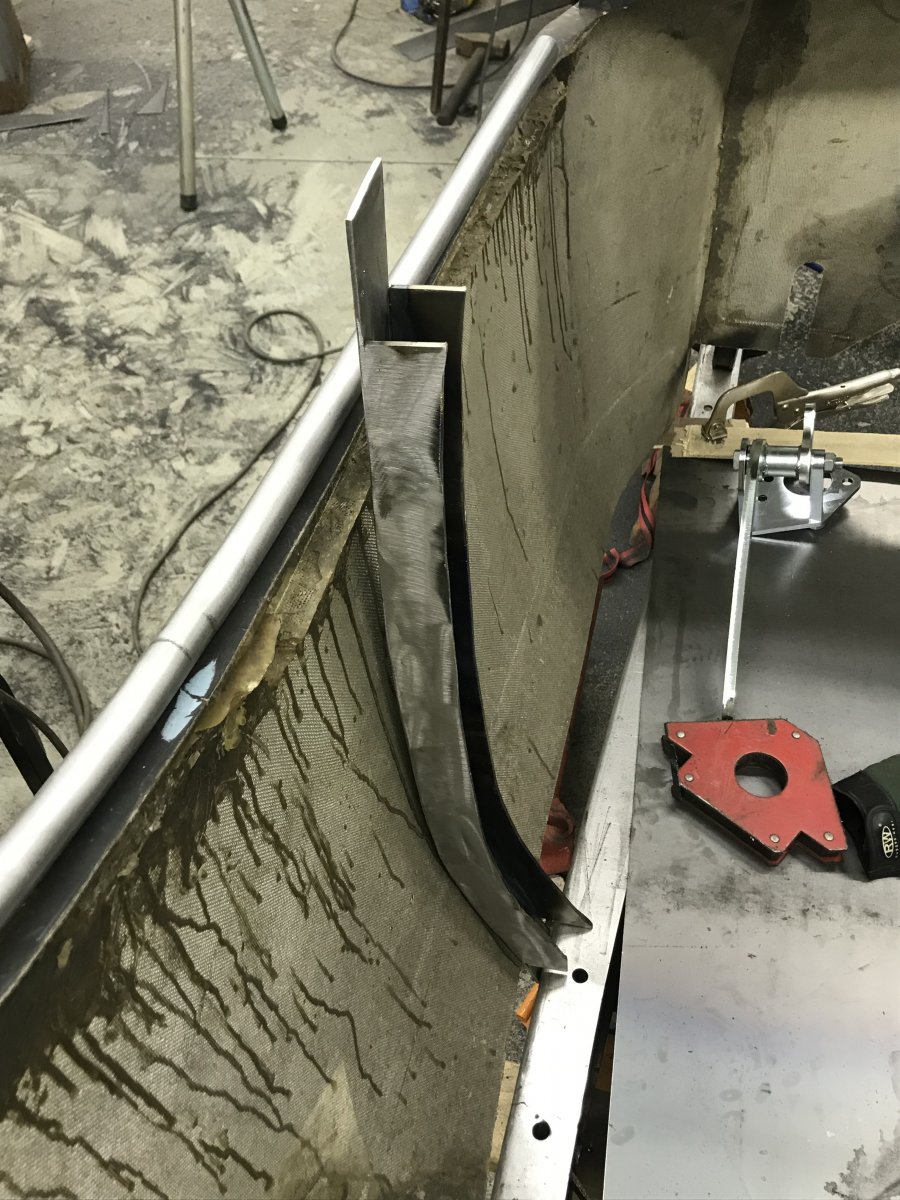

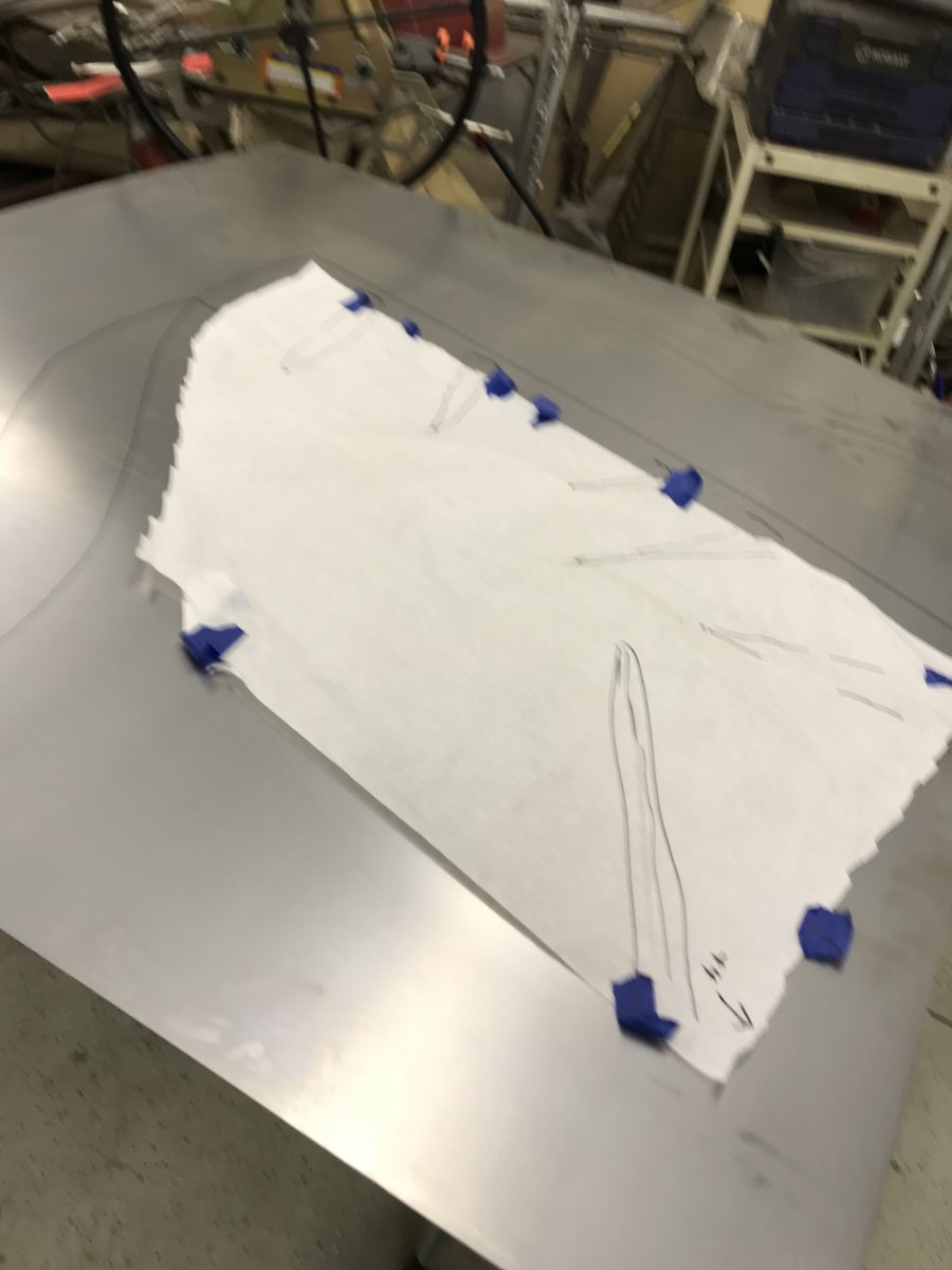

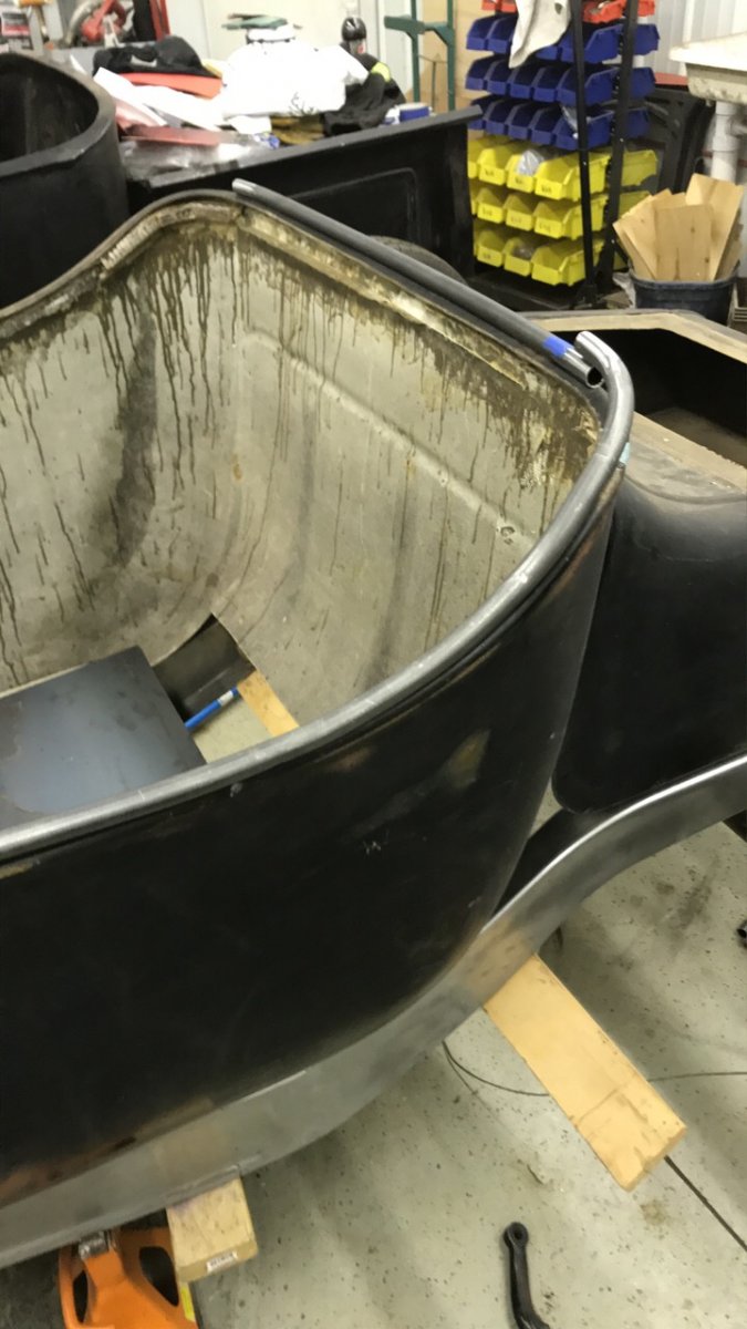

    So I ended up starting to build the basic structure using the glass body as the template. I am going to cheat and use a stock firewall, cowl top, and the center back panel just to speed up the process. I am going make the door openings a couple inches longer to aid in ingress/egress. C4D8E8A8-2932-48C2-9C9E-EC292424366E.jpeg 0945896C-0BC0-49B0-BA96-6F387BAD808D.jpeg 3EDB6192-E0E3-43E1-959C-75D762EDE6D9.jpeg E7D02574-6391-4E7A-850A-39D588790123.jpeg 09A0DF2F-EBCA-4CCA-9537-FD11B51CED41.jpeg 3A5AC6FB-03BA-477F-8524-0A8A62E2C5D2.jpeg 05888E3D-DCB0-4059-95AF-7CB058666CD9.jpeg

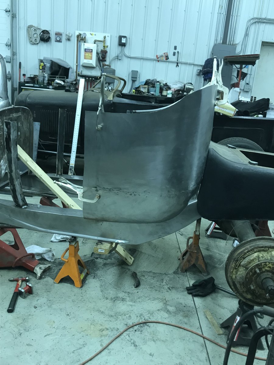

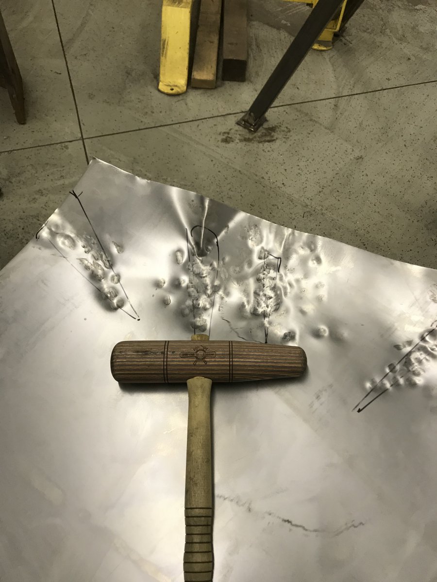

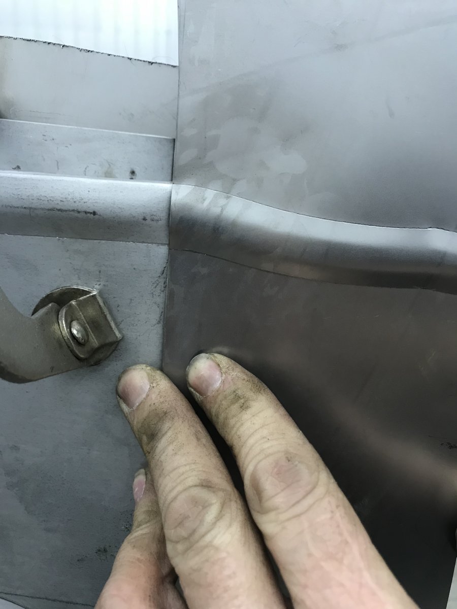

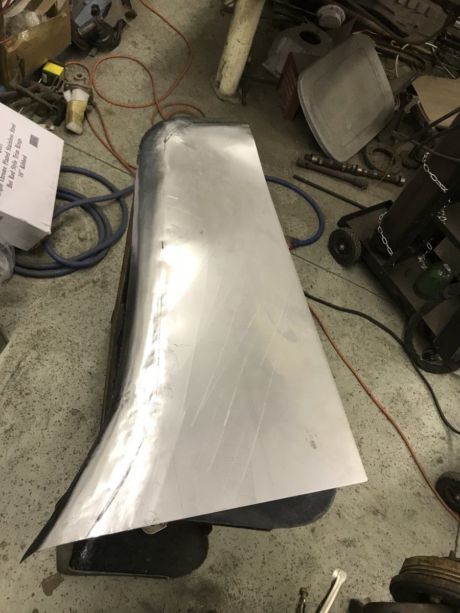

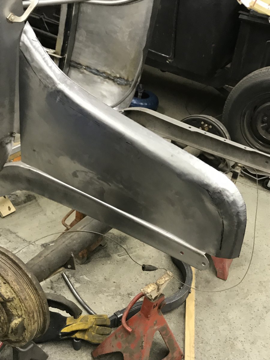

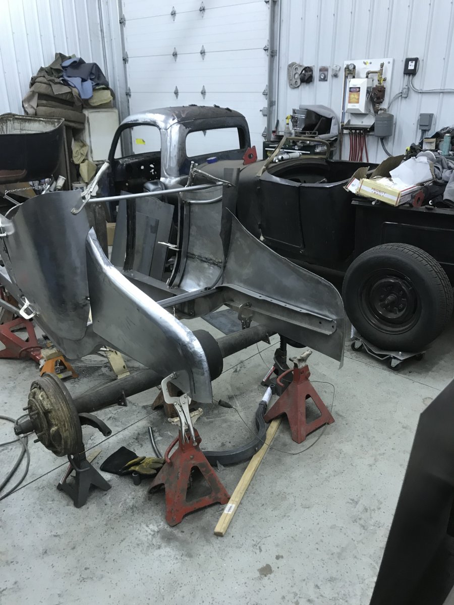

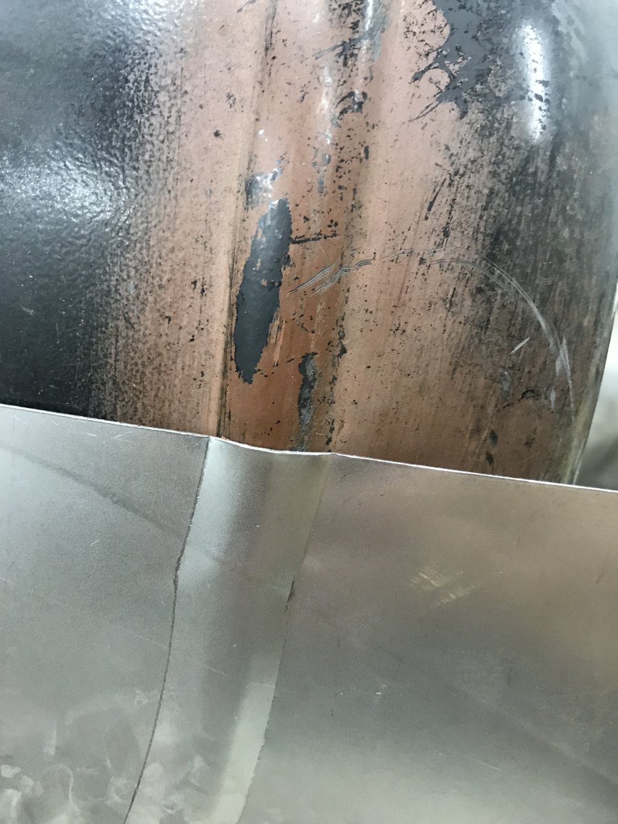

    Once the basic structure was established, it was time to start on the body. Spent a whole day shaping the first corner only to have so much tension in the panel I couldn’t get it to lay right. Instead of walking away, I cut it apart and made it 2 panels. I didn’t even attempt the other side in a single piece but I think I know how I could have fixed the first one in hindsight. The second panel only took a couple of nights after work to knock out. Clamped them to the frame to at least feel like I accomplished something. 31B8309F-41B2-4E00-AF5D-7BC634B4090B.jpeg 98CF1809-AD25-4FE9-933F-6E0685433A27.jpeg AE15B6D4-02B1-4329-8EEE-45036BF10F54.jpeg 0AA9AD9E-BFF8-40A0-A342-9D4D1AA7A90B.jpeg 3D5ACDCA-CE98-464E-B73A-9A00EFB91825.jpeg 2442F334-E5BE-4300-9F59-E54ECCACF030.jpeg 9CCEADC5-EF2F-42D0-BE6B-2A53447F5792.jpeg 054D33B8-28A9-444A-8311-D6B2E86178CC.jpeg

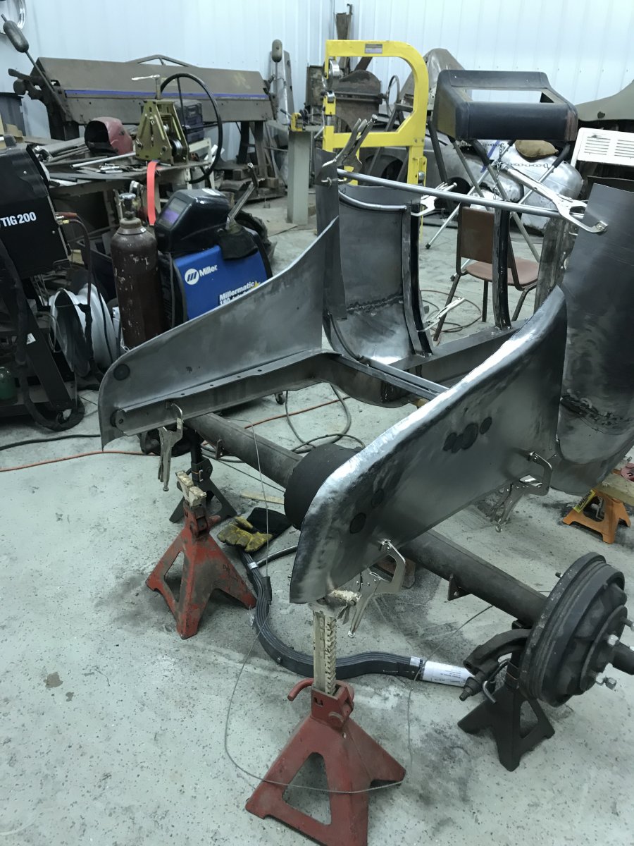

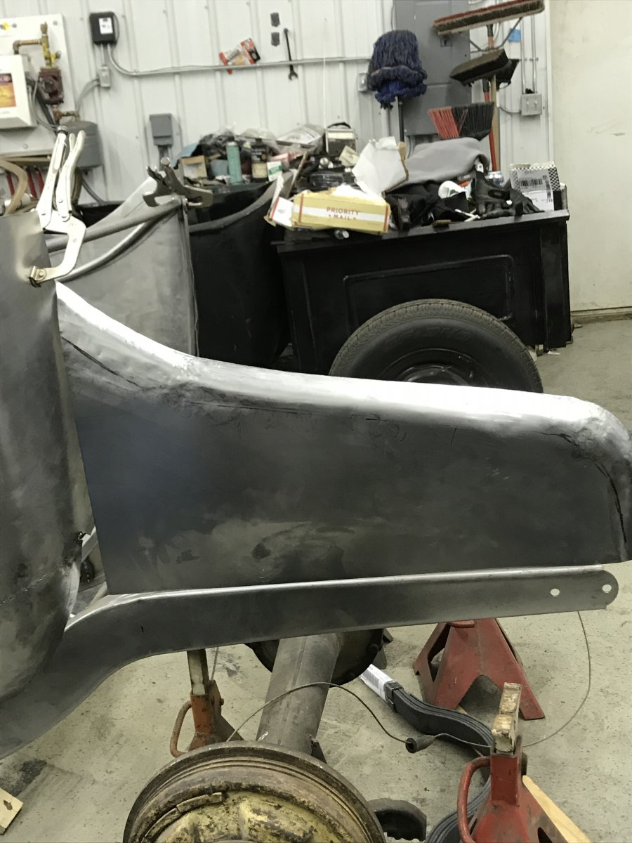

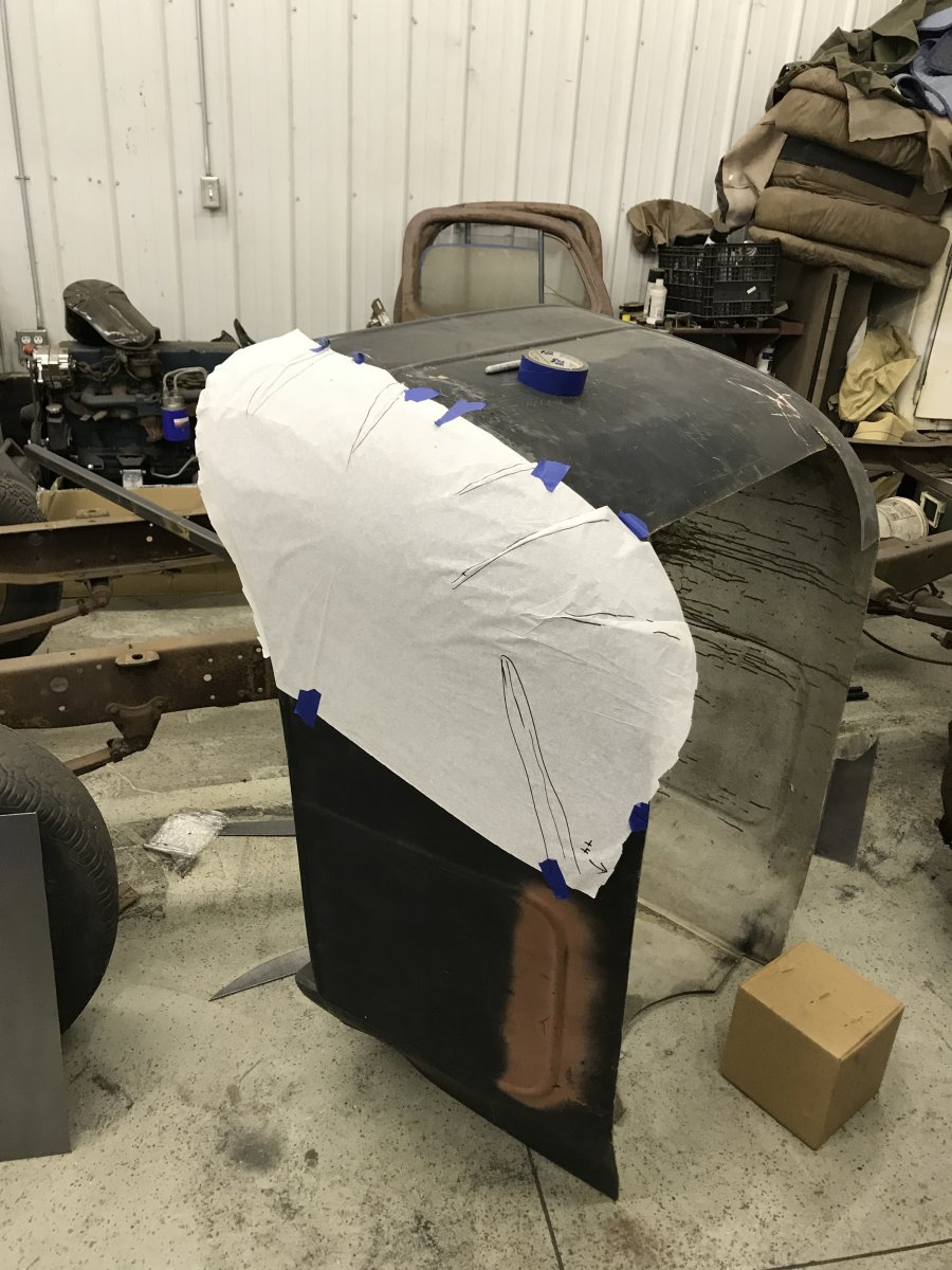

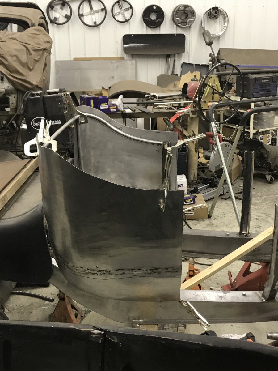

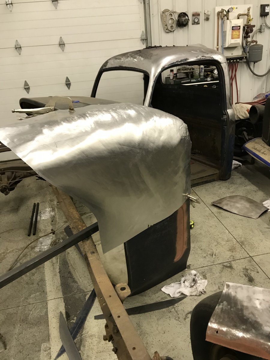

    As I am still waiting on the cowl top, I decided to rough out the turtle deck made the first side an inch off so need to grow it back yet got both sides roughed out but not perfect by any means 23730665-93E0-4A70-A8DA-B45C6D6BC94E.jpeg DB7A9497-6E67-4A94-85EF-25EEDF89DF0C.jpeg 34EBEAD3-E975-47A0-B41B-A5F7632B3A6B.jpeg 151C97DF-91A7-4929-9B7C-DF4779C6A1AF.jpeg 108E9580-CE27-408A-ABD5-17D8B908570E.jpeg

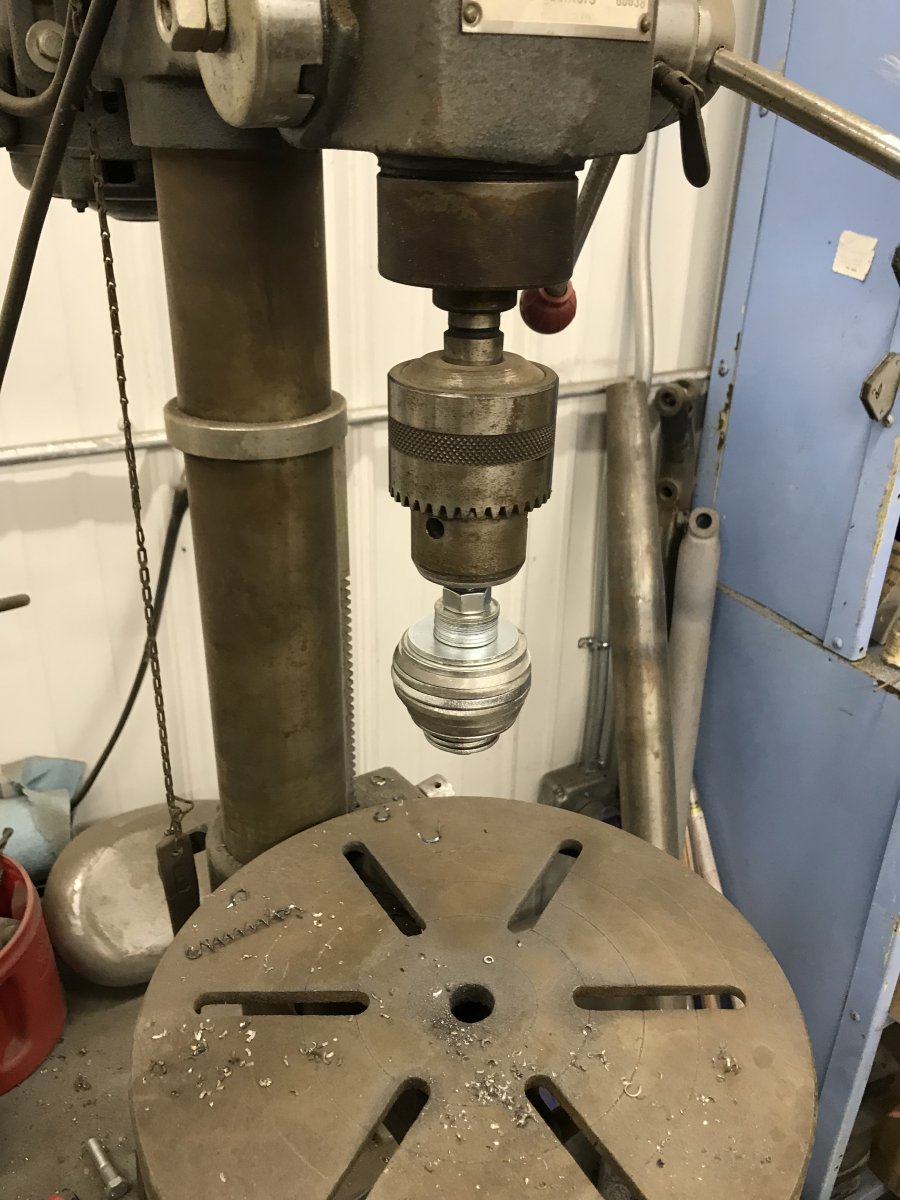

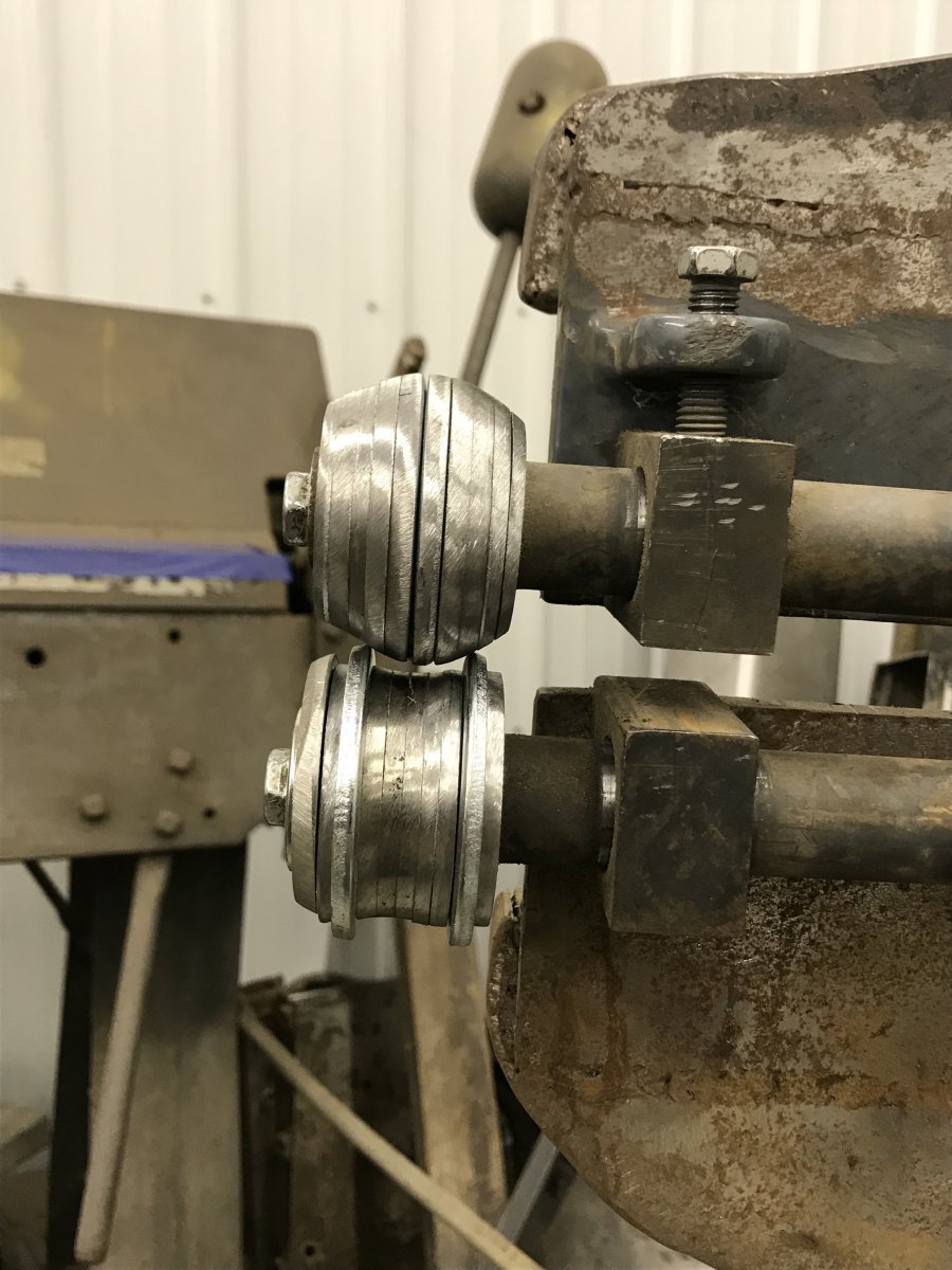

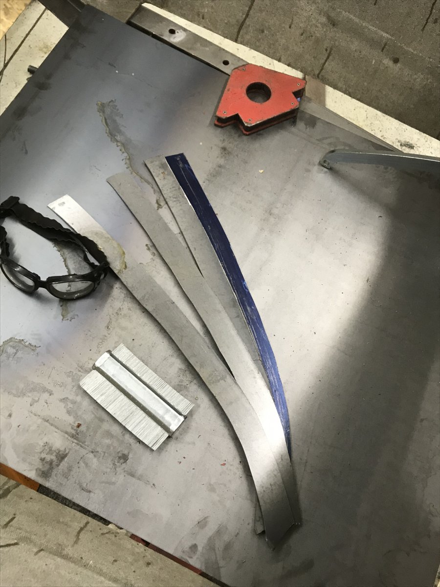

    It’s was Monday night that I realized I had no way to roll the 3/4” wide beads and no one makes that size die for my Chinese bead roller. I asked a question, got an answer, and made my own adaptations accordingly. I now have a cheap die set to roll my beads. Came out close enough for this hack anyhow. 86DFE658-1333-4D9B-89F1-D603E760D86B.jpeg 974FCFFB-26CE-4035-95E0-B31B7CE0008D.jpeg CAF14C26-93C7-4238-9A1E-A7CF51C336EF.jpeg 12F0B022-7D18-45A9-9C11-40EC532803DC.jpeg

    Would you believe that an inch out of the top in the right spot brings the rear rails up to level? Worked out pretty good. I thought I was going to have to do major surgery to make it work. The rails will even fit inside the turtledeck without bobbing them.
