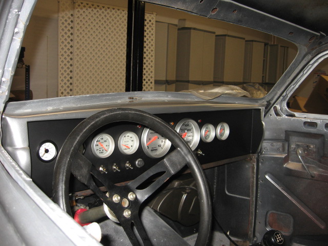

  12. custom dash in my 41 study race truck

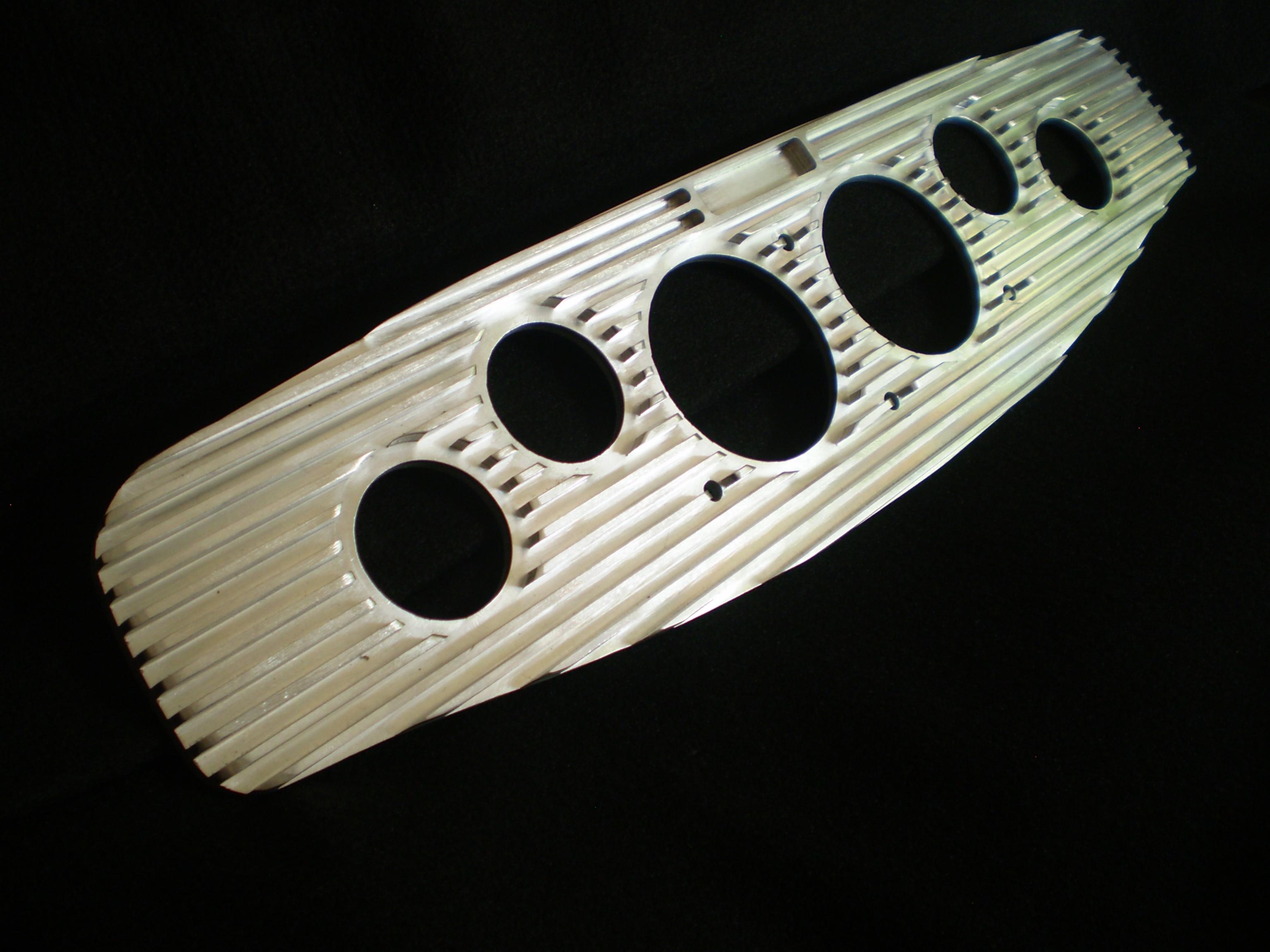

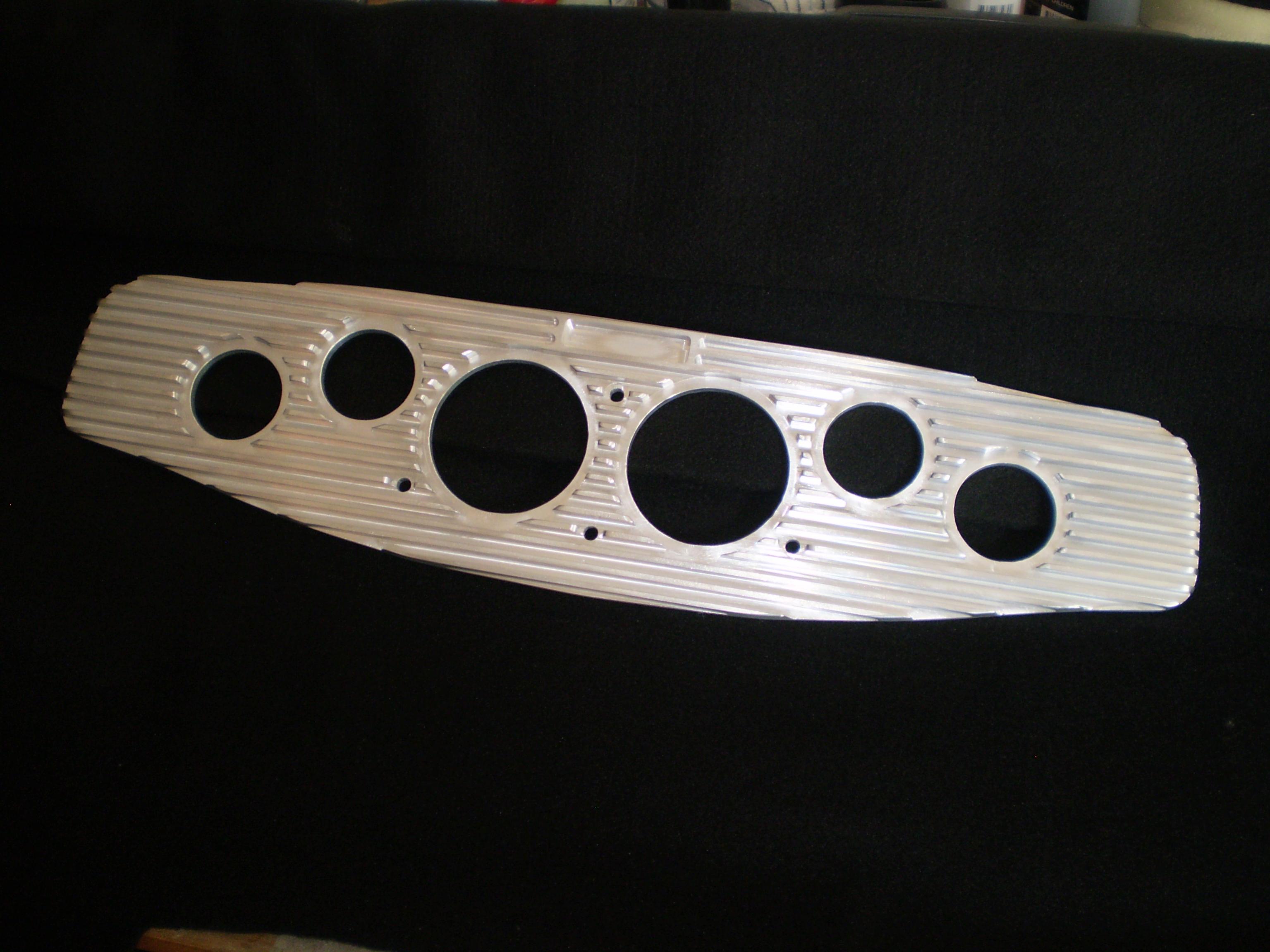

  16. I'll play along. Had a friend machine this at his sign shop a couple years ago. I got the layout idea from the way the Wings gauges were packaged when I got them. It's 1/2 inch thick aluminum with 1/4 inch ribs machined 1/4 inch deep, and the gauge holes are recessed in 1/4 inch to sit level with the bottom of the ribs. then painted with a rough texture paint and then polished the ribs. The panel was made to fit the contour of the dash ( 31 Studebaker ) and it's in my 29 Model A Roadster.

    That's pretty slick.
