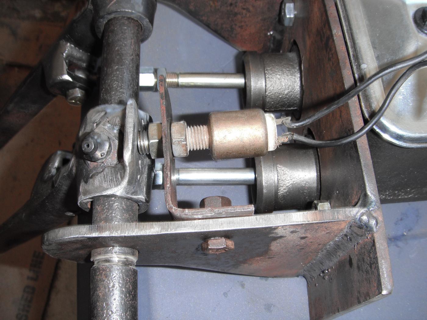

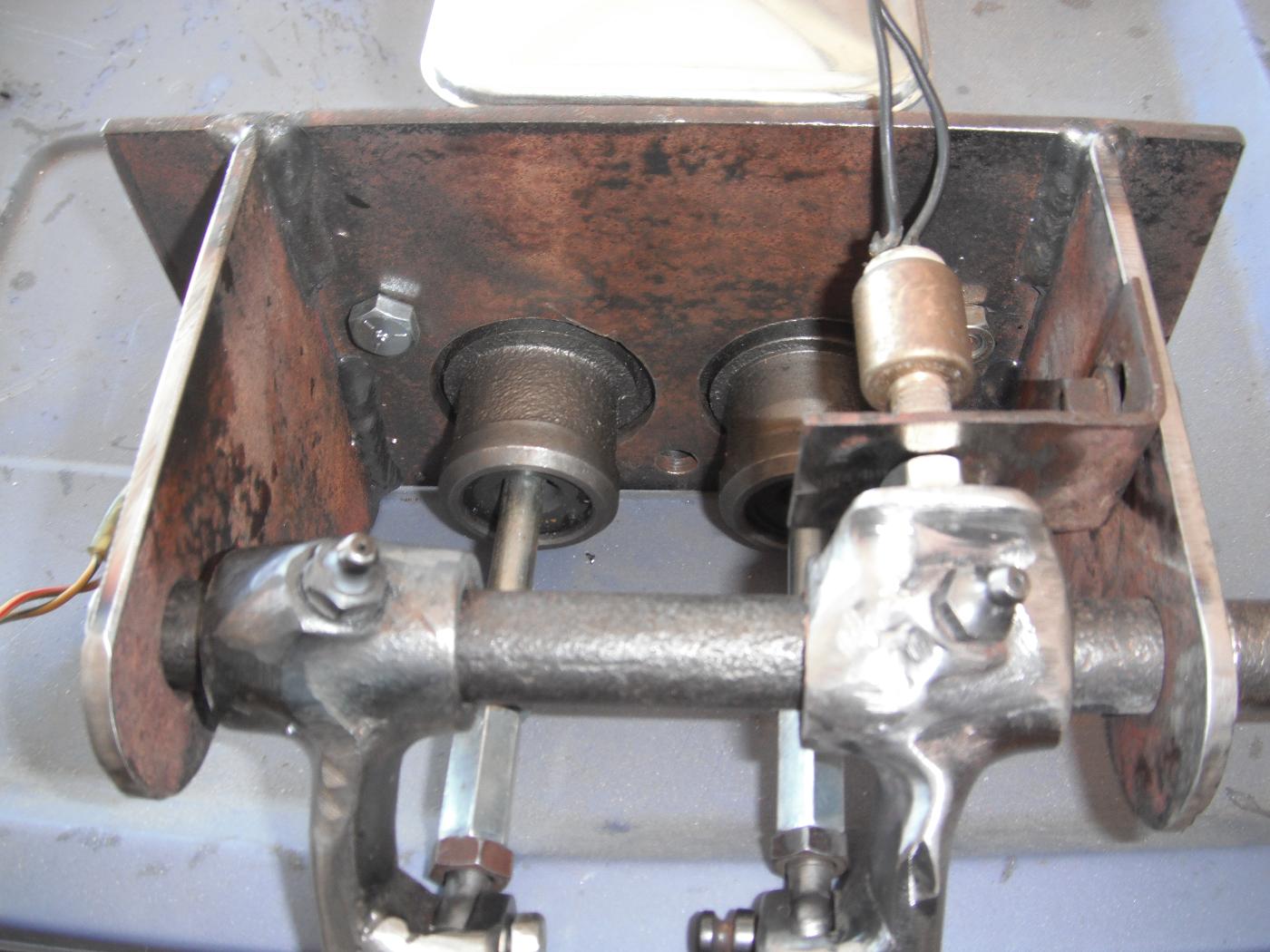

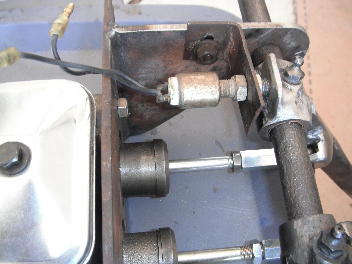

    Here you go, I made a small bracket that the switch screws to and then clamped it to the steering column. I can adjust the switch just by unclamping and moving the bracket back and forth. The bolt sticking out of the brake lever is actually 1/2 out giving the switch arm a place to slide on.

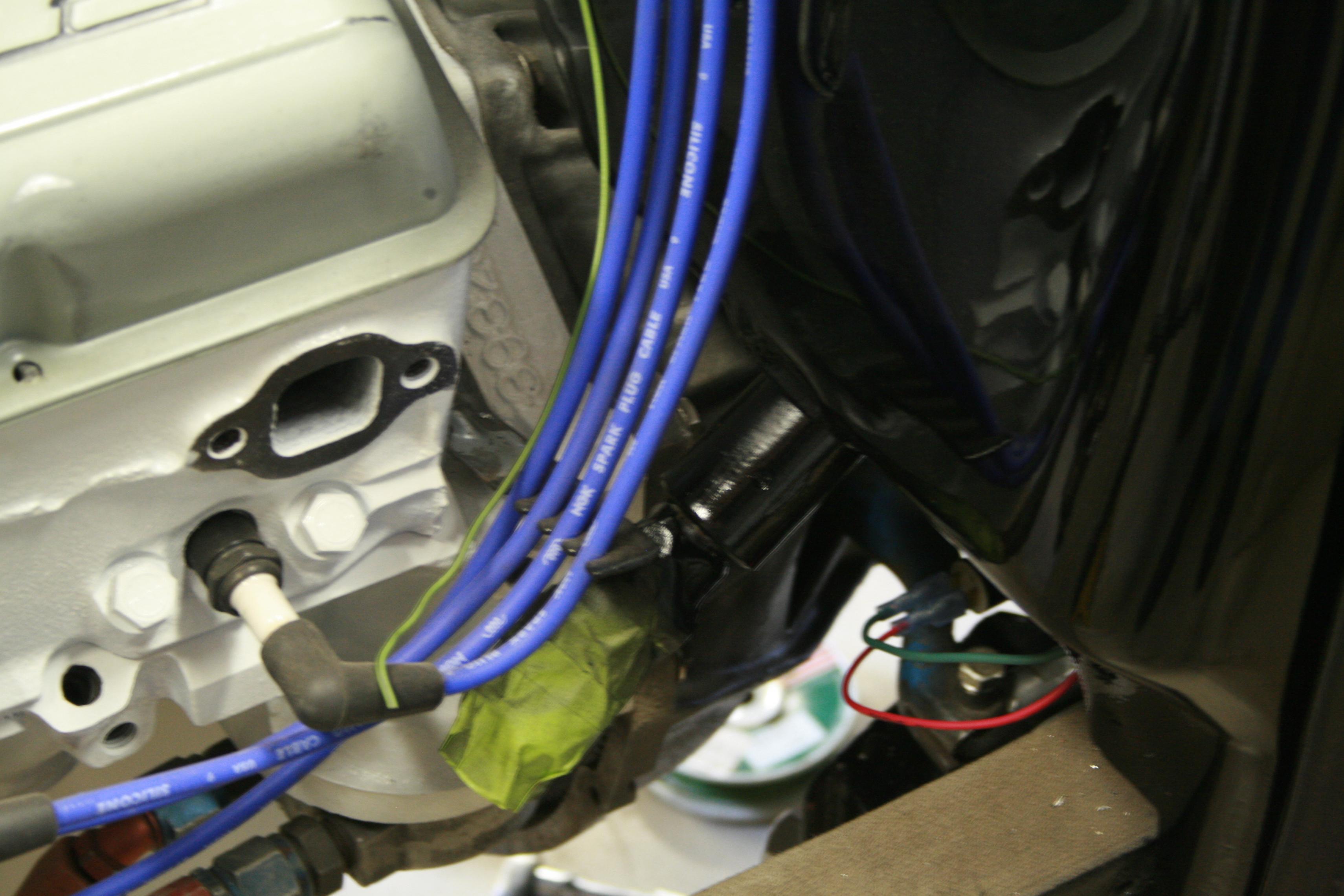

    Was looking at mine today also. Going to use Nissan pickup switch. Similiar to the GM version but metal and poraclien, who would think it wasn't plastic. Pics tomorrow....if I remember.
  11. iammarvin
    Joined: Oct 7, 2009
    Posts: 1,196
    iammarvin
    from Tulare, Ca
    Since no one as posted since, here's what I did....
