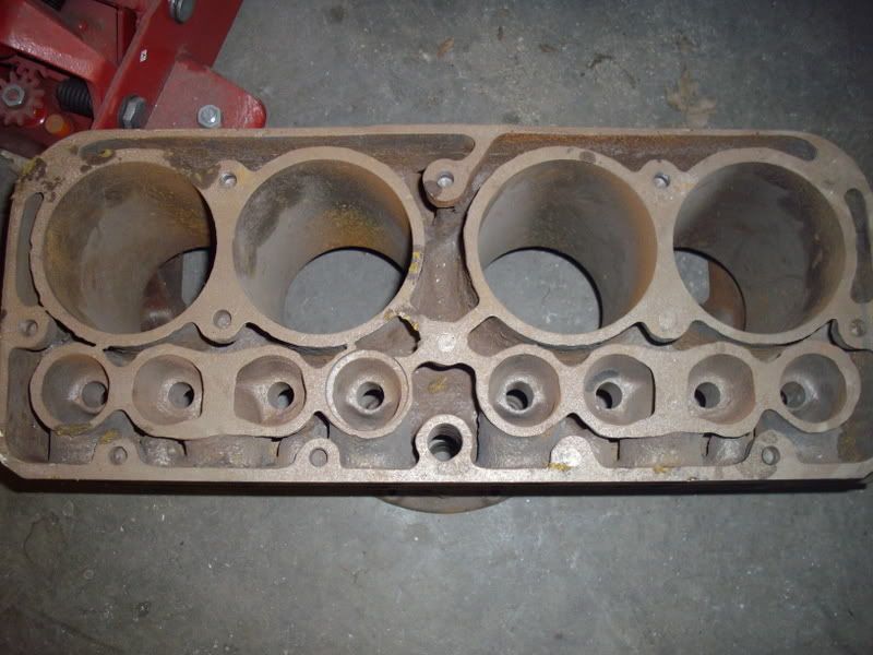

    How much material can you remove in a model a port safely?
    It looks like a big step in the valve pocket area and around the valve stem. I haven't pulled my engine apart, was swapping manifolds and started checking out the ports.. Thanks John

    you can enlarge the intake ports to 1 5/8 with no worries.

    A blocks have quite a bit of meat, B blocks do not. I would use 305 GMC
  6. 4-port Riley
    Joined: Oct 20, 2005
    Posts: 303
    4-port Riley
    A blocks have quite a bit of meat, B blocks do not. I would use 305 GMC V6 valves for exh., just a little bit bigger than stock but would use 1 11/16 for intakes. Get blank valves or cut down Chevy 235 intakes.

    There's a lot of material that can be removed from an A head. As far as valves, 1 3/4 on the intake and 1 11/16 on the exhuast is as huge as you can get in there.
    You can make 140hp with those, plus a few other choice parts.

    be carful with the o/s valve seats those suckers are THIN at the backside of the bowl to deck area

    heres a couple of pics that mite help you...this shows what to big a seat gets you
