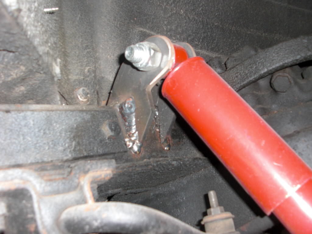

    we mounted tube shocks on the rear of bottom control arm on pop's '47 and made a huge difference.

    Thanks Paul! Do you have any pics I could check out of that?

    The car is long gone, so can't get pics. It's a common practice on the 40's chevs as the upper arm/shock went bad. Maybe someone else will chime in with pics. Paul
    Like this? There,s a company called Cool Cars which sell the bits.
    These pics are not of my car, I would do the lower mount differently.

    Paul55 & 36 roadster, thanks guys!! Pics are worth a million words to me.
