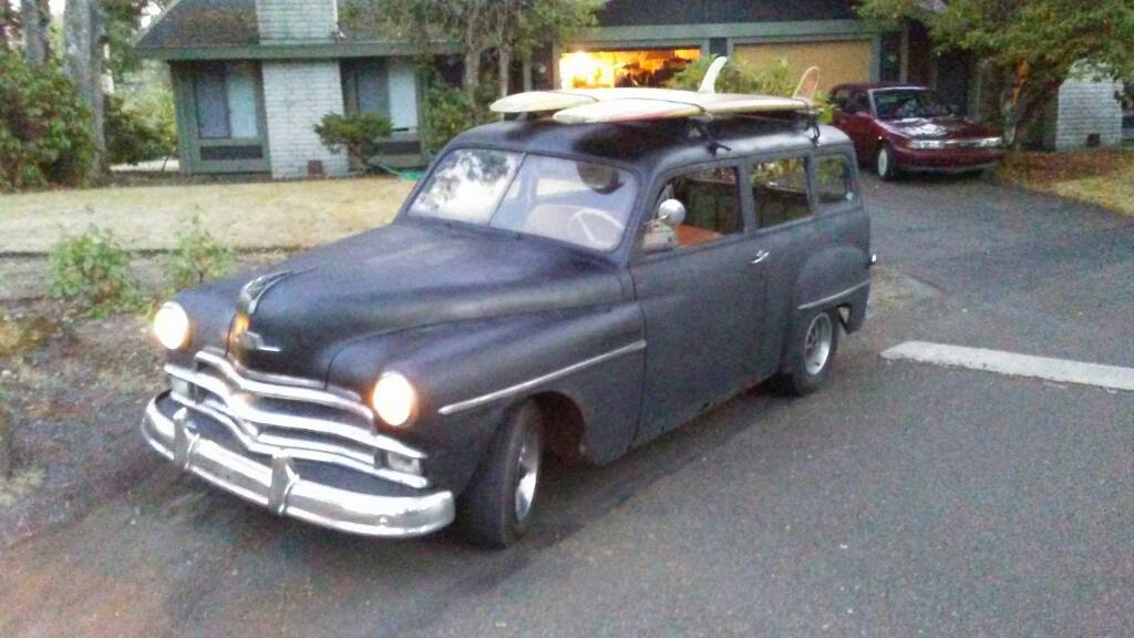

    Thanks 4 All the Help too cooooland here's some pix .... Thanks so much ....[​IMG][​IMG][​IMG]
    Sent from my VS425 using The H.A.M.B. mobile app
  23. slowmotion
    Joined: Nov 21, 2011
    Posts: 3,330
    slowmotion
    Damn, that thing's more than worthy, cool ride!
