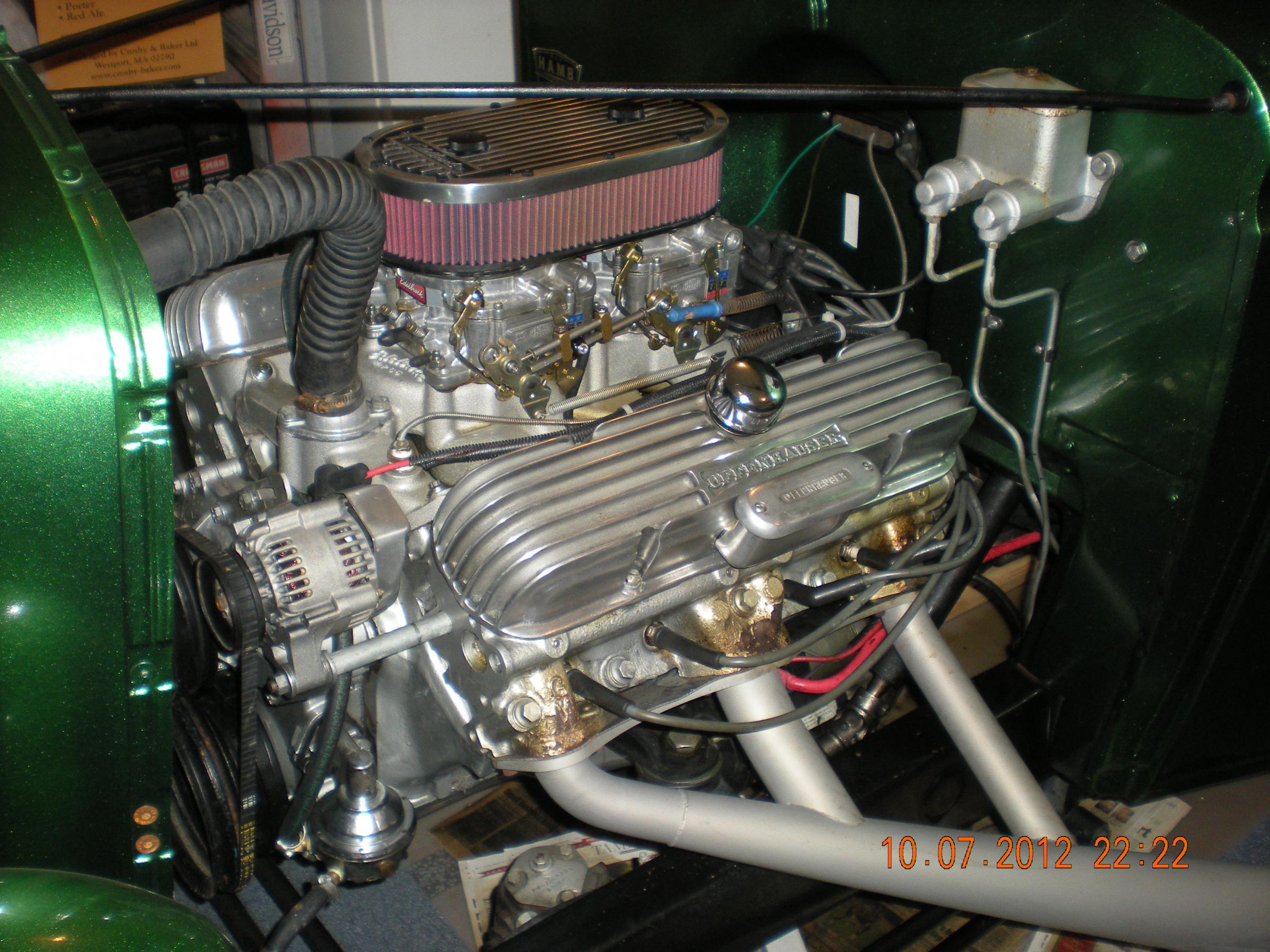

    Hows this 35 chevy pickup, 468 Pontiac and Munci 4 speed.
      514.5 KB
      202

    This car is BAD ASS!!!

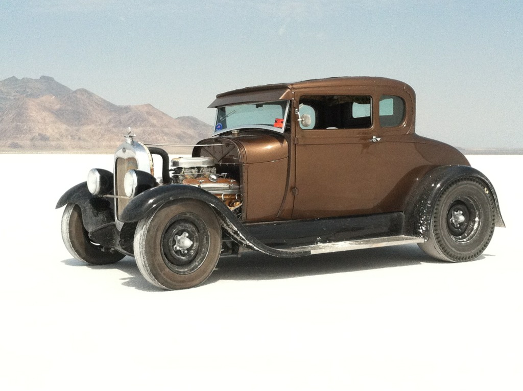

    Not all use belly button engines ! 40 ponti coupe has a 63 super duty 389 and the 2/ 4 barrel engine is a 400 bored to 421 Gary:D
