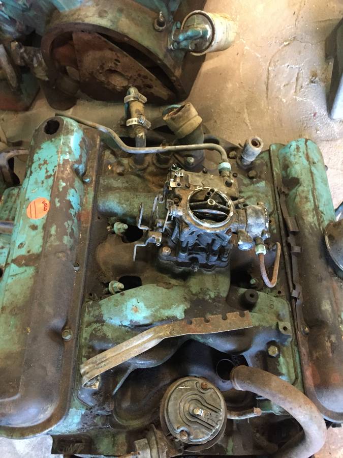

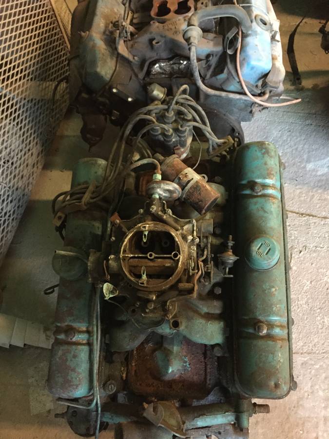

    My son and I pulled out my grandfather, his great-grandfather's 1955 Pontiac Chieftan this weekend from the shed it had been parked in since 1964 when he started going blind. We had 3 generations working all day to get it out...long story tight quarters in a rural neighborhood. My son and I are going to take it on as a project car so I began researching several weeks ago. It appears that a 1959 389 will bolt on to the hydramatic transmission fairly easily. We would like to upgrade to that versus trying to max out the stock 287 and probably still not have the stock HP of the 389. This will be our first project car, and I know some about Ford's as my Dad is a big mustang fan but completely new to Pontiac and my son and I are very excited. Sorry for being long-winded but I found this "Eight classic V8's for sale" on craigslist and they are said to be 50's and 60's Pontiac V8's. As I said above we would love to find a 1959 389 to avoid a transmission swap also. I have read about the date codes at the distributor cap locations and asked him to look at those and he said 3 motors left and the codes were, C118, G229, J169. From what I had read the last number was the year it was cast, but then I wondered could that be 1959, or 1969. The location is a 4 hour drive one-way, and I would like to verify it more before I drive that far, although I think it is a very good price. So my long-winded question is there a way to verify they are 1959's easily before I drive there? I have attached pictures of the original 8 he had for sale so not sure which 3 he still has to see if anyone can ID by the pics. Thanks very much for any help!

    The second and last pics are Buick v8 also known as Nailheads. Good engines, without seeing the casting numbers I can't ever tell the difference between the cubic inches.
    Also on the 3rd picture appears from what I can tell from the casting number on the intake it appears that one might be a 60 Pontiac. Maybe from a bonnevile.

    concur, 2 Buicks and the rest are all pre 64 Pontiacs

    OK thanks guys he said he had 4 total left. Three Pontiacs and a nailhead. So if they are pre-64 the "9" date code should be 1959.

    1959 was the first 389 and the last with reverse cooling, water pumps directly into both heads and then through the block.
    I can see from the pictures that there is likely a '59 engine sitting there, the lifting loop cast into the front of the intake was a '60 and earlier feature and I can see the water pump connections to the heads. If the block date code shows it being cast in late 1958 or up to about August of 1959 and the head casting number is 531395 on the two center exhaust ports (1959 389 only) you're golden.
    Here's a link to my thread showing a 1959 389 in detail:http://www.jalopyjournal.com/forum/threads/1959-pontiac-389.996461/
    Just now saw one of the 2-barrel engines has the correct casting number for 1959 on the intake manifold - 532119.
    Go get it. Get a couple of them, there's likely more than one '59 389 sitting there.
