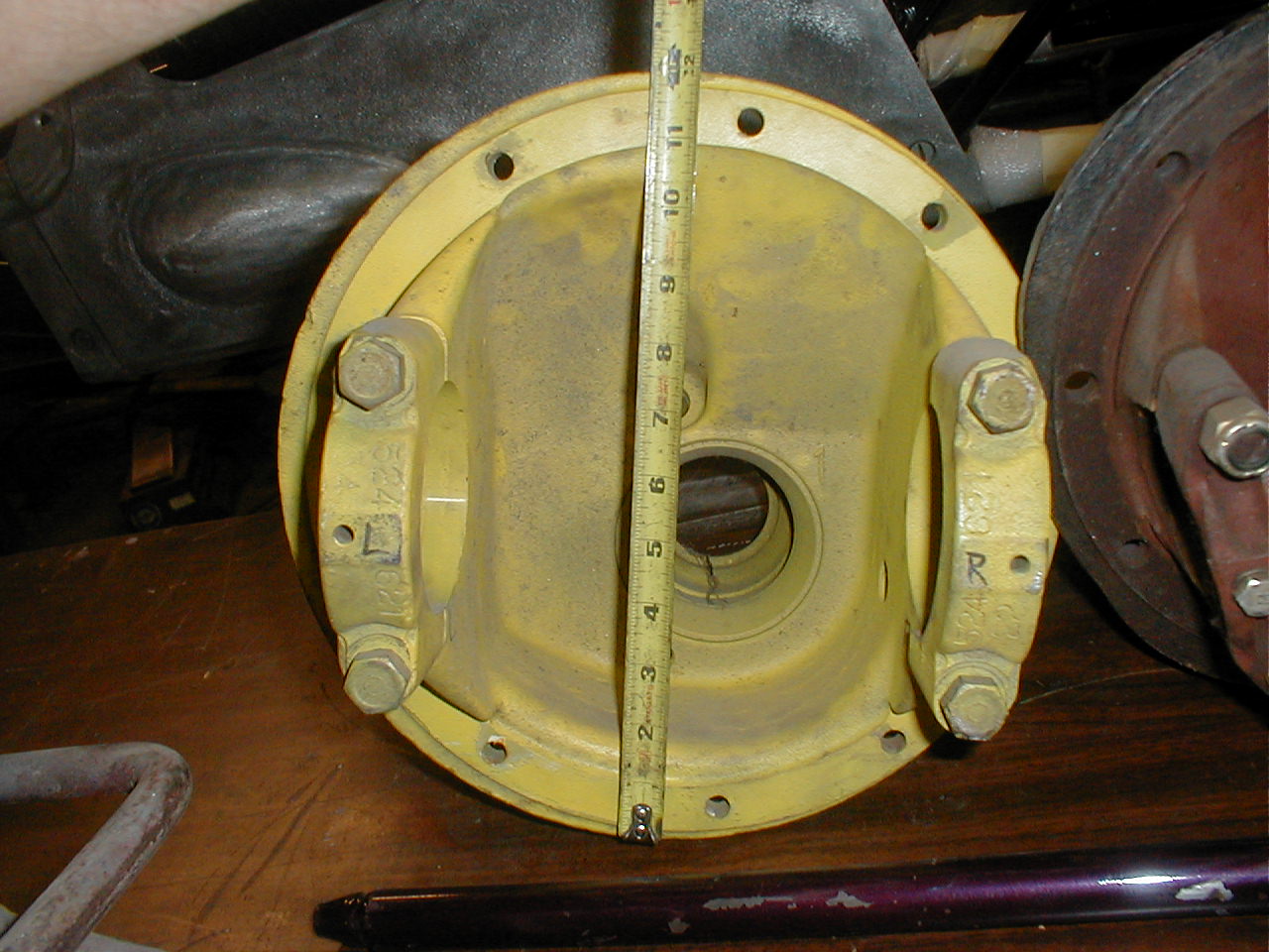

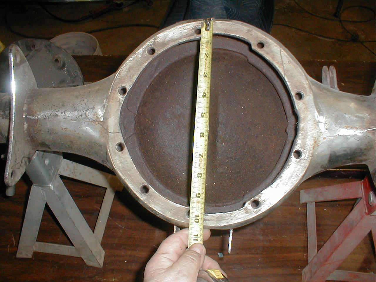

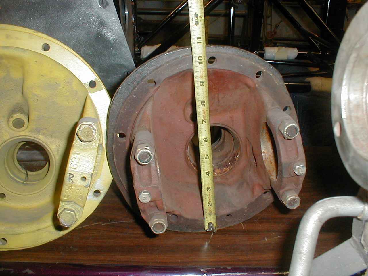

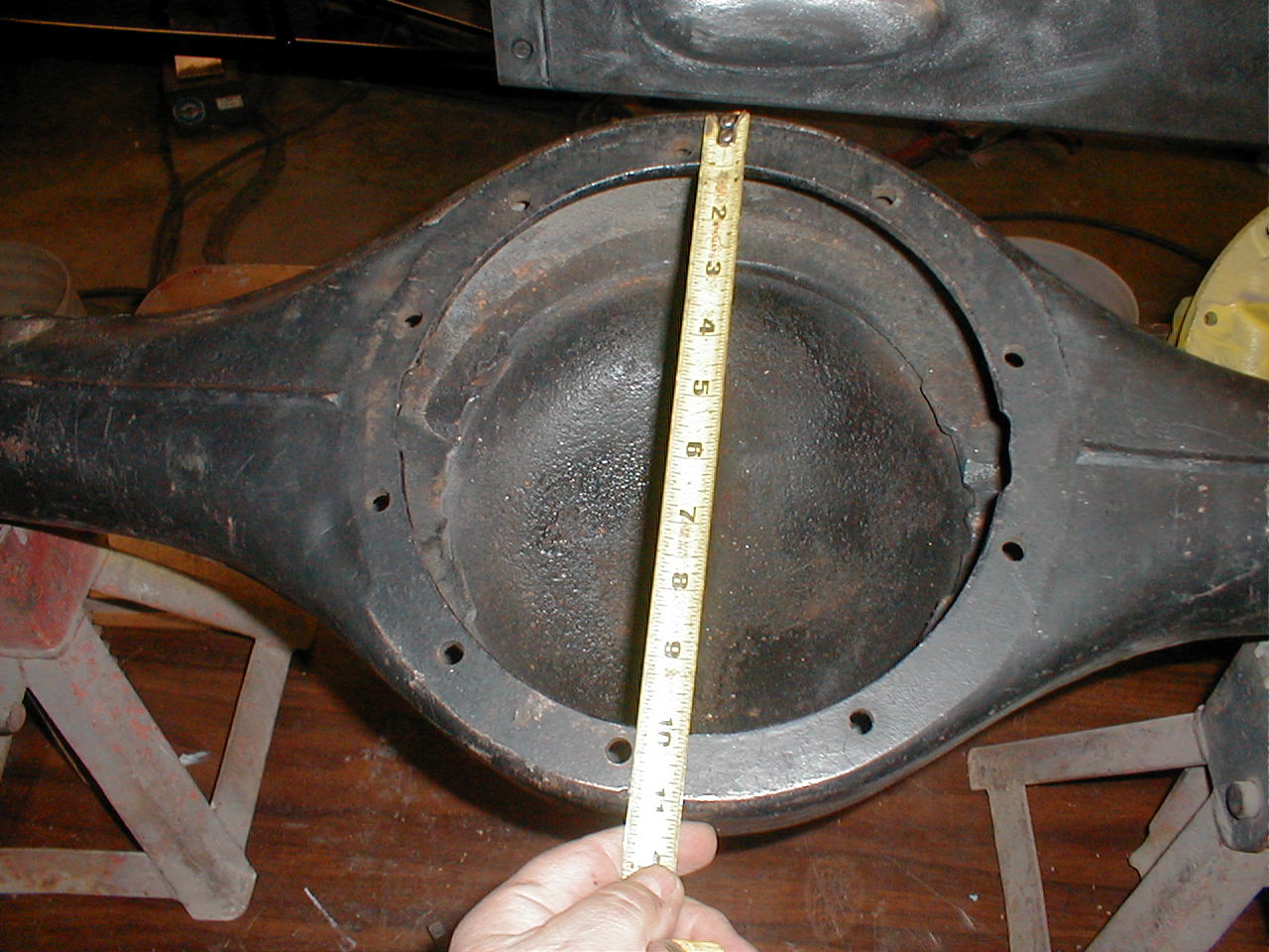

    I got this dragster rear end off E bay. It was described as 54 56 olds. When I opened the box I knew it wasn't 54 56 and brushed it off as 57 up. Later I tried to fit a 57 third member in , No go. A 56 type that I have with a 10 spline spider set. is loose, See photos. What have I got? Not a Ford 8" or 9" as they both have a flat spot on the housing. Not Mopar they have two bolts close together at the top. Not Chevy as they are slightly oval shaped
    The black housing is the one in question at 10-7/8" diameter.
    The silver housing is a early 54-56 type. The yellow third member is 57 -68. The primed third member is 54 -56 that had 10 spline spiders.
    dwrfab Don Ross
