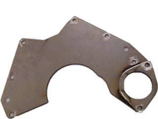

    I wouldn’t do much until you get your block back and get a chance to try fitting your bellhousing to it. If the dowel pins fit and it is aligned with the crank, you may be able to elongate some holes or make a template for a thin adapter plate and have it laser cut (like the BOP to Chevy and vise versa adapters).

    I think my best option may be to find an old scattershield for a 61-63 bolt pattern. It looks like a couple companies may have made them….. Anyone have one hiding?? Shoot me a message or call 603-454-5656

    Water jetting would work and is reasonable in cost.
