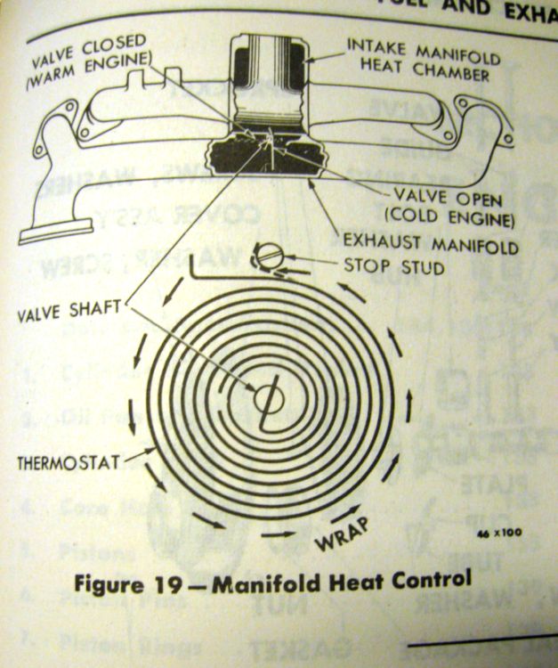

  5. Ahh almost forgot, I want to know how the heater valve in the manifolds work, what is its purpose as well

  7. Here's some text and an illustration of the valve I think you are asking about. I put Langstrom headers on mine and had to install an adaptor to run hot water to heat the carb. BTW the flattie sounds GREAT with headers.

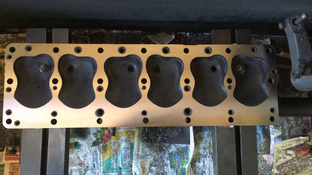

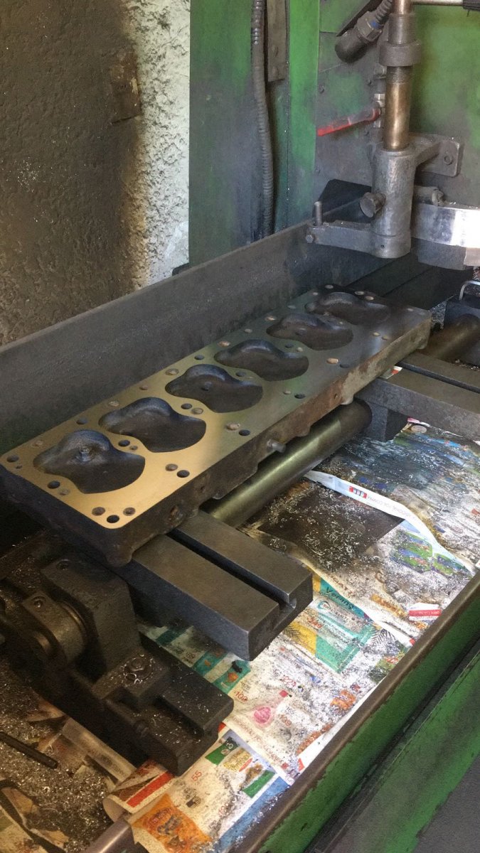

  19. Well apparently based on the information I collected from the hamb and p15d24 forums my head was at stock height, anyways I measured the space between the valves and the chamber. Decided to mill the head .050. Valves are not closing properly so I must work on it today that's my free day, already got head and exhaust intake gaskets.

  23. head is ready, more updates about the engine tomorrow. The guy that milled the head couldn't go further than .025 and that was fair for me, I'm searching a carburetor duo for my new dual carb intake and 3/3 exhaust manifold, what would you recommend??
