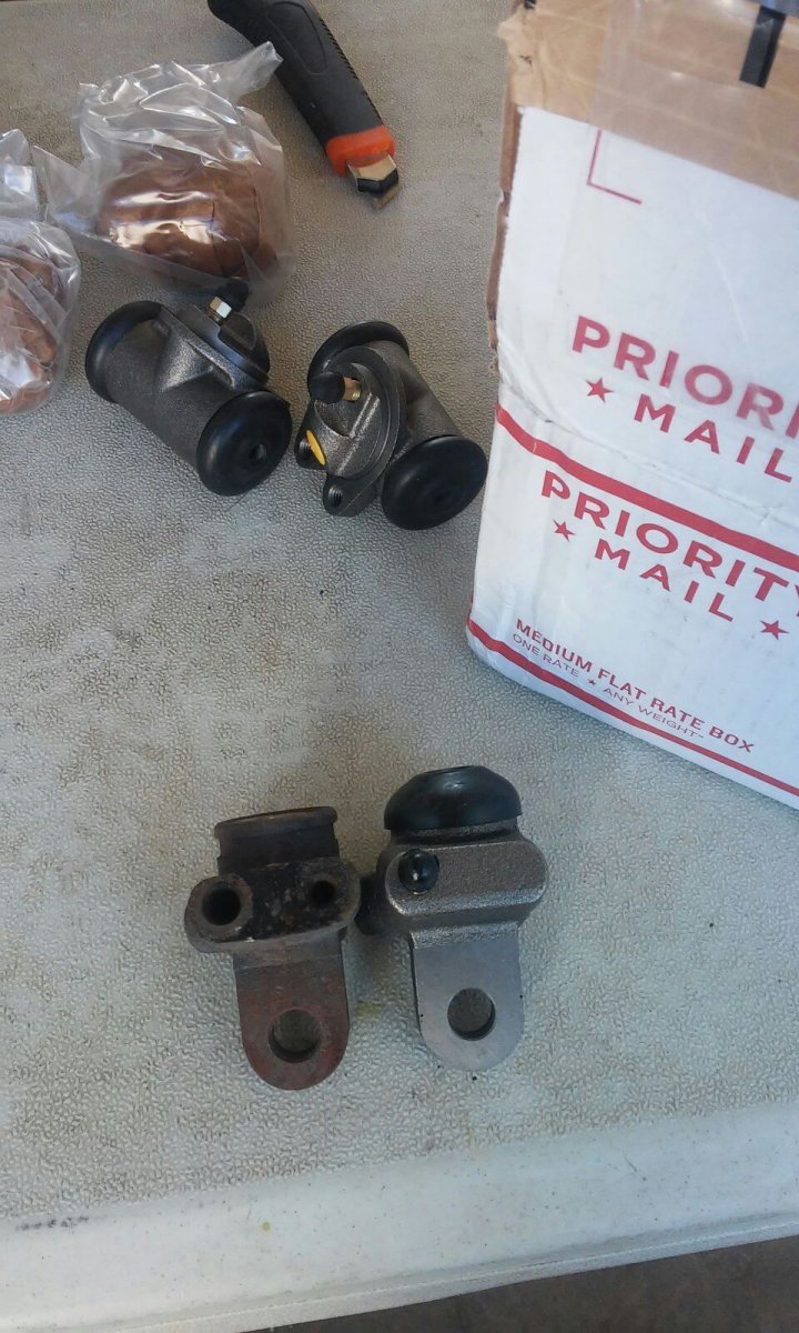

  5. Finally !! I got the wheel cylinders from oldmoparts.com , some updates coming soon ! can't wait to drive the plymo haha.

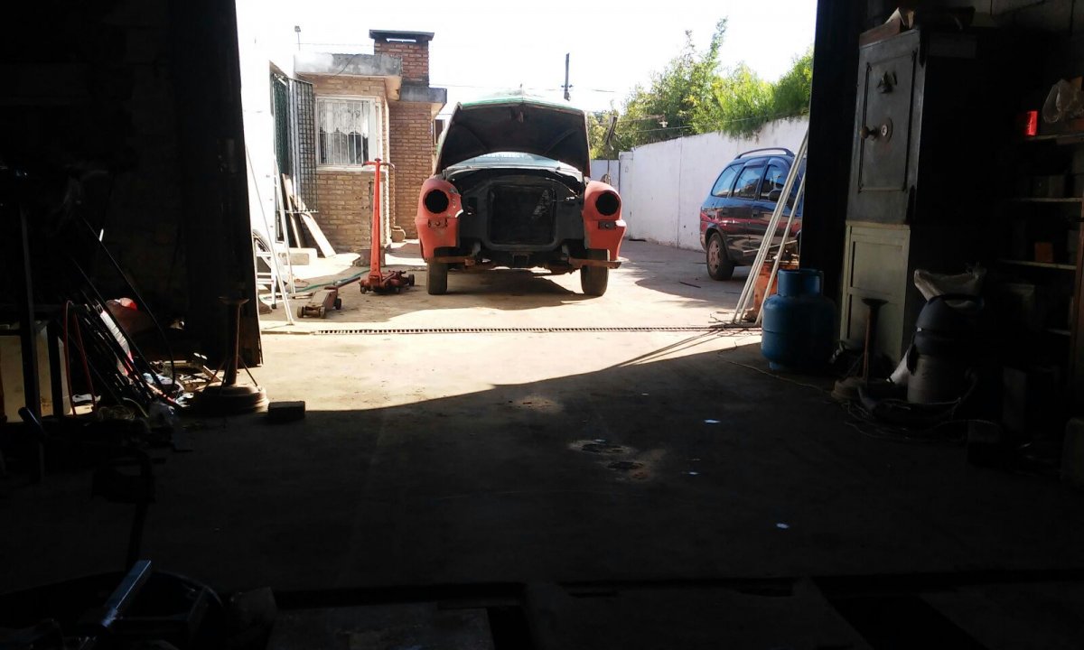

  8. Well here there are some more photos, these were taken yesterday. Now I got brakes finally, working on clutch linkage, gotta finish the floors and start testing the car for a 300 miles road trip to the kustom kulture weekend in Punta del Este next 17 of feb. 20160101_000043A.jpg 20160101_000138A.jpg 20160101_000424A.jpg

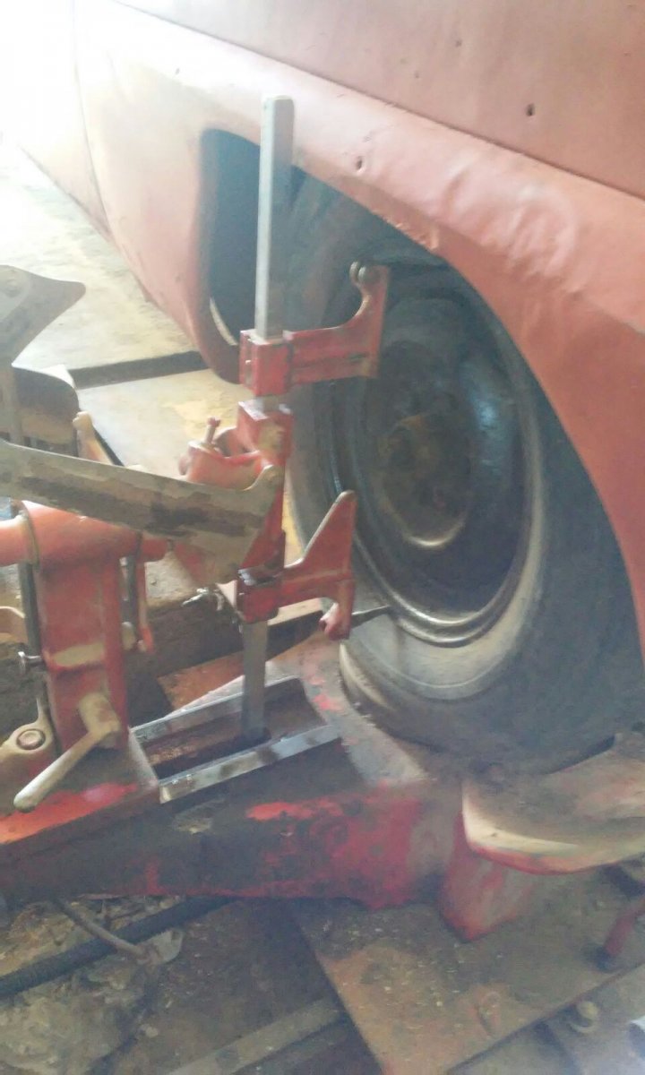

  9. Finally got to drive the car few blocks, I love the sound of the flattie although it has no exhaust and it's way too loud. Got a problem with front suspension, right side is taller than the other, I think thats due to a larger spring in that side as it seems tighter. This weekend I will tear it apart and see what happens, any advice on that?

    The most likely problem is the side that sits lower has a broken, or weak coil spring in the front suspension. I have also seen the spring pocket in the lower control arm rust through or the part the holds the spring break loose from the lower control arm.
    If one of the coils is broken off the spring, you can cut the same amount off the other front spring and put both springs back in and the car should set level. If the coil spring is weak, you will need to replace it. Here in the states a coil spring from a Ford Areostar mini van will fit in your Plymouth, I don't know if you have such things there. If the spring pocket is bad, you will have to repair it. Gene

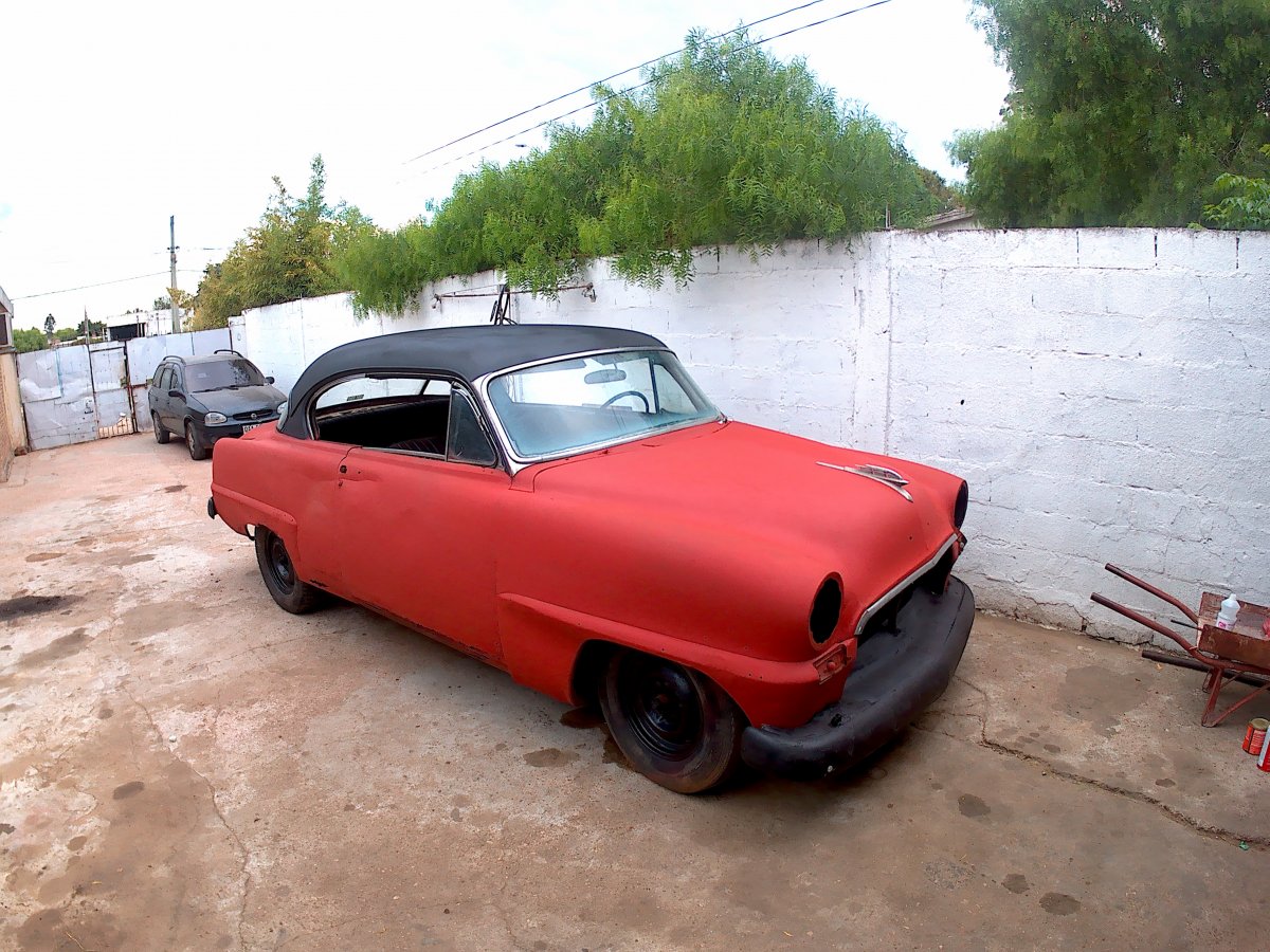

  12. Thanks Ray ! It is a bit uncomfortable to see through the windshield, I can't get another one right now but that's part of the to do list for sure, thanks for you knowledge I really appreciate.

    Today I will check that, the car had a crash on the front and my speculation is that they didn't find a matching coil spring, but I'll only see that when I disassemble it. I think I know where there is a van like that it's good to know that. Thanks for the info Gene.

    Good advise by Gene.......also as you tear down the front end look for any damage to the frame and suspension parts ......you said it was crashed at some point?
    Bent parts can cause it to not be level. Maybe also measure the wheelbase from side to side.

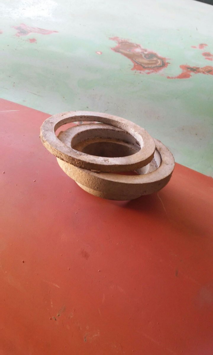

  16. You wouldn't believe it but the taller side had a national fabrication spacer which the other didn't haha. Just took that part off, assembled the suspension again and the car is sitting right now!!
    dwollam, Peanut 1959 and RMR&C like this.
  17. This is the spacer and some more photos of today. I'm really hyped that the car moves by its own means and I don't have to push it anymore in the shop haha ! WhatsApp Image 2018-02-03 at 14.23.29.jpeg WhatsApp Image 2018-02-03 at 15.19.50.jpeg WhatsApp Image 2018-02-03 at 16.36.10.jpeg WhatsApp Image 2018-02-02 at 14.46.47.jpeg
