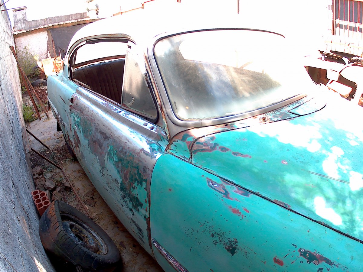

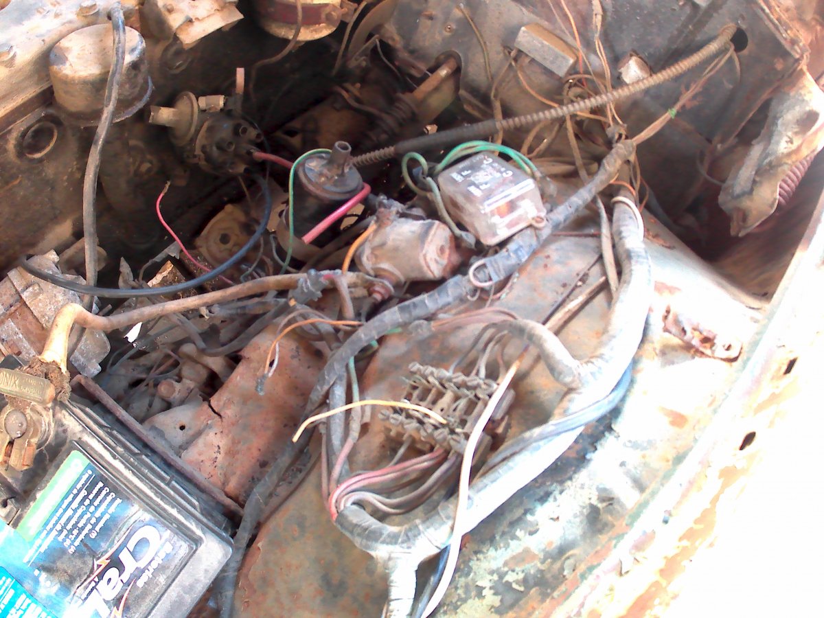

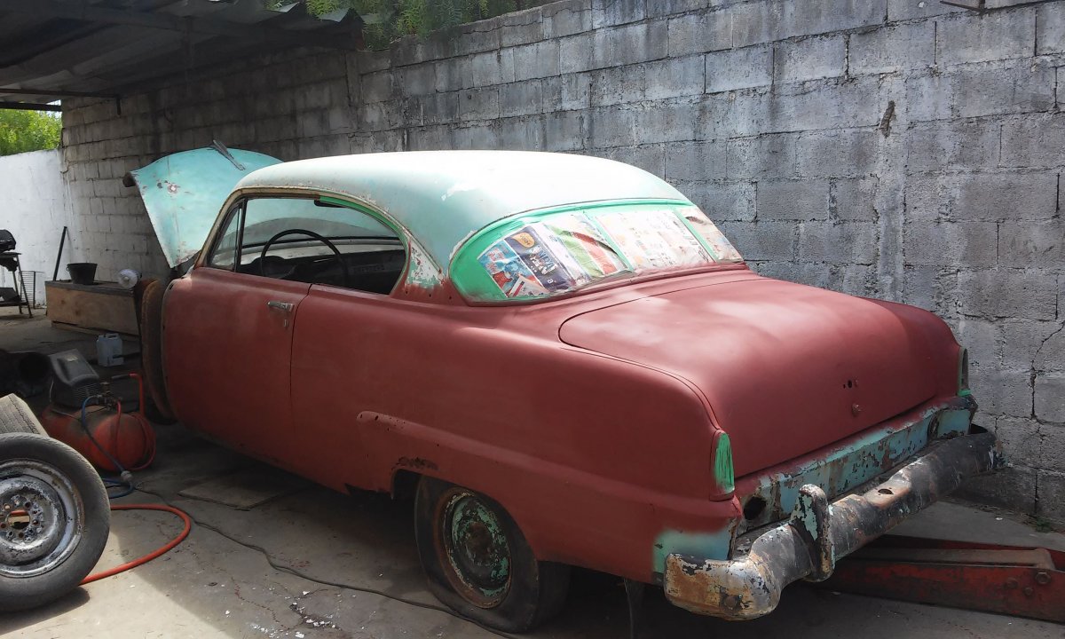

  1. IMG-20171014-WA0028.jpg IMG-20171014-WA0029.jpg IMG-20171014-WA0027.jpg Just got myself this new proyect in the shop yesterday, I'll start with the metal sheet soon. It's been sitting down for more than 6 years. It has a 218 or 230 flathead six with overdrive.

  3. I want to build a nice cheap street rod, but first there's lot of metal work to do, I'll use the original flathead 6 for a while and then maybe switch to a v8 when it gets more solid.

  10. I'm from Uruguay, people regard this country as the south american Cuba, but anyways people sold lots of cars worldwide in the 90s so it's gonna be hard to find parts, there are lots of 4 doors, never seen another hardtop like mine but I guess most parts of 4doors might do the job. Any information on were to buy new or used parts in the states that ship to UY are welcome.

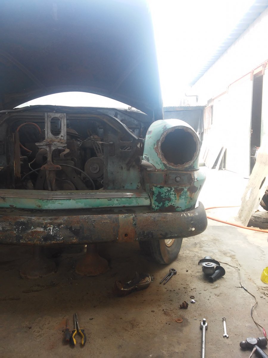

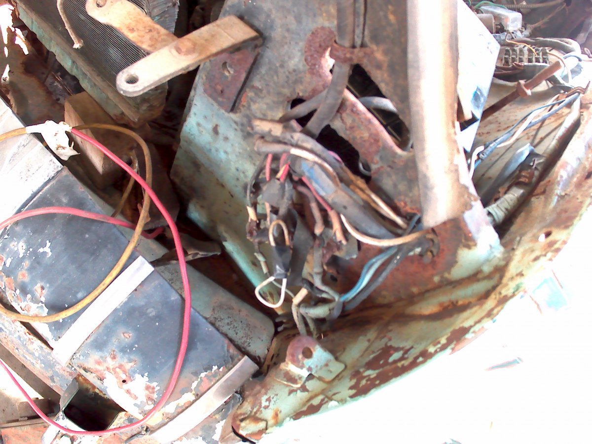

  18. Update: Took off the seats and interior panels to repair the floor metal, Also working on exterior taking off the paint, bondo and some fiberglass somebody thought was a good idea to repair the car :( . Found out that somebody put larger spark plugs which had hit the cylinder heads, thankfully it's not badly damaged, tried to start the engine but instantly caught fire on some cables, lots of useless cables, I'm gonna take all the electricity off and start from the bottom. Got some provisional tires from the trash bin hahah. I'm setting a first deadline to make it run for a car meet in December, and then a second one in February for a major kustom event held in Punta del Este, Uruguay. 20171019_011419A_snap.jpg 20171019_011443A.jpg 20171019_011449A.jpg 20171019_011452A.jpg 20171019_011513A.jpg 20171019_011521A.jpg 20171019_011542A.jpg
  19. Today I started the old 218 for the first time in I don't know how many years, the sound its precious I can't believe how little work I had to do to fire it up. Just made the sparkplug cables, some cables that were really bad in the distributor, not even cleaned the carb which I'm doin tomorrow, I just put some gas on the carb (no gas tank yet) and it is alive !! This week I will start with the electricity and maybe weld some floor panels so I can reassemble the interior, hoping to get it runnin for that car meet in december.

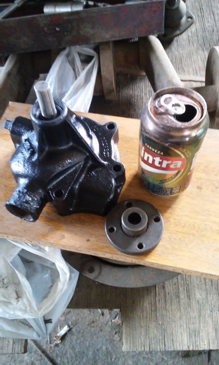

  24. As I couldn't find any replacement for my water pump I decided to repair it, I bought a new axle with bearing and modified the pump so it fitted. Also I teared the front end apart and sanded most of the car, still lots of metal work to do but at list it won't get more rusty as I threw some premier on it.
    Have you ever used a beer tin to fit something?? haha because Roadkill.

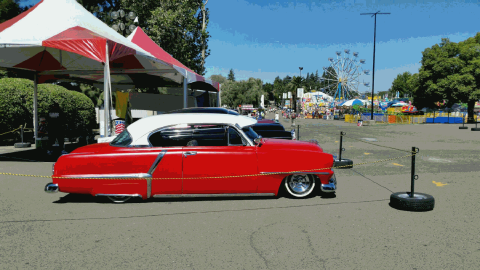

    My friend from Sacramento owns this one.

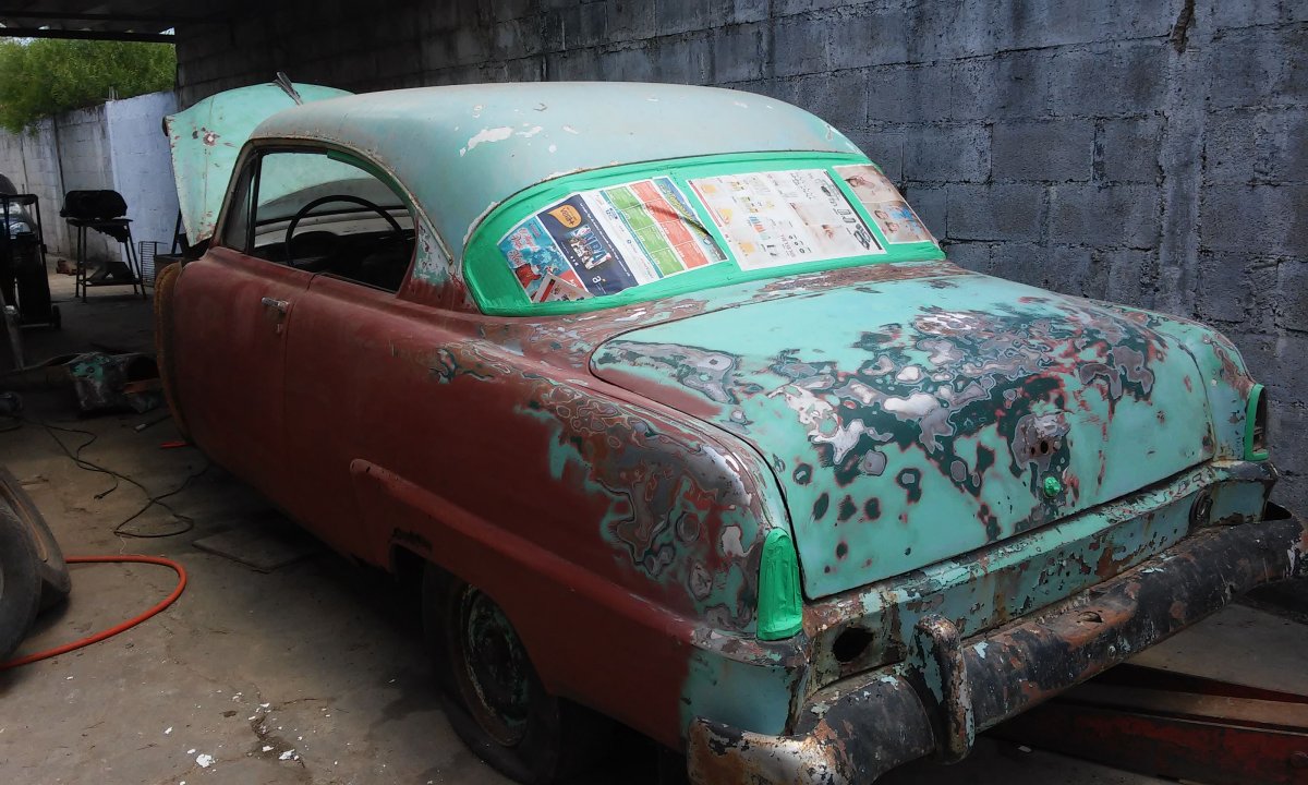

  29. Ahh almost forgot, these are the car photos ...
    chryslerfan55, AndersF and Hnstray like this.
  30. I have seen some of those export cars around, can't really say this is one because there are brochures from that time that show my car exactly as it is, but maybe some day I figure it out.
