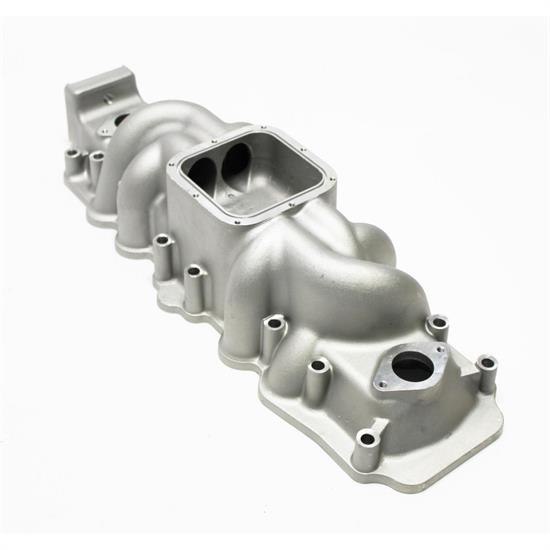

    For a medium to large cube motor and higher boost levels (say 10+ lbs), having a bottom like the one that Tom Roberts designed might work great. I contributed initial funding to help this project get under way - but have yet to put my manifold on an engine. Another 'future project'! Arggggh!
    This is the same manifold bottom that Magnusen then used. BUT - it is going to make an extremely tall package and I believe would work best with a big engine and a big blower (on the street). Notice how the runners for a sort of 'cross ram' effect at the center of the plenum - this makes a lot of sense to me (for port velocity).

    If I were building one...it would be the top one in post #5. Longer runners..! Though the second one in post #5 is also plenty good.

    Dale, I can see that manifold being ideal, especially in a bigger high rpm motor. larger tapered ports in the manifold. looks nice. If I were to make something like that I would put the ports straight up and down so I could make it lower and narrower without impeding flow. basically it would look like a SBF EFI intake with a box around it.

    I've looked at his page, the inter-cooler is recessed into the top plate, above the lower manifold that Dale posted a picture of.

    here is the top plate that bolts on to the lower manifold that would house an intercooler:

    Tom hadn't yet designed the intercooler top - which would surely be good if you were planning on any real boost - at 5 lbs, really not necessary. I may have to get in touch with him and see if he still has that top available - would be the right way to go for sure.

  16. Wow that's awesome. Looks like I need one of those. I really like the design of the inside. Big ports at what is that about 45 degree straight to the valves. I think the great Mr. Navarro once said that he got the most power from 45 degree runners. I could be wrong though.
