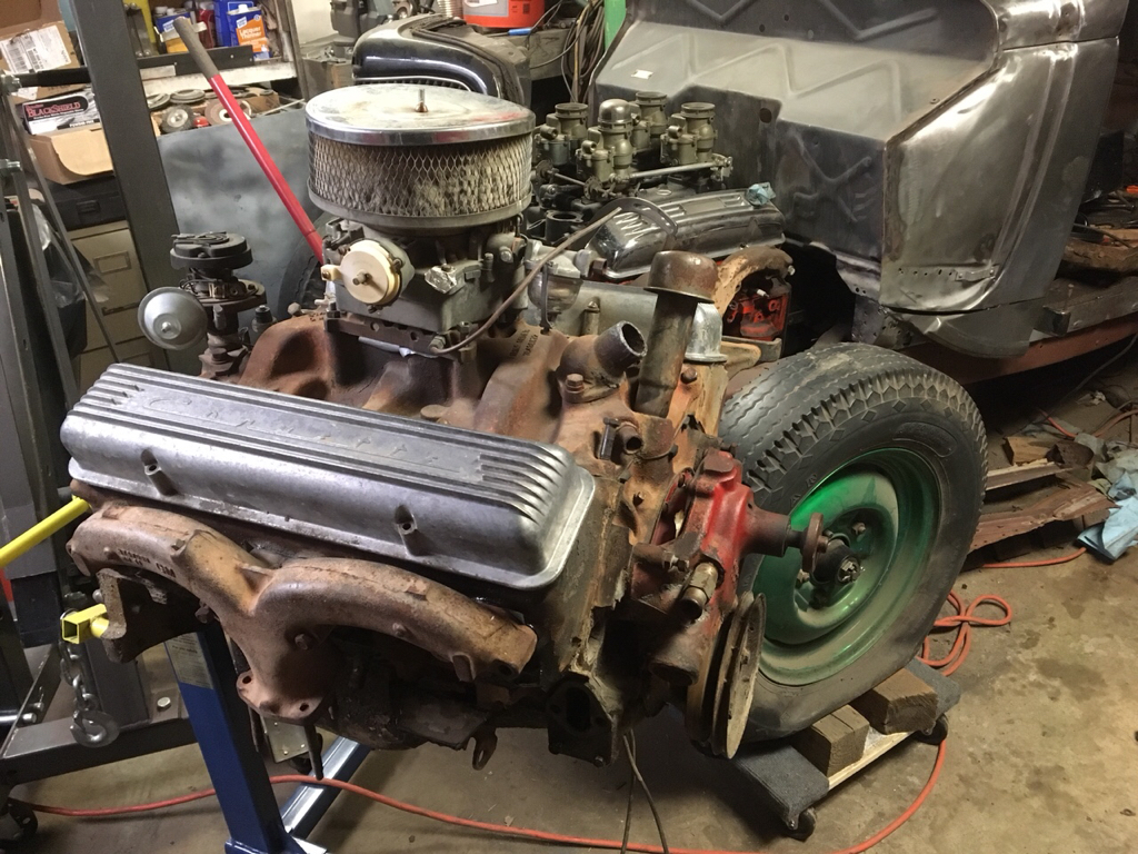

    So I need to quit buying engines and commit to a plan. I'm putting a 283 in my '35 Ford 3 window backed by a T10 4speed and a 9" with a TrueTrac. I haven't ordered gears yet but I'm thinking 4.11 or 4.56. 16x7.00 in the rear. I want the motor to look early, no 305 heads, vortecs, etc.
    I have the following items/parts
    -A mid 60's 283 with 520 heads, supposed to be .030 over with valve trouble. It's my mock up motor, have not opened it.
    -A '59 283, 519 block, 549 heads, staggered bolt valve covers. .040 over, might need a bore, valves sunken. It was a 185 horse motor that someone put a 4 barrel and a solid lifter cam in.
    -Another 519 block 283 bored to 301, pistons stuck. Who knows about bore pitting...
    -A 327 with 461 camel humps. .060 over and sunken .194s
    -A couple of 350s, not using them for this car.
    -A four deuce Offy with 4 Holley 94s.
    -Another set of 520 powerpacks on a 327 in another car that runs. They were rebuilt for unleaded in the 90's. I'd probably have to rebuild the camel humps and swap them over to get these heads for this project.
    The intake and the staggered bolt 'Vette valve covers look so right that they are giving me direction.
    Are the low compression 549 heads worth messing with? Changing to .184 intakes and using domed pistons? 58/59 heads have the unique bosses on the ends for air ride that are kinda cool plus the staggered bolt pattern for my valve covers. I don't want to pay an arm and a leg and fight 'Vette guys for the same vintage power pack heads.... Could I braze a boss on my later 520 heads for the early valve cover bolts?
    What kind of compression can I run on 91 octane?
    I want a 292 or a 301 with early heads and a solid lifter cam. Any thoughts?

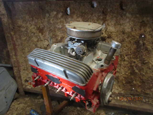

  11. ngines 007.JPG Pictured is a 69 327. I freshened up a bone stock short block, just new rings and bearings. A 30-30 cam and a set of extensively reworked 57 heads. old Edelbrock C4B intake. I used those heads because they where on the very first 55 chevy I owned. And I also wanted to use the stagger bolt finned valve covers I had bought new back in the day. I also have a stock two four intake and a set of corvette valve covers I could useon it. Back in the day I ran a lot of 292's (a .060 over 283) usually with a 411 rear gear. I often used the 350 _350 Hp hydraulic cam in them. A shorter stroke engine with a 350 cam the cam has more effective duration.

    What’s been done to those heads?
  13. CCed 60 cc on all chambers. port matched and ported. larger intake valves . three angle valve job. They came on the first 55 I ever owned. It was a 265 bored to a stock 283. Flat top pistons without any valve reliefs. Solid lifter cam. Topped by a cast iron 300 hp 327 intake and carter AFB carb. Had the larger 300 hp Ram log manifolds and 2&1/2 exhaust run thru glass packs. Tracton bars and 370 rear gears . stock three speed with floor shift. I blew a piston nothing but the bent rod and piston pin in the destroyed cyl.
