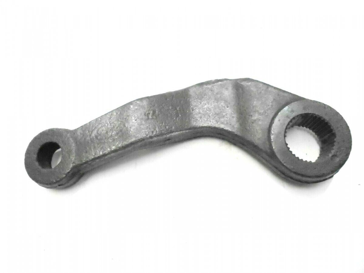

    I'm looking for help in finding options for the pitman arm on a '67 Mustang steering box. I've searched (seemingly) everywhere with no luck. The issue with the arm I currently have, is that the taper is in the opposite direction from what I need. The arm I have looks like this:
    But I need the tie rod end to be attached in the other direction. Something like this:
    Worst case, I'll cut my current arm, flip it and find a pro welder to put it back together. Any help/advice would be great! - Thanks.

    If you are going to use the current arm in it's current orientation and only want the drag link to connect from the outside, it looks like that arm is plenty thick enough to ream half way from the outside with a 7 degree reamer and install the drag link.

    Sorry... I just used that picture to illustrate the mounting direction of the tie rod end. I need it to be inserted from the outside in rather than from the inside out.

    Taper ream as said above or drill out and use a heim end

    Taper ream the small end.

    I bought a 7 degree tapered reamer from Speedway Motors a couple decades ago. I have used it on countless pitman arms and spindle arms to ream them half way from the other side to flip the tie rod or drag link. Just clamp the arm to your drill press platen and sneak up on the taper. Keep measuring as it's hard to put the steel back if you take too much.

    Again, I appreciate all of the replies. Looks like I need to buy a reamer. Just to complete some the story from the other replies, The box is 1-1/8" output shaft & (luckily) it turns correctly.
