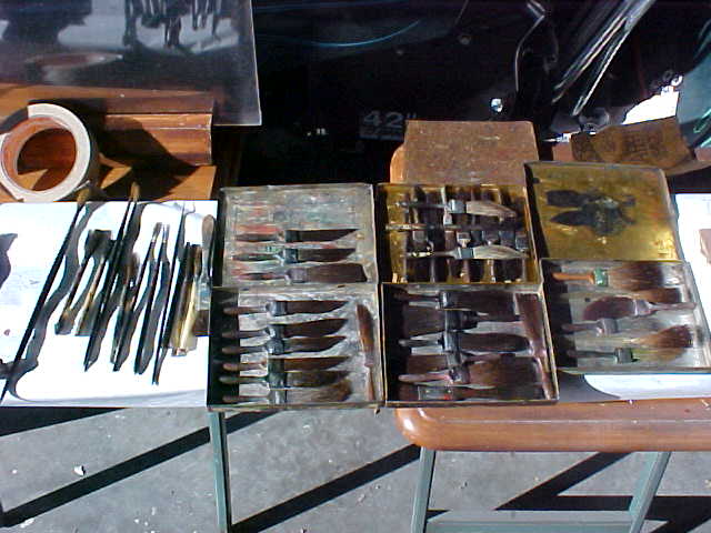

I recently acquired some striping brushes that are about 80 years old and after a good cleaning(they were used mostly with striping lacquers)they still pull some incredible lines.I tried several of the #3's and #4's and could do anything from a near hair line to about 5/16" just by varying the pressure on the brush.They're not much good for designs(if you push them a bit they will)but are unbeatable for straight lines(which is my main business). Some pics of the brushes and the lines they will pull.
