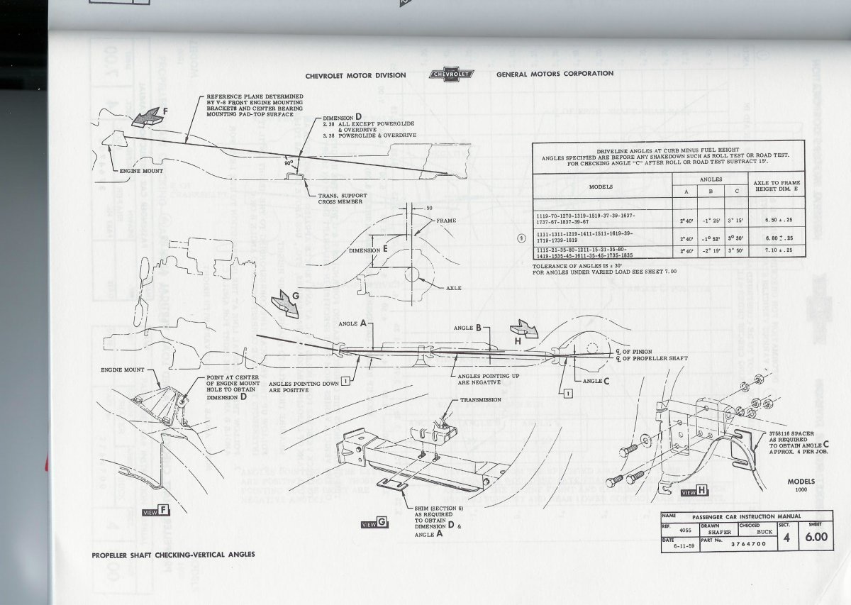

    A lot of very confident statements about the trans and rear angles having to be parallel. That is a valid design but not the only one. Go look at the angles and shaft designs used in the 58-64 Chevys. They made a few of them and nothing is parallel. I can post from the shop manual.
    Having the working angles the same is the real goal. Often due to the rotation of the rear end about a point beween the u-joints, having the rear end point down is better. It reduces the angle change between the joints with rear end movement. Most production vehicles use this design.

    The reason the diff should be dropped 2.5 to 3 degrees,
    Montana1 likes this.
