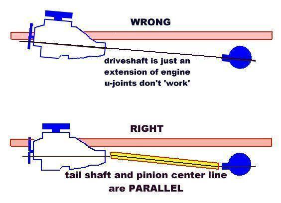

  1. almost got this 48 truck ready to roll, thanks for all help. Now to set pinion angle this is what I have tranny down 2 deg shaft at 5 down and diff at 15 up ,, I guess I want to end up with 1 deg

  3. so this meens that the rear diff hast to be 2 deg up

    Nope, down 2 degree........

  5. ok I will move again put load on wheels and try again

    Thanks for the diagram, Choptop. Getting ready to install a 302 and AOD with a ranger rear end in my 54 Ranch Wagon and this makes things pretty straight forward.

    Diff 2 deg UP

    You really must be very careful with terminology when discussing trans and pinion angles. I know the old trans down 3*, pinion up 3* deal has been around forever, but it is really misleading for someone not familiar with what's going on here. A lot of confusion is caused by this. I think this might very well be the leading question on the HAMB.
    Let's define negative slope as sloping down from front to rear. Positive slope as up from front to rear. Now that old saying becomes "trans down 3*, pinion down 3*", which more clearly explains the desirable, parallel condition. Then the math works to come up with your u joint working angles. It's too bad that old saying ever got started that way.

    No it forget up down. That nonsense always throws guys off and screws things up.
    As the diagram that choptop40 showed shows the pinion will be on the same parallel plane as the crankshaft and output shaft of the engine an trans.
    _____________________________engine/trans
    Pinion angle _______________________________ The driveshaft will angle down slightly from the trans in most cases and slightly up from the pinion in most cases causing the pinion to appear to be angled down. Both U joint angles should end up being the same.

    Think of it this way: If the car were perfectly level AND the transmission were perfectly level, AND the rear pinion of the rear end were perfectly level (as in the lower diagram) everything would be correct The reason it would be correct is because the pinion is mounted lower than the transmission . That means they operating in parallel planes at different heights from the ground. This allows the U joints to work as they rotate.
    In the normal scheme of things most engines are not parallel to the ground (level) but actually are lower at the rear. Most commonly accepted angle is appx 3 degrees downward. In order to get the Pinion to stay in a "parallel plane", it must be rotated upward 3 degrees.......The result of that move "must not" result in something like the upper diagram. The pinion still needs to be lower than the transmission.
    At this point you have what would be considered as the "best operating condition" when driving.
    Things are not as they seem though, because the torque of your engine will cause your springs to slightly wrap upward and increase the pinion angle beyond the desired 3 degrees. So you may end up with a pinion angle of 5,6,7 degrees. To combat that, you actually want to set the pinion only at maybe 1 degree when stationary with vehicle weight on springs. Then as you drive the springs will wrap and you get the actual 3 degrees you desire.
    Thanks to Choptop40 for the diagram.

  24. Parallel.

    The torque of the engine really only comes in to play when the car is launching off the line and for a street car the amount of spring wind up is negligible. And that deal only applies to parallel leaf spring cars not those with ladder bars or any sort of four link. The aim is to have the angles correct with the car as it is driving down the road as that is hopefully the most constant condition. Everything else is transitional for short periods of time. Any sort of suspension displacement (bumps, hard launches, heavy braking) will change the pinion angle with most common forms of rear end location with an equal length parallel four bar providing the least variation.
    And the pinion does not need to be lower than the transmission as the driveshaft does not care whether it is running up hill or down from the transmission output as long as the angles are correct.
