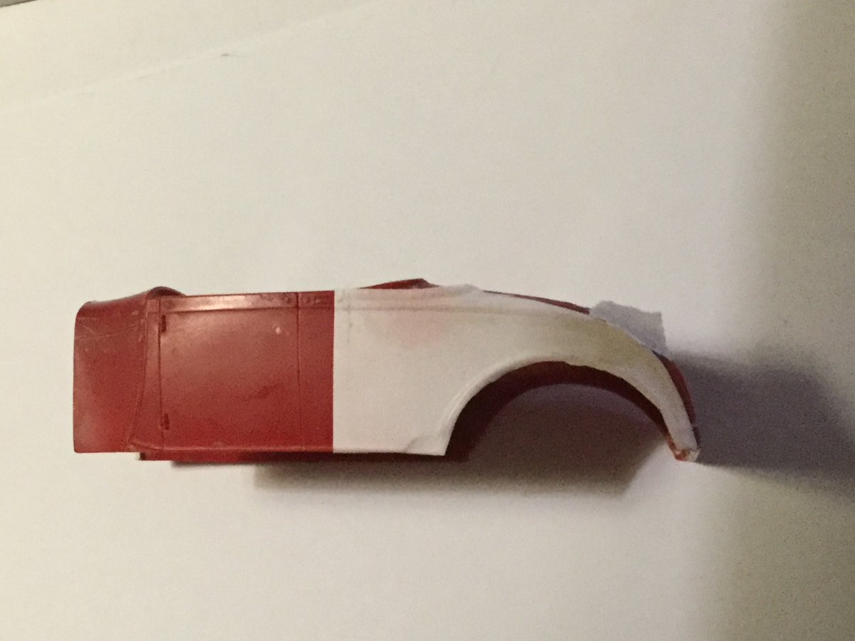

    The paper imprint next the the Roadster body was taken from the coupe quarter panel.

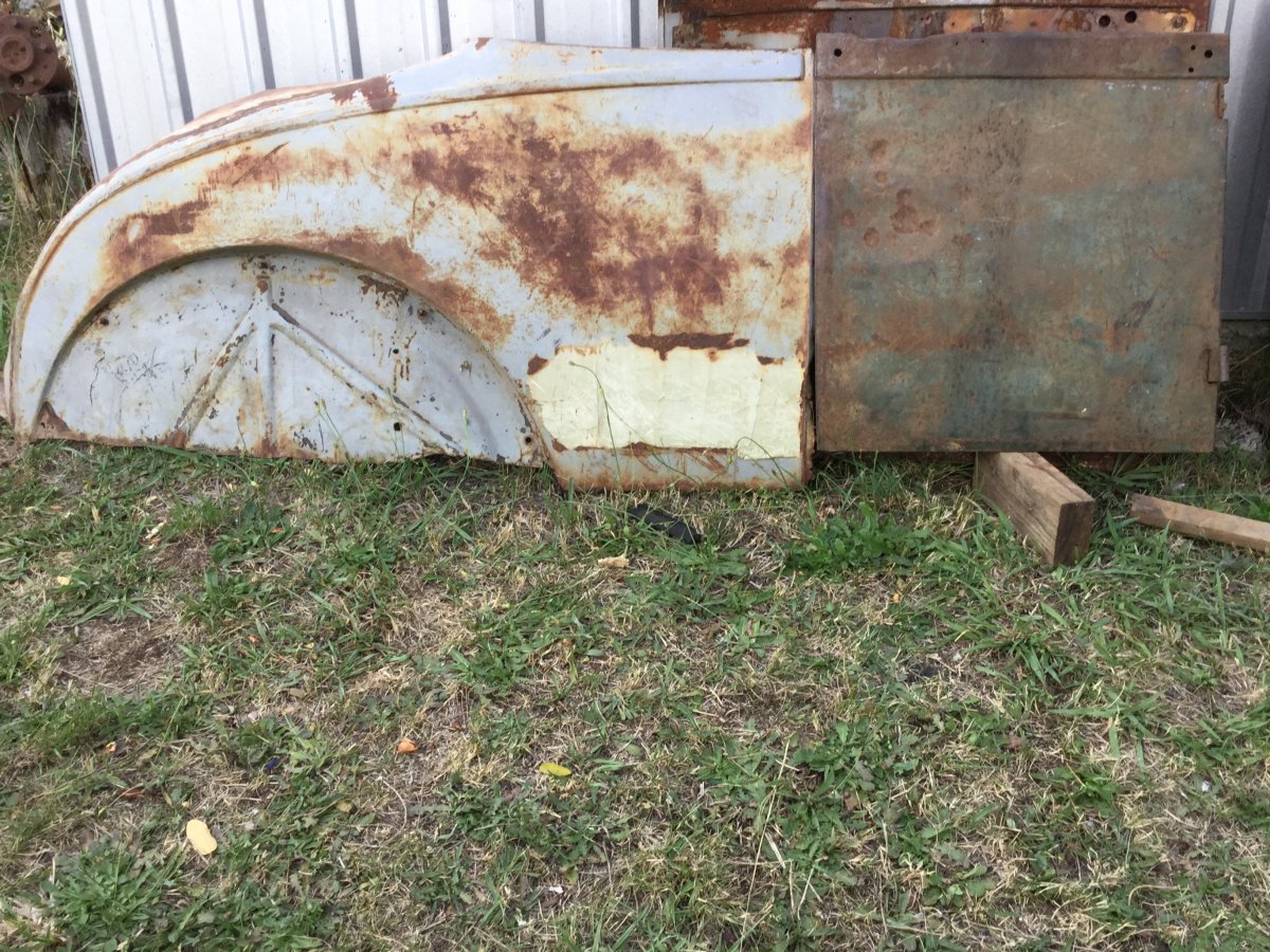

  5. chev34ute
    Joined: Nov 13, 2011
    Posts: 762
    chev34ute
    image.jpg Now stuck on, with bottom folded under.
    fourspd2quad likes this.
  6. chev34ute
    Posts: 762
    chev34ute
    I know there are many variables when working with a model, but it’s more accurate trying to draw it up. Here are the advantages with this theory.
    By chanelling the quarter panel down to line up with the Roadster beltline, I do not have to do any cutting at all. The lower wheel arch means that what ever rear end goes into it can run at stock height saving time on stepping the frame.
    I said at the begging of the thread that I was piecing together something together to sell of. I gave up on the idea of a coupe because the coupe doors and cowl are damaged. I also decided against doing a Roadster Pickup because of the difficulty in a making an accurate looking bed.
    In the end, the coupster idea, made the most sense and rather than cut up the quarters to suit the doors it made more sense to make the doors to suit the quarters. In the end this will still be a pile of parts only this time it will more closely resemble a Roadster.
    Tomorrow I will finish off the doors a start modifying the quarter panels to sit lower over the subrails.

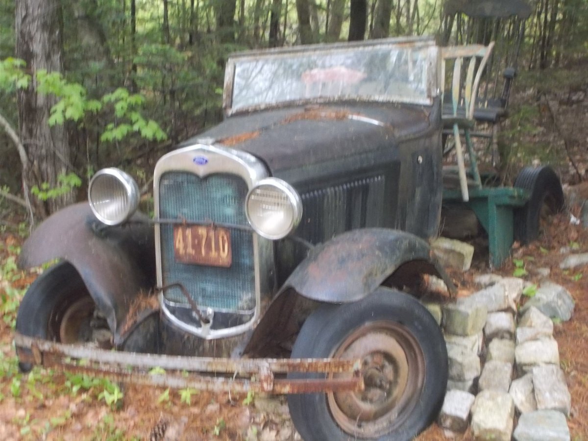

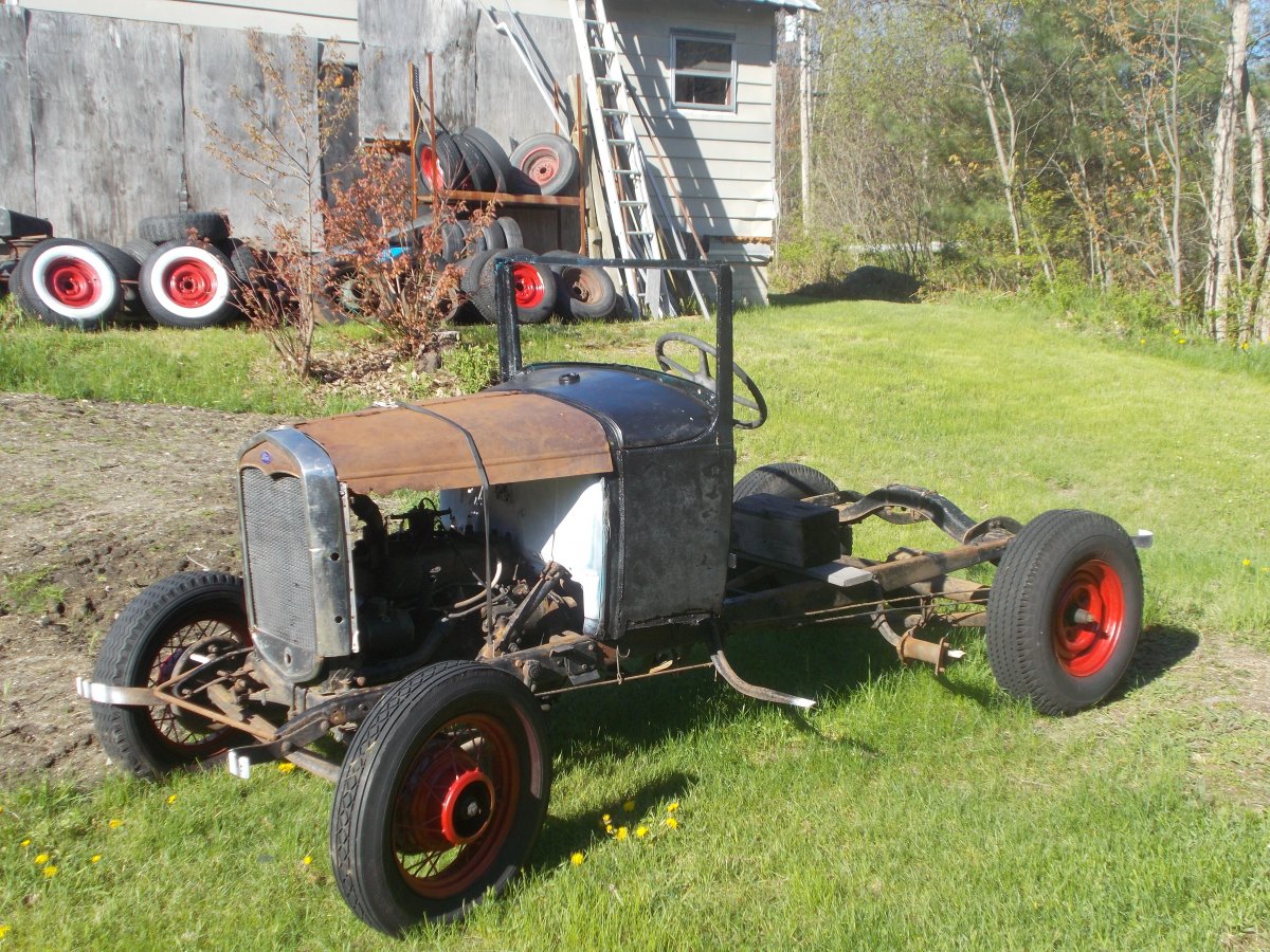

  8. sloppy jalopies
    Joined: Jun 29, 2015
    Posts: 3,358
    sloppy jalopies
    chev34ute and Nailhead A-V8 like this.

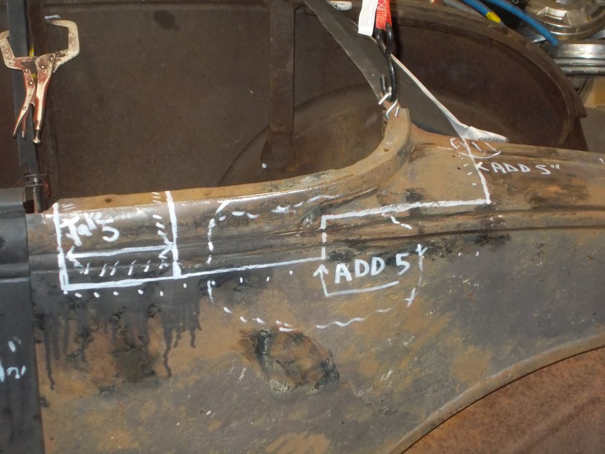

  9. Nailhead A-V8
    Joined: Jun 11, 2012
    Posts: 832
    Nailhead A-V8
    following along with interest as I plan to to something similar ...you never mention them but your calculations don't seem include adding the extra body bead (belting, reveal etc.) to the top of the coupe 1/4s and above trunk (boot) panel (tulip) nor the body bead that runs the length of bottom...you'll have build that combing out of tubing or wide bead roller. On the sport coupe there was a metal strip that was nailed on around that area but they're usually long gone with the wood...one suggestion I was going to make before you nix the rdstr. doors... on a phaeton there is a small panel between the front and rear doors it will be pretty close to the distance you need and have all the right curvature/beads etc. be easy to ship but pretty easy to recreate too
    see under the doors? those are separate panels with scuff/step plates roll those beads into the bottom of the coupe parts to get the roadster look you want... and this is the center panel after that your roadster bead splits into two 1 around the cockpit (that you have to make) and 1 down the 1/4...

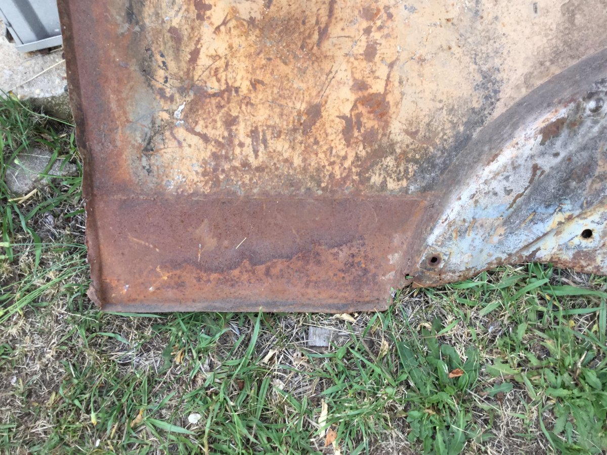

    CFD6734D-B189-4C88-B38B-8AAC7B7699A7.jpeg On the outside of the panel you will notice a whole pile of bondo that runs parallel to the bottom edge of the Roadster door. There is reason for that. Both sides had patch lanels butt welded in, leading to the distortion, hence the bondo. The patches are 5 1/2 inches tall, so when I remove them, the new ones will only be three inches tall, that will bring the quarter panels down into line with the Roadster doors.
  17. chev34ute
    Posts: 762
    chev34ute
    Maths is not my strong point, but that will be rectified before the new patch panels are made. To avoid any distortion on the new patch panels I am putting a one inch step in them so they over lap the quarter panels on the inside. Another thing I will do is put a one inch swage along the bottom of them so they look more like roadster ones.

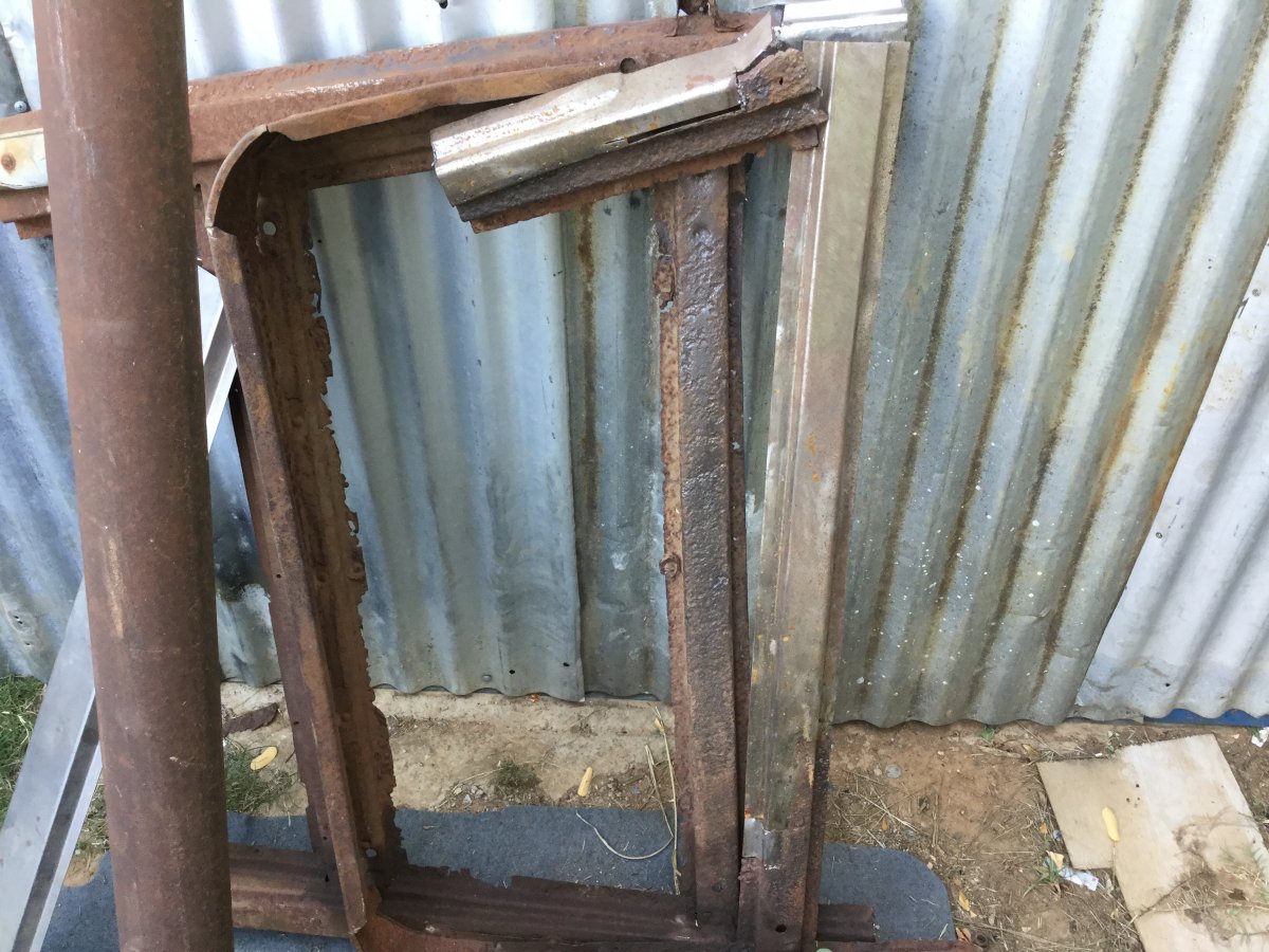

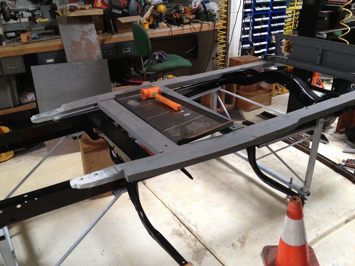

    The other obsticle has been working out sub rails, so I came up with a simple solution for this as well. The coupe subrails are too shot to use, so last year when I started working on my Couprielet body. I made hammer forms out of double thick one inch ply slabs. They worked a treat but I decided on sourcing genuine ones in the end after giving up on hammer firmed ones and trying to repair the original ones. I put them away and dragged them back out today to be re purposed.
  24. chev34ute
    Posts: 762
    chev34ute
  25. chev34ute
    Posts: 762
    chev34ute
    image.jpg The shot subrails will become a jig to peice the ply ones together. I fabricated up a cross rail last year with my folder, that one will go where the front of the seat frame sits.

    If you don’t believe Model A Fords had wooden sub rails have a look at this. 15EB1BE1-CD44-4C53-AB66-12214DF93981.jpeg
    Nailhead A-V8 likes this.

    This was how the Briggs Cabriolet bodies were put together. I have studied the build up very closely so my sub rails will closely follow these ones.
