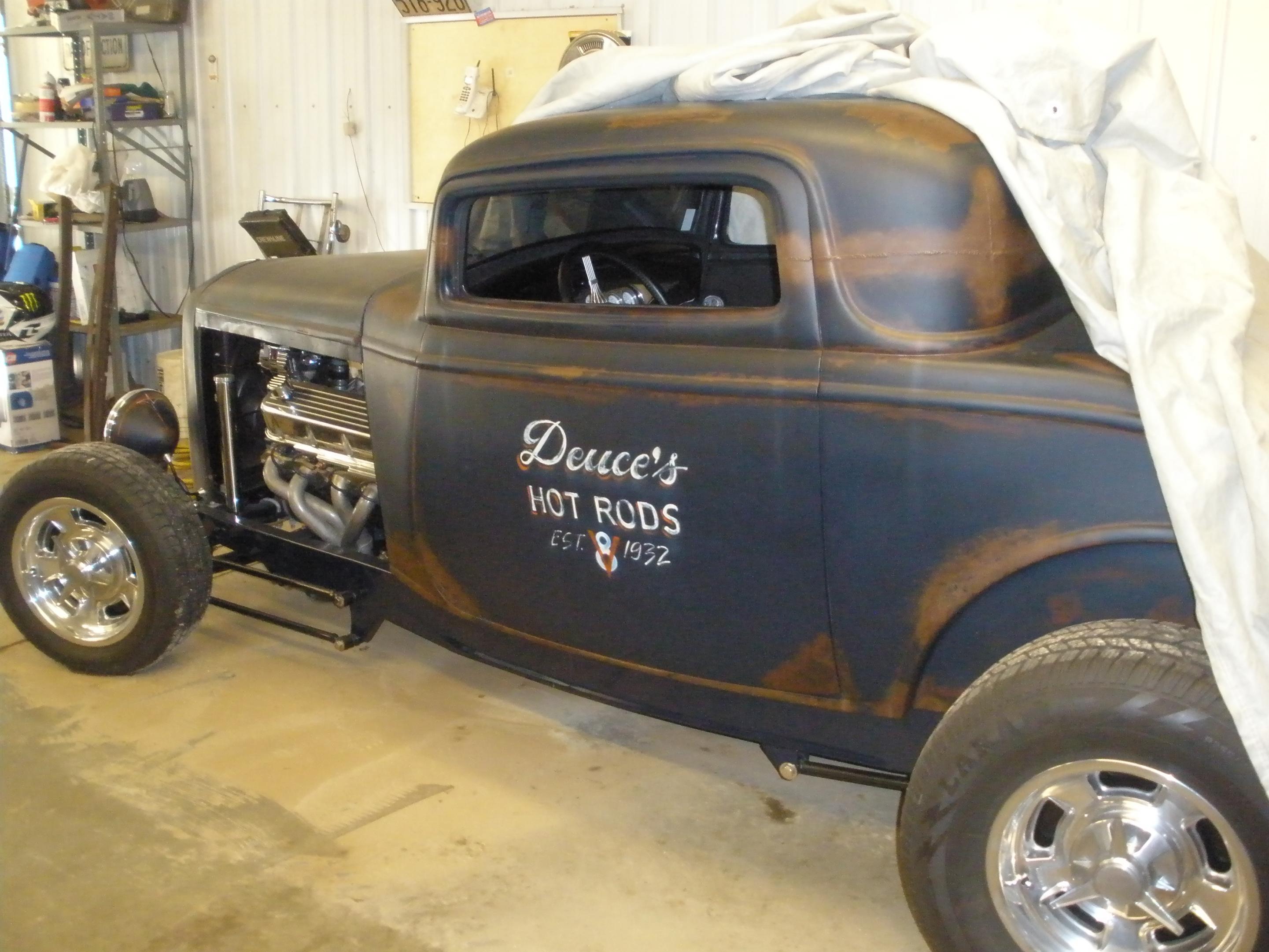

    this '32 is in Mukwonago, WI. Saw it yesterday when I picked up my '29 roadster from him. He has 2 more cool ones there too.

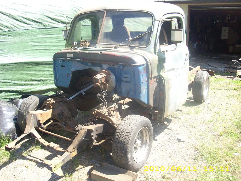

    here is the 1950 dodge truck l'm working on to try an get running before summer is over.
    the truck was supposdly going to be painted in 1993 by the owner, he never did. being already in primer when l bought it, l thought ''hey just squirt it and drive it''. WELL work and other things in my life got in the way of that idea. never did paint her and she sat in the shed for 12 years untouched and this is how it came out of storage.
    the question: does this count as ''REAL'' patina, fake since someone started to do body work and paint but never did and it sat untouched for a long time or neglected primer?
