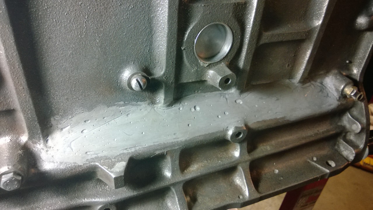

    A found a crack in my block. I looked into having it welded. I concluded that it's cheaper to go find another block from the same year and rebuild vs. trying to weld my block. If you try to weld a block the crack will spread. To avoid this you have to heat up the block. If you heat up the block you have to rebuild the engine when you are done and it's a bigger job vs. a normal engine rebuild. Or at least this is what some people say. End of story, I'm broke. Engine has fairly good compression. I didn't want to weld the block.
    I went to the HAMB forum and asked for advice. The forum suggested trying JB Weld. I talked to other people that had done this and it worked. I decided to go for it. I thought I should come back to this forum and outline the steps that I did to use JB Weld. The forum was nice enough to help me. I'll take the time to come back and post how it all went.

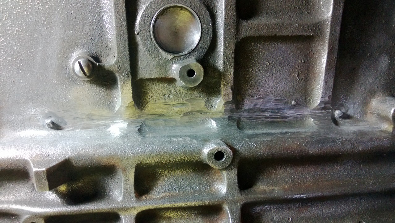

    To start, the crack is on the driver side near the oil pan. I think this is a common place where these blocks crack (when they do crack). I think this is along the water main. (so someone tells me).
    First thing I did was get the block real clean. Gas first and a wire bush. Next degreaser. Next a wire wheel on a hand held grinder.

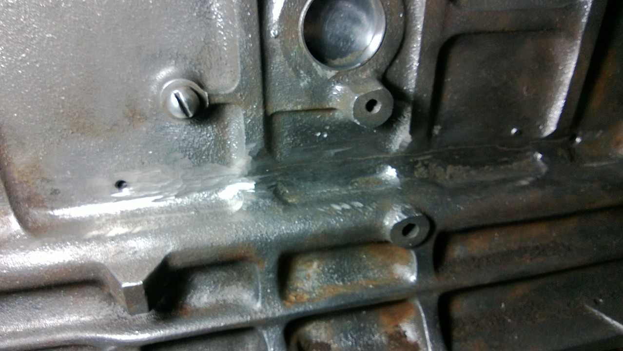

    Next step was to put a grinding wheel on my hand held grinder and grind down the area. I actually ground away some of the splines that run top to bottom down the side of the block. But only the portion of the spline where the crack was. (see pic) I came back with a wire brush and got the area very very clean.
    Next step was to take a torch and get the area real hot. This helped me see where the crack ended. In my case, because I ground the area semi smooth, when I heated up the block the crack got black and stood out.
    Next I drilled holes on either side of the crack so it wouldn't spread. Someone told me to do this. They told me that if I don't the crack could spread more later. I tried not to go all the way through the block with my drill. I used a hardened drill bit and cutting fluid. It cut through the block like butter. If you do this, be very careful. You would be surprised how fast the drill cuts through the block. (unless you already know better). Not sure what drill bit I used. Less then 1/4" for sure.

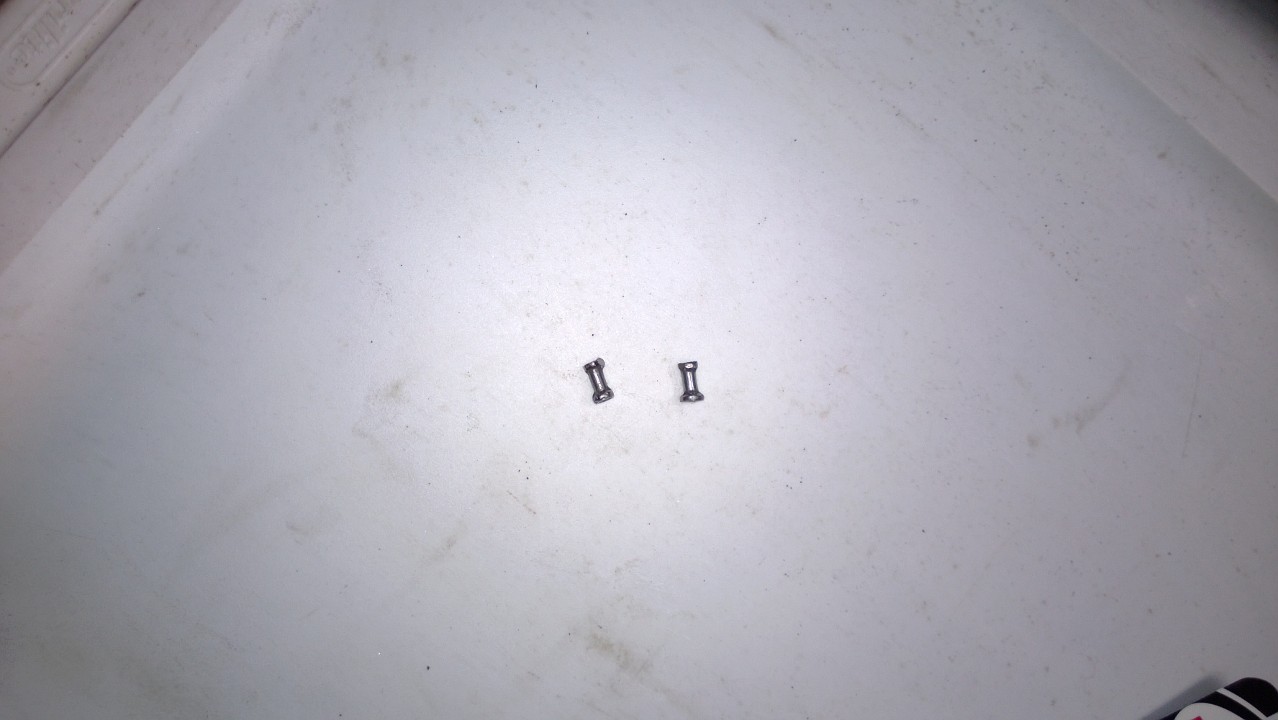

    Next I did something that in retrospect was probably pretty silly. I took a nail that had a double head (sort of) and I cut it down to make something like an anchor. I used JB weld to weld the anchor into the two holes I drilled in the block. I let the JB weld cure overnight. The end result sort of looked like I had hammered two nails into the block and left the head of the nails sticking out. But because there was essentially a nail head on both side you couldn't pry the nail head out without pulling all the JB weld out of the hole along with it. If that makes sense. Take a look at the pic and maybe it'll make sense. Not sure this was a good idea or not. After I did it seemed silly and seemed like overkill.

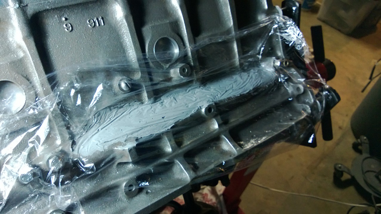

    Next I took two packages of JB weld and applied them over the crack. I laid the block on it's side so that the JB weld would stay in place. I put plastic wrap over the JB weld and made sure the JB weld was fairly flat but I was fine with the JB weld not being perfectly smooth. I let it sit overnight.
    Next I put another two packages of JB weld on the area. Again with the plastic wrap but this time I made a point to make the surface of the JB weld very smooth. I let it sit overnight.
    Next day I came back and I sanded down the JB weld.
    Next I painted the block with POR15 silver paint. I painted over the JB weld.
    Take a look at the pics to see what it looked like.
    We won't know how it turned out until I put the engine in the car and drive it for a few thousand miles. Wish me luck. :) If it fails there is a radiator sealer of some type that folks say works and I might try that. There is also another method but I won't try to explain it.
