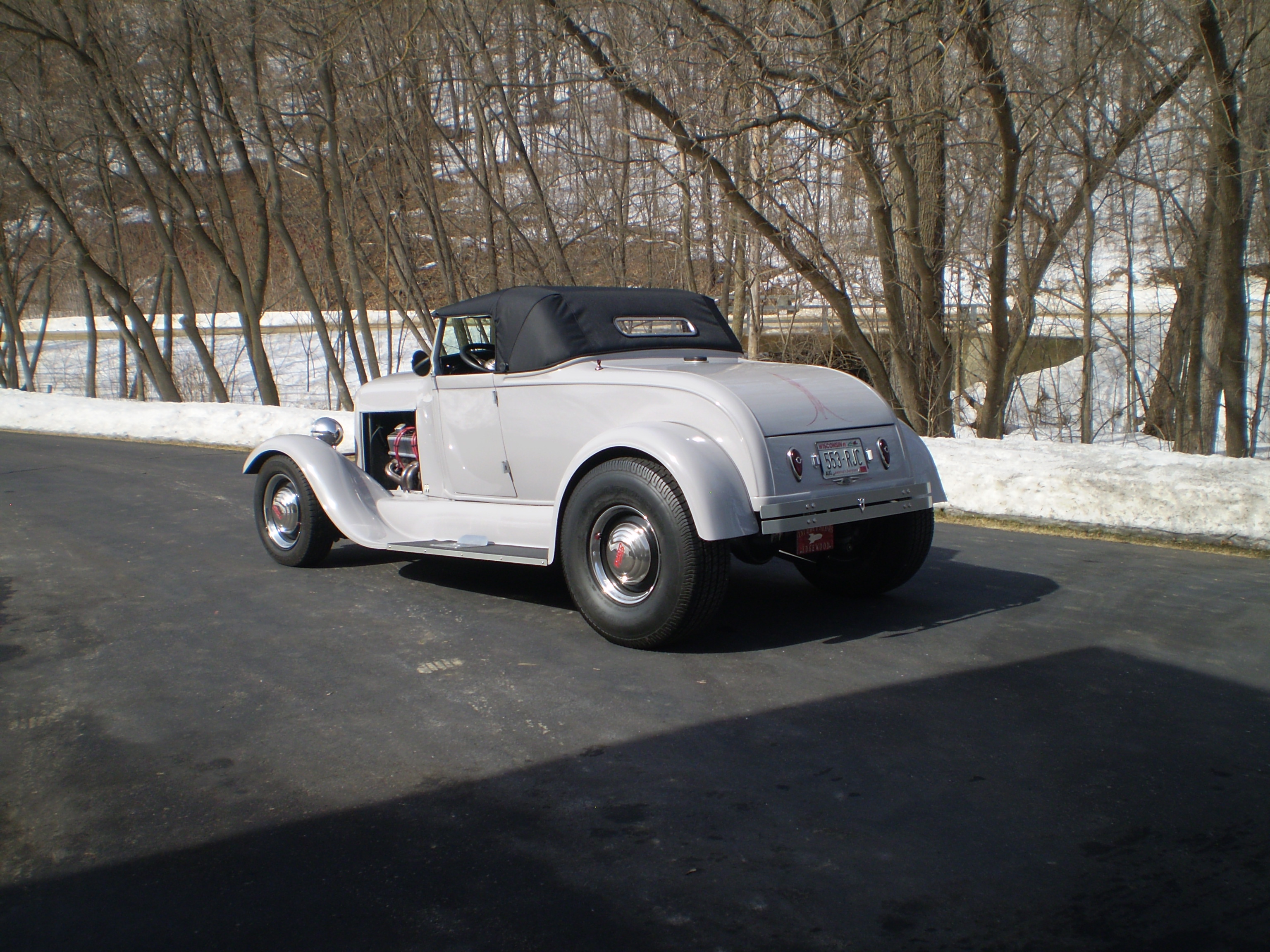

    Does anyone have any photo's and or tips on how to go about installing a Pete & Jake's BOLT ON front shock kit on a full fendered Model A? Should be easy right? Right?!? :eek: :confused: The rivets on the front crossmember look to be in the way of the bolt on brackets. The tech guy suggested that I weld the crossmember in and grind the rivets down. :mad: When I informed him welding the crossmember in wasn't an option and that I'm not working on a bare frame he suggested just sending the kit back. :rolleyes: Anyone out there in HAMB land installed one of these bolt on kits with the original rivets in place? Anyway, here's what I'm working on in case anyone cares:
