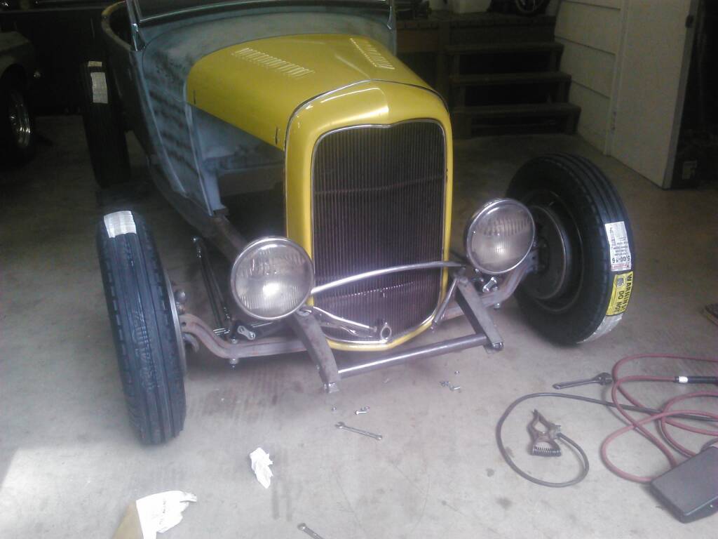

  6. Good idea, I asked Pete if he had pictures when we talked and he didn't think he had any. I've been picking at some things on the front suspension and gathering parts. Got a pair of original 32' perches with the shock ball cut off and took out the stainless street rod ones. Trying to use parts like they would have back then. I also picked up some original 33' commercial headlights. Not trying to build the car exact but a good representation of the pre Pete & Jakes era.

  10. Mocked up the cut down 32' headlight bar and the original 33' commercial headlights. Need to figure out the shocks.

    Look long and hard at the shell/hood sides. I believe the stock shell is sitting excessively high...
    ('29 cowl is lower than a '32, and the sweep of the rails makes the full length shell higher in profile than the body's natural spec. Didn't the car have a chopped shell when Vince had it?)

    I am pretty sure he has the same pieces as it had
    He just has it loosely assembled in the photo taken in his garage.
    I just hope he paints the thing something besides yellow but keeps the hood sides.
  19. I have the exact same shell, hood top, and sides with the car. It is just mocked up on the car for now. Still has the same pearl yellow paint.

    can you tell me about the all ford hairpins?
  22. The hairpins were made using a 32-34 wishbone yoke with a batwing bracket cut out and tig welded to fit the contour. When I got the car I thought Pete used early ford tie rods to make the actual hairpin but he told me he actually used 4130 chromemoly. If you look at a Pete & Jakes batwing you realize after looking that it evolved from an early ford wishbone yoke.
