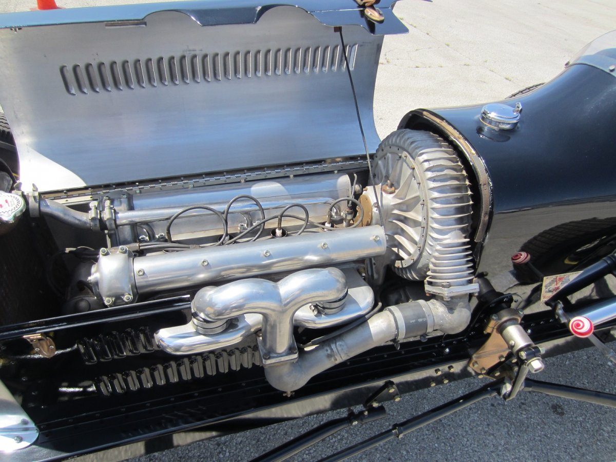

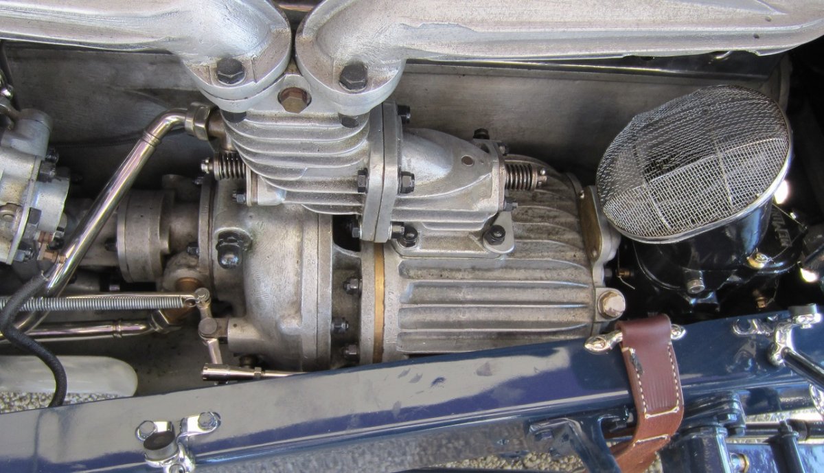

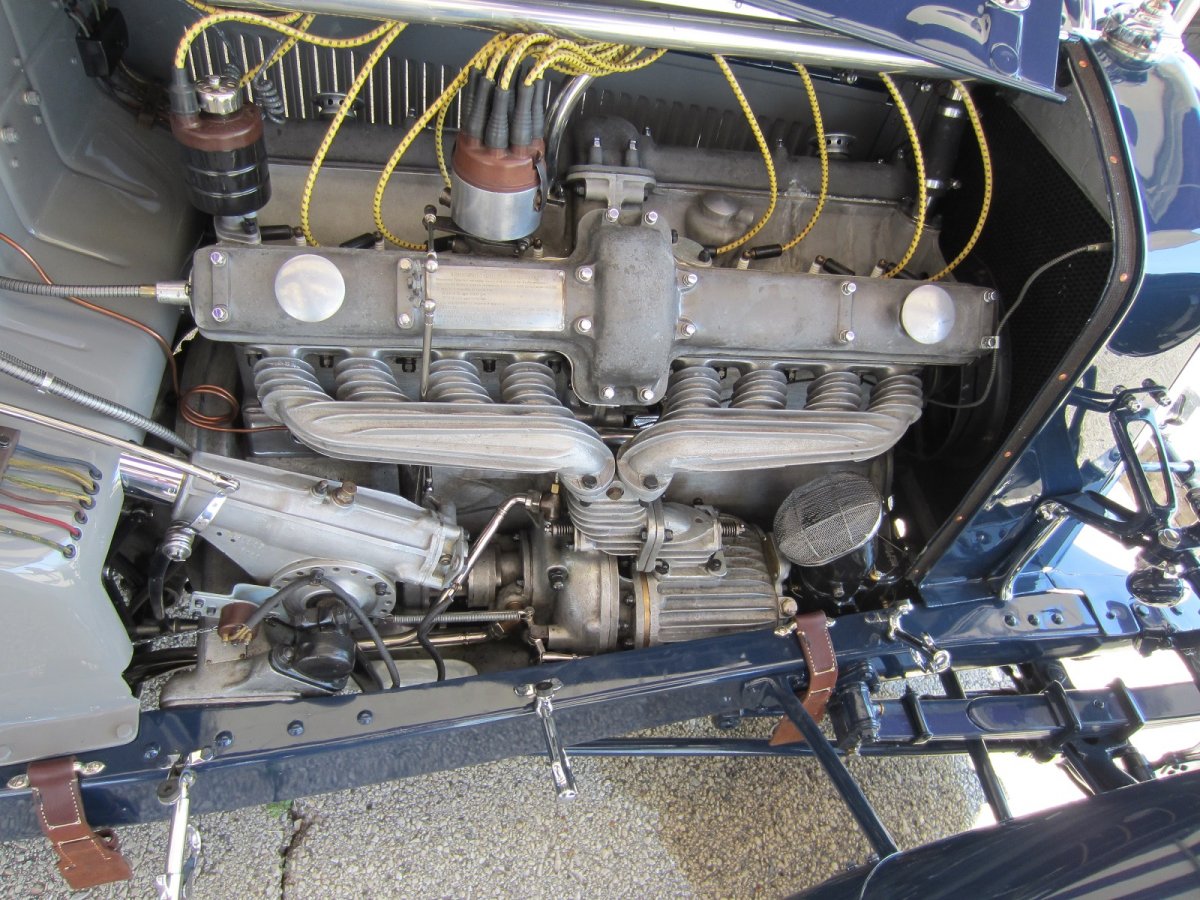

    Some more pictures of vintage superchargers;
    Alpha Romeo
    I think this is a Miller impeller,
