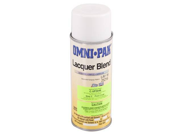

  9. rudestude
    Joined: Mar 23, 2016
    Posts: 3,048
    rudestude
