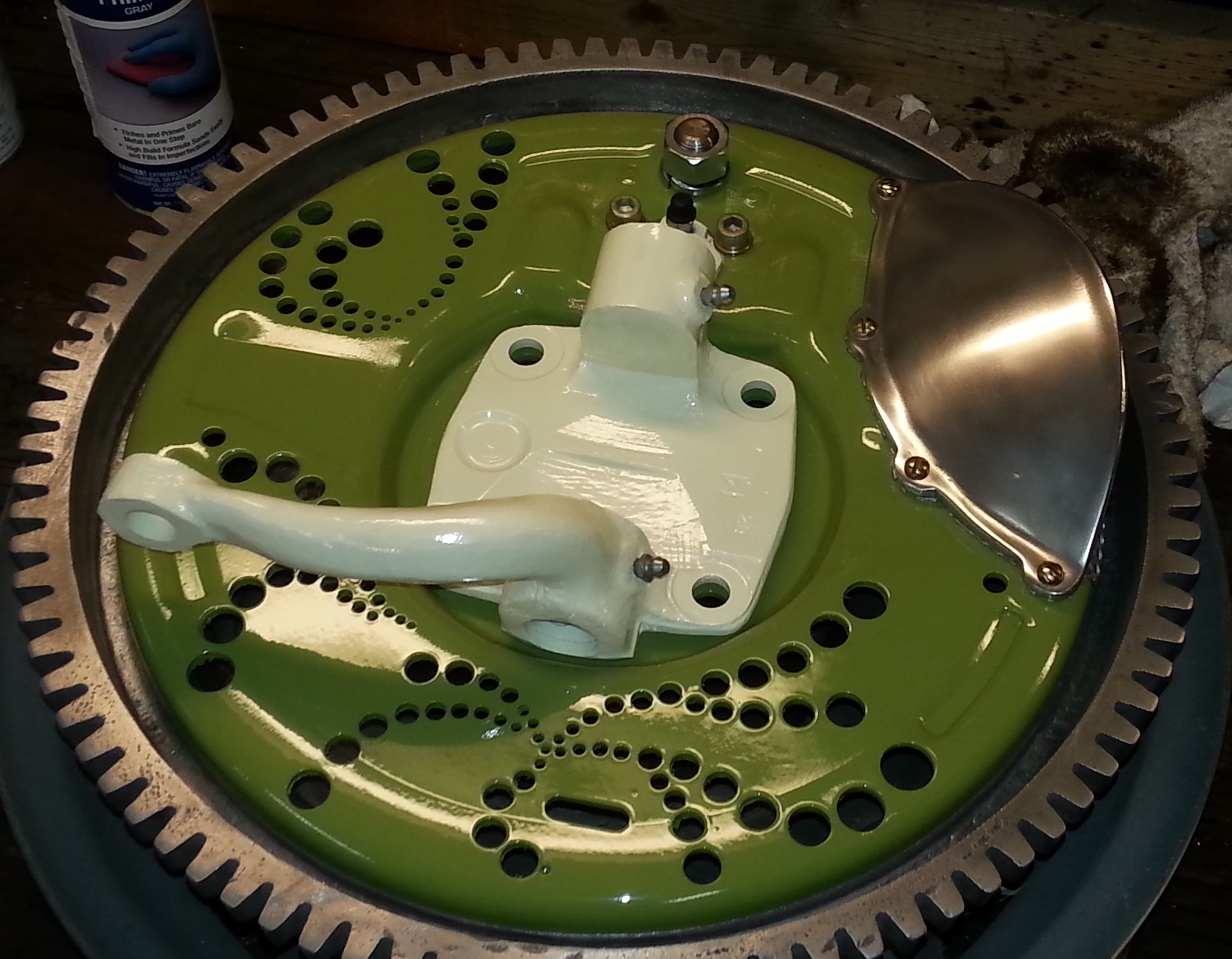

    here the backing plates I bought from Speedway,
    I thought for days, "how can I drill some kooling holes in a pattern I've not seen" my 16 year daughter came home from school wearing a dress with a "Paisley pattern" and I was inspired. plan to make some aluminum "scoops" for the upper forward area.....

    did a little hammering, cutting and filing on some 1/4" aluminum; still rough, plan to clean up and polish later
    Mikel50, volvobrynk and Hotrodmyk like this.

    Fenders or no fenders from the looks of your work you don't need anyone telling you how to build a car
  14. Yeah, that's for sure. Super job!

    besides paint and polish, the backing plates are finished.

    Great start, neat vent holes!
  17. Wow-how ! Fabrication man in the house. Man, those are some ornate drills. You also a pinstriper, or an engraver? Sweet flourishes there. This is going to be good....isn't it? Alright.......let's go !

    Slotted screws, I'm liking the attention to details on this build already. Bob

    wORK oF aRT!....Art Work!

    backing plates look great!

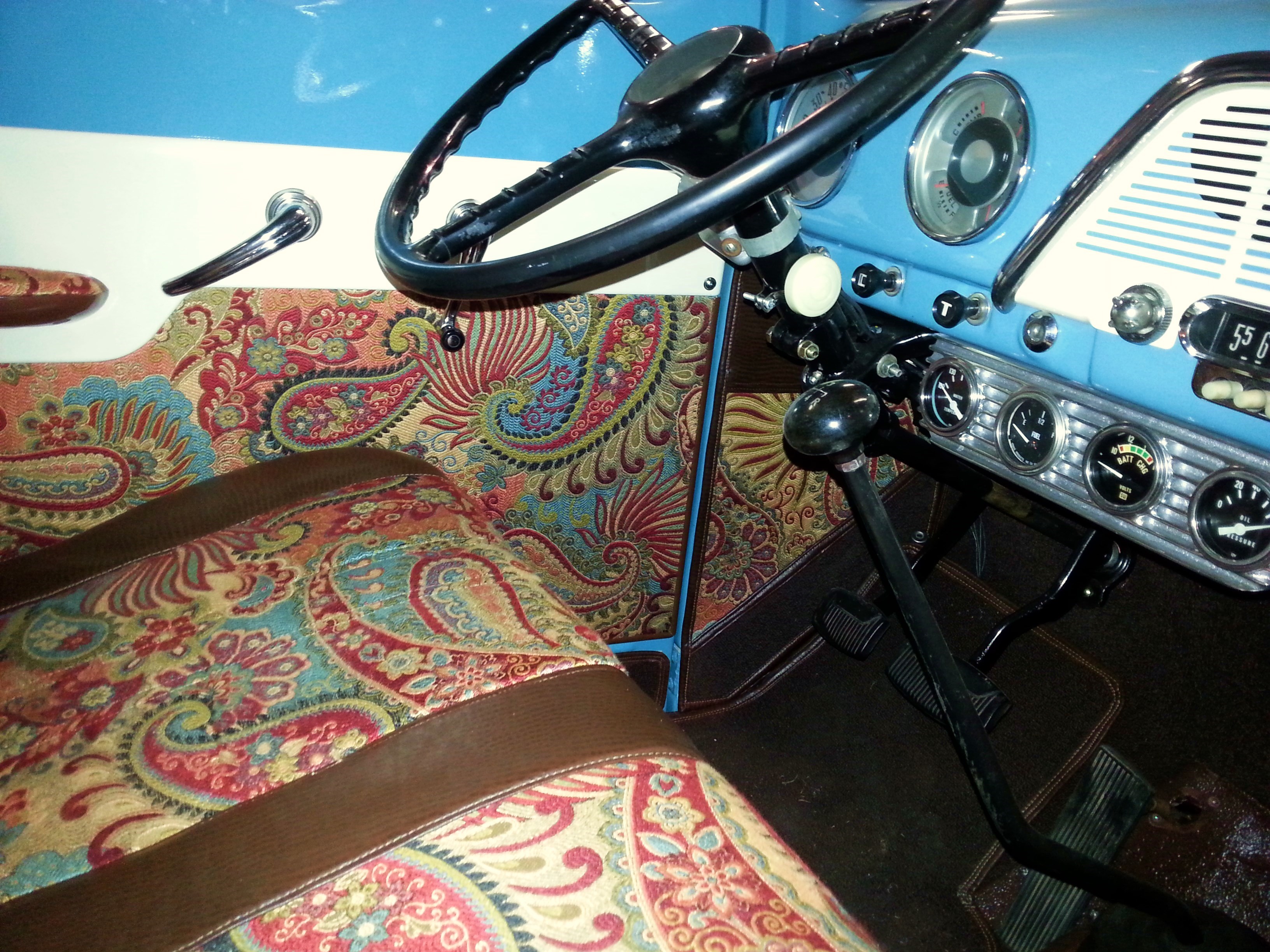

    No, but I do some interior work and am really into the paisley type patterns. (i have considered buying a "pinstriper starter kit" and messing around with it)
    Here's the interior of my 52 Ford;
    Mikel50 and bengeltiger like this.

    The backing plates are not for me. But your workmanship is outstanding. If I knew how to subscribe your threads I 'd sure do it.
  27. Cool. I can't remember the AMBR winner that actually won.....nor what year......but it had gunsmith engraving on the backing plates....chromed out. Reminds me of that car. Maybe a T or A roadster?? Oh well....yep, stripe kit could be fun to play with. Patience is the word.

    Backing plate update, mostly complete (might add a little dark brown pin-striping) or something.
