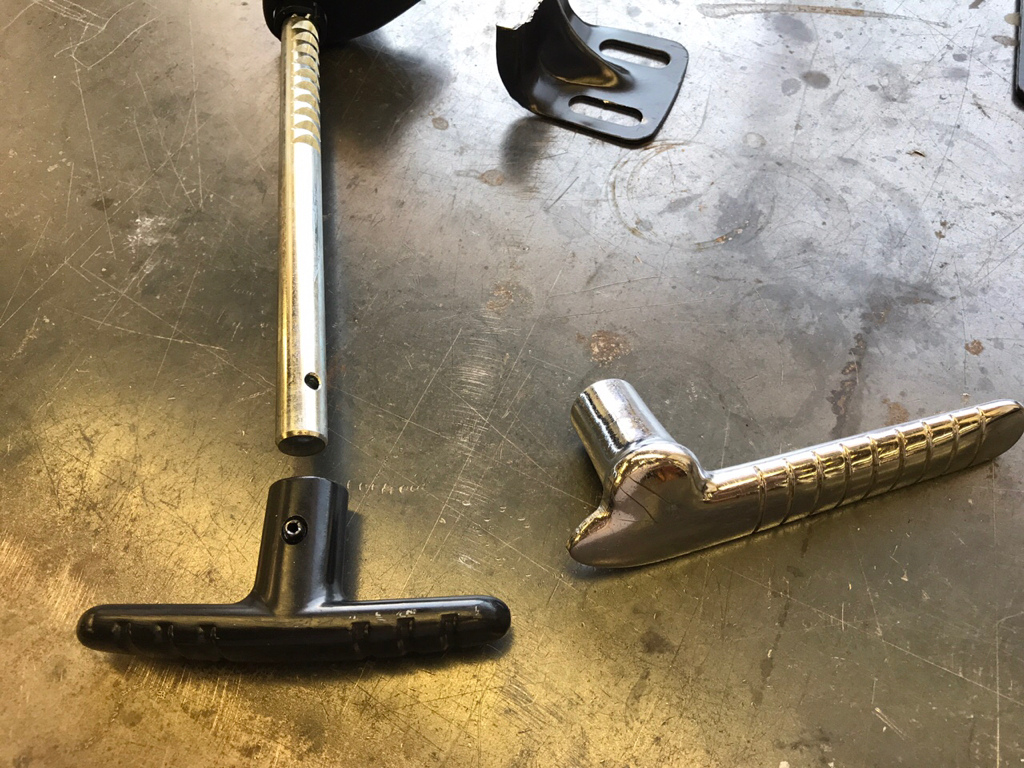

  6. HotRodWorks
    Joined: Dec 6, 2005
    Posts: 333
    HotRodWorks
    Alliance Vendor
    I couldn’t find a foot brake that I thought would work for me. I started with a 1955 Chevy parking brake mechanism and fabricated a firewall mount and modified the dash mount. I used the ‘51 Chevy handle on it. A cable attaches to the firewall and connects to the stock cross bar. [​IMG][​IMG][​IMG][​IMG]
