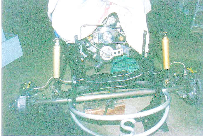

  16. Pete1
    Joined: Aug 23, 2004
    Posts: 2,255
    Pete1
    from Wa.
