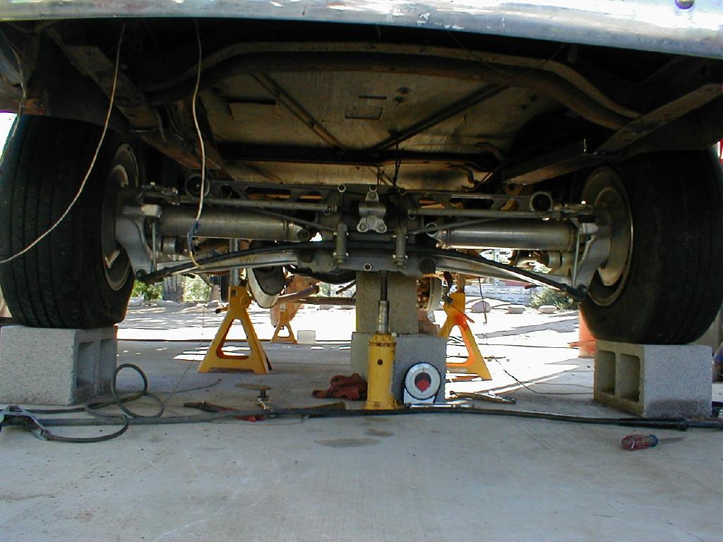

    You can always do what I did! :D

    Actually the one I pictured up above came out of my '55 1st GMC 1-ton because I replaced it with a GM 14-bolt with 3.42 gears and modern brakes. I'm hoping to find a rock-crawler guy who needs those gears.
